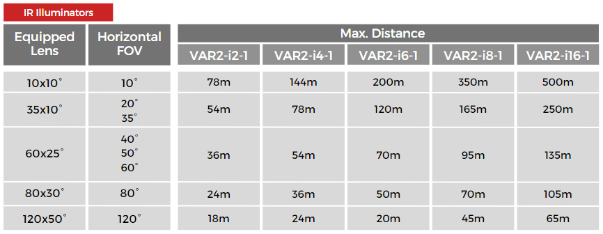

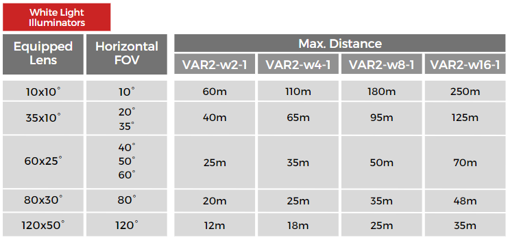

rayTEC's Vario2 lamps offer a variety of different illumination ranges based on their equipped lenses.
Below is a table listing the max. Illumination distance available for different VAR2 lamp models, equipped with different lenses / viewing angles.

Infa-Red (IR) Illuminators
VAR2-i2-1 - Short range IR Illuminator
VAR2-i4-1 - Medium range IR Illuminator
VAR2-i6-1 - Long range IR Illuminator
VAR2-i8-1 - Long range IR Illuminator
VAR2-i16-1 - Long range IR Illuminator
White Light Illuminators
VAR2-w2-1 - Short range White Light Illuminator
VAR2-PoE-w4-1 - Medium range White Light Illuminator
VAR2-PoE-w8-1 - Long range White Light Illuminator
VAR2-w16-1 - Long range White Light Illuminator
Infa-Red Illuminator Lenses
VAR-ix-LENS-8030 - Variants; VAR-i2-LENS-8030 / VAR-i4-LENS-8030 / VAR-i6-LENS-8030 / VAR-i8-LENS-8030 / VAR-i16-LENS-8030
VAR-ix-LENS-12050 - Variants; VAR-i2-LENS-12050 / VAR-i4-LENS-12050 / VAR-i6-LENS-12050 / VAR-i8-LENS-12050 / VAR-i16-LENS-12050
White Light Illuminator Lenses
VAR-wx-LENS-8030 - Variants; VAR-w2-LENS-8030 / VAR-w4-LENS-8030 / VAR-w8-LENS-8030 / VAR-w16-LENS-8030
VAR-wx-LENS-12050 - Variants; VAR-w2-LENS-12050 / VAR-w4-LENS-12050 / VAR-w8-LENS-12050 / VAR-w16-LENS-12050
