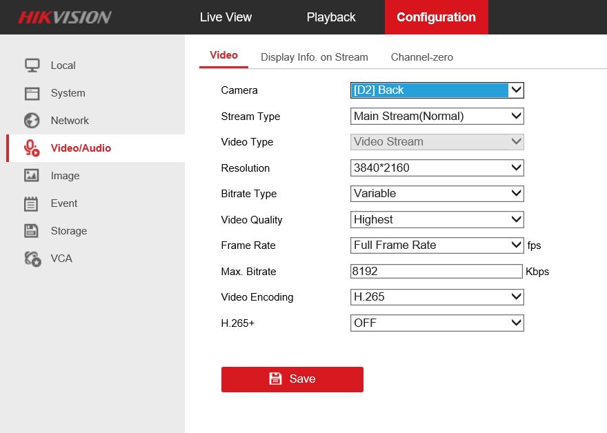

I have attached original settings from parameters page in record menu. Lines missing from this that are on dedicated monitor are: Bit Rate Mode -General and Max bit rate recommended 25411-42352kbps. Max I can set is 8192 otherwise I get error out of bandwidth.

Have you tried enabling h.265+?
The last field in your screenshot - set it to ON (and save the settings) - each camera will reboot after.
This is the most efficient CODEC (for bandwidth and storage).
Hikvision's h.265+ CODEC
Your other settings look fine.
