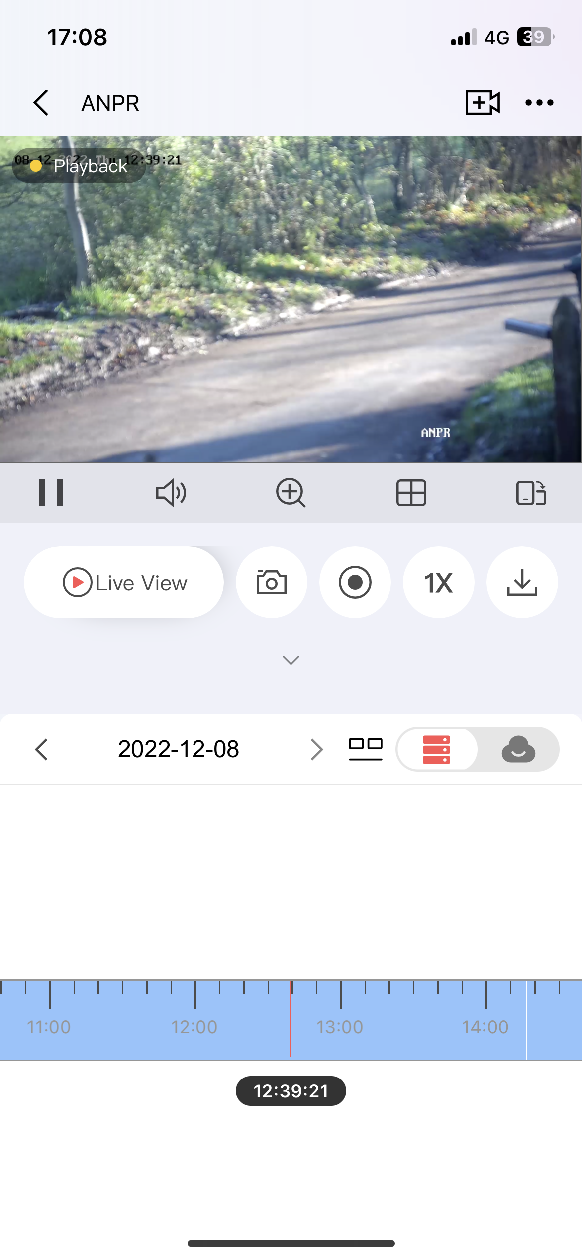

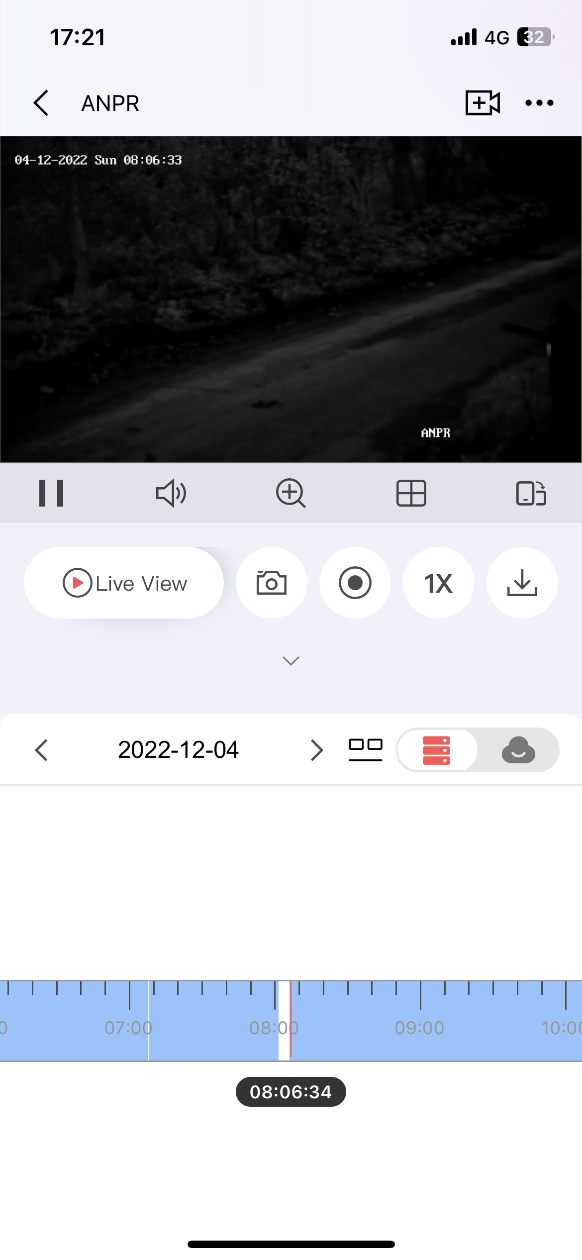

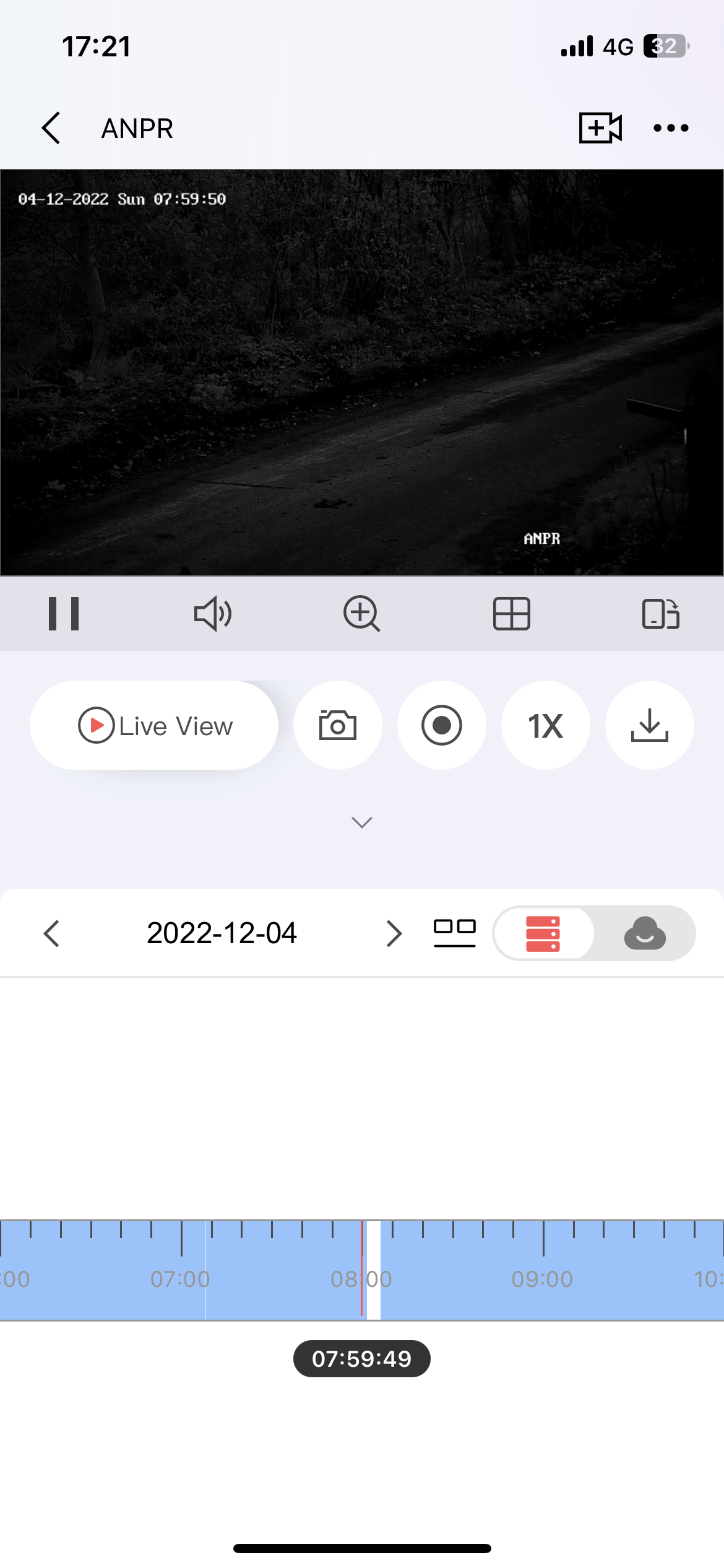

I’ve added some ANPR videos and stills. Also some footage from the so called smart cameras (acusense darkfighter and colorvu). Which are utter poo for producing notifications at night and barely miss a trick during the day.

Without making any changes the ANPOO has re focused itself and zoomed out resulting in a poor image.
So at 8am (with no power cuts) the whole system has gone down for a couple of mins. Upon rebooting its screwed up the ANPR image.

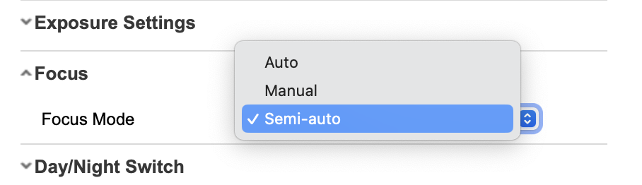

What do you have the 'focus mode' set to in the camera? I haven't used ANPR but I would probably set it to manual so that it cannot refocus automatically.

I have a fair bit of experience with Hikvision ANPR and I have found it best to only set the camera to auto-focus temporarily when setting it up (in daylight hours) so it focuses and then set it back to manual focus. If you keep it on auto or semi-auto you can get the issues you reported - e.g. if it boots up in darkness or it gets water or something on the lens it can set the focus wrong and it then seems to stay wrong.
I have not had any issues with the zoom level changing, only if using iVMS-4200 software the zoom level can be changed by a mouse wheel so it's very easy to nudge the mouse wheel without realising it and messing up your zoom.
