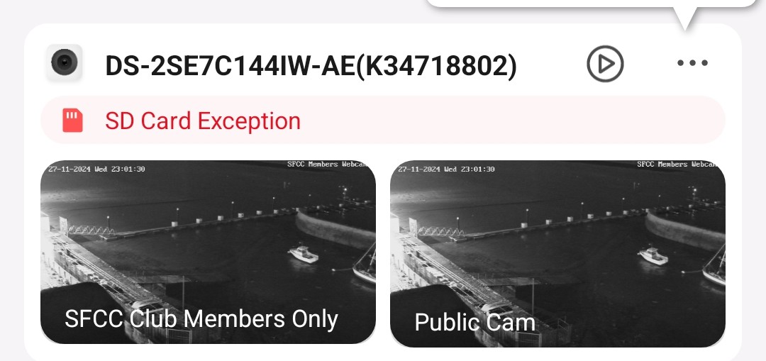

I am looking for a storage solution for my Hikvision model DS-2SE7C144IW-AE(32X/4)(S5) that we use as a webcam for our boating club.
The camera manual says it takes up to 256GB SD Card. Each SD card I try it doesn't even register there is one. It just says "SD Card Exception Error" I tried a lower capacity 128GB card but same response.
These cards are straight out of the packet unused.
Any ideas? What am I doing wrong?

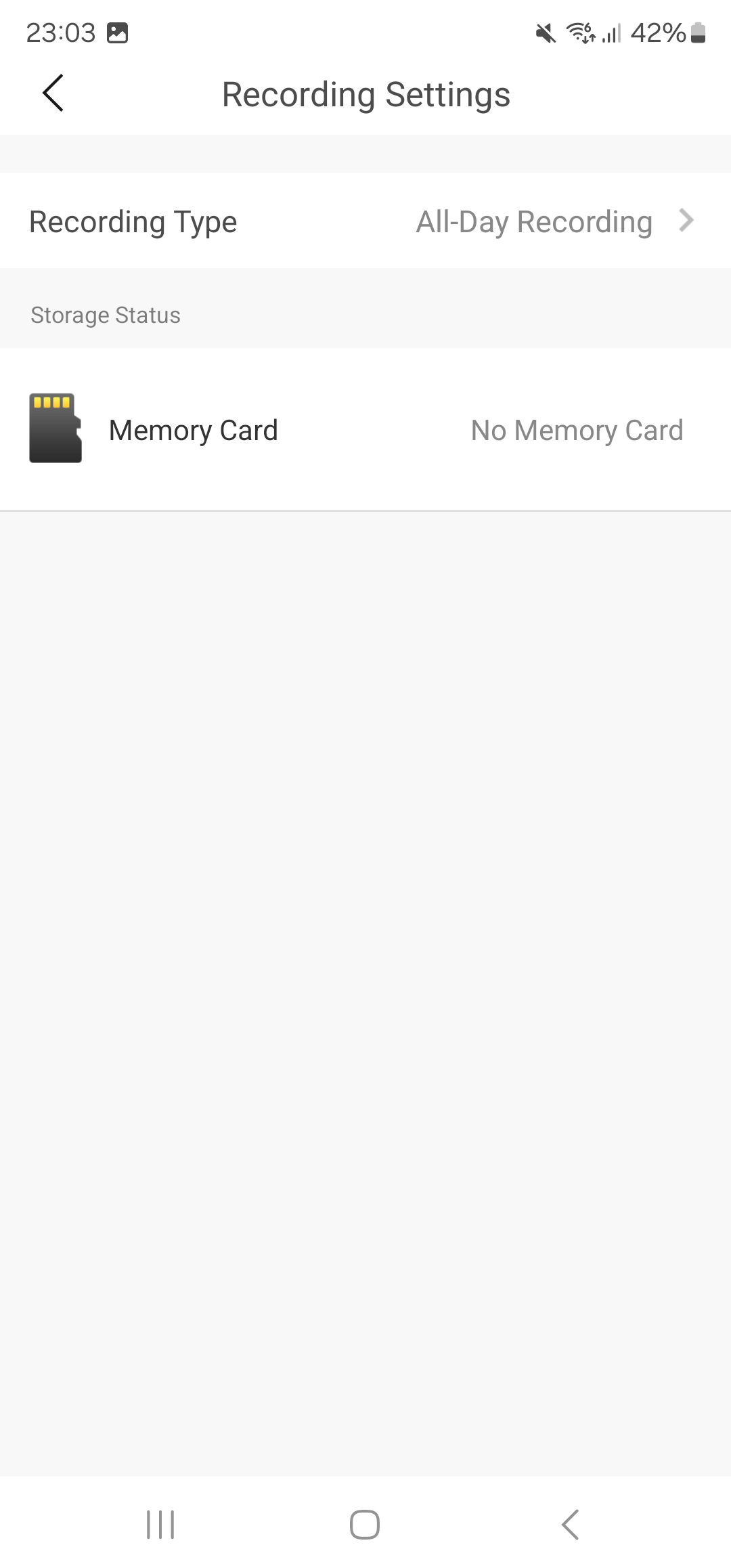

Hi Dan yes I can get to the camera fine. Via phone app or web browser.
It just doesn't detect the insertion of an SD card.

So you also can't see the MicroSD card in the camera's storage menu when accessed with a browser?

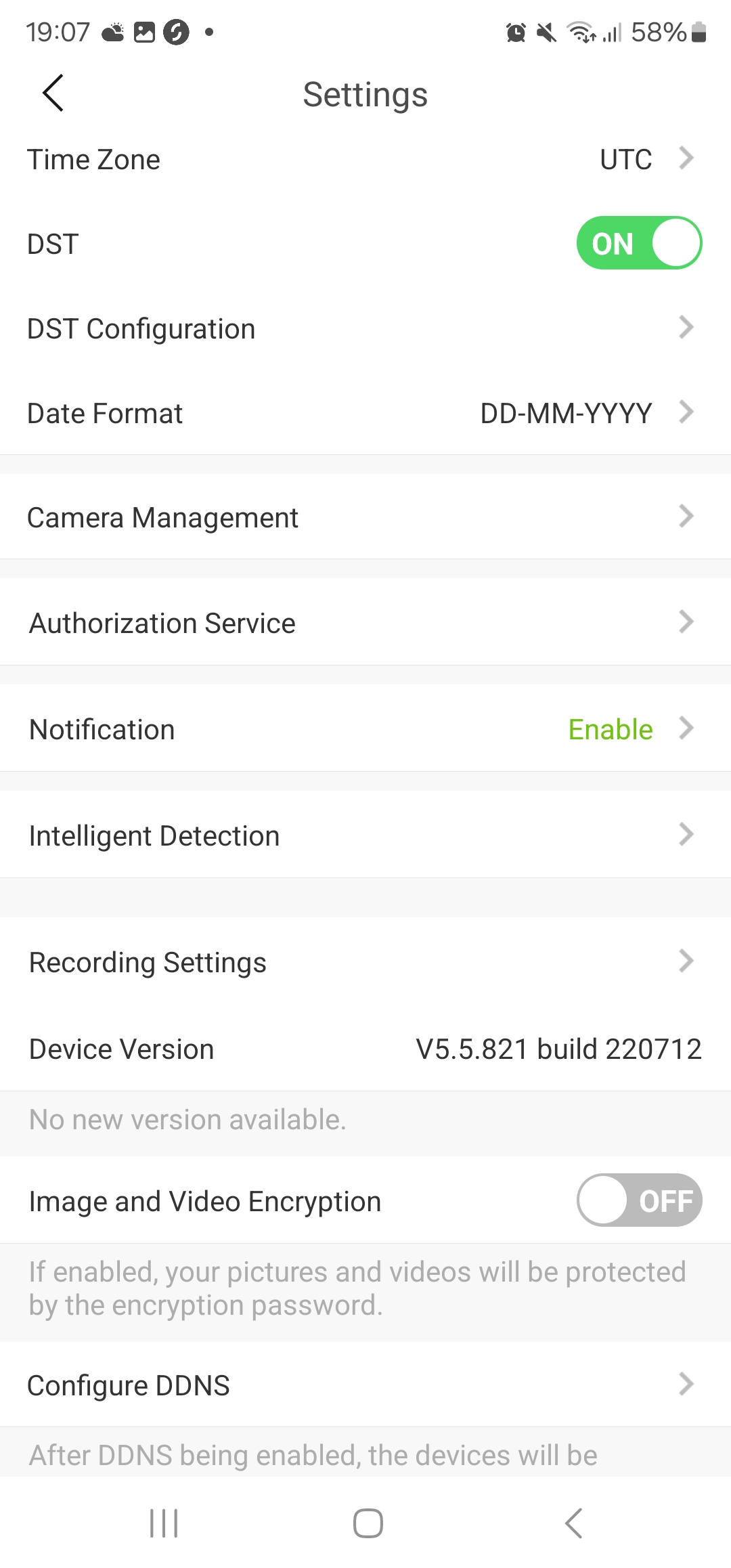

What firmware version is the camera currently running?
It's the latest available I've done a search.

That does look to be the latest firmware.
