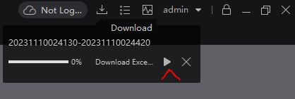

However, some more experimentation has revealed that: When i attempt to download a snippet of video, whilst the recorded video is still open (streaming from the camera), i get the error shown in my OP. However i just noticed that when that happens, this icon appears...
Clicking this reveals the failed download:
Pressing the 'play' button now just causes the original error to show once again.
However: If i close the video playback stream (Not pause, but close entirely, not the whole "Remote Playback" tab, just the video frame), and then press the small 'play' button again, the download begins, and finishes successfully:
Also, if i get two downloads 'queuing' in this download pane, and try and run them together, the original error is shown when i try and start the second download.
AND just to prove a point, if i have a download running, and i attempt to reopen the 'playback stream', THIS error is displayed:
It seems no two operations can be performed simultaneously - No idea if this is a camera limitation, bug, setup error or what.
