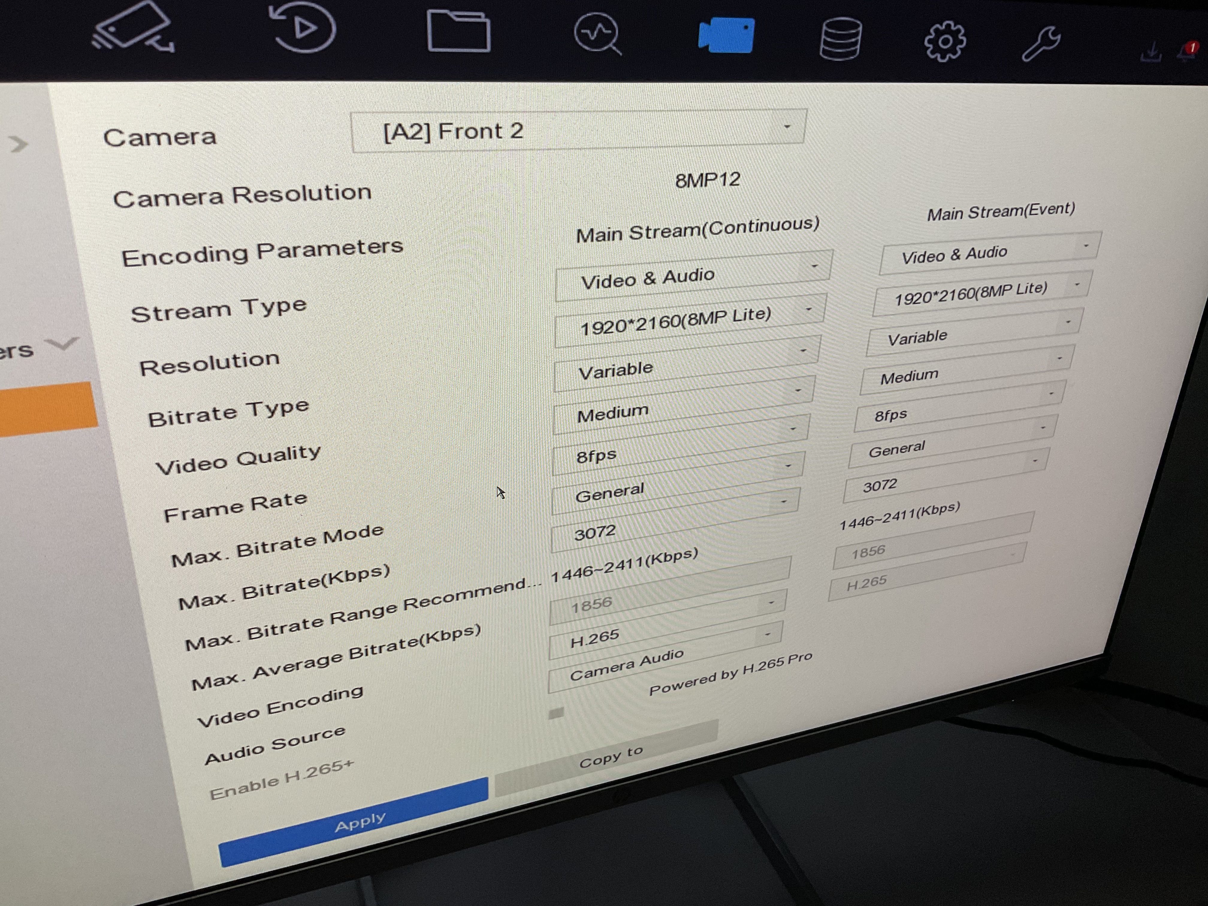

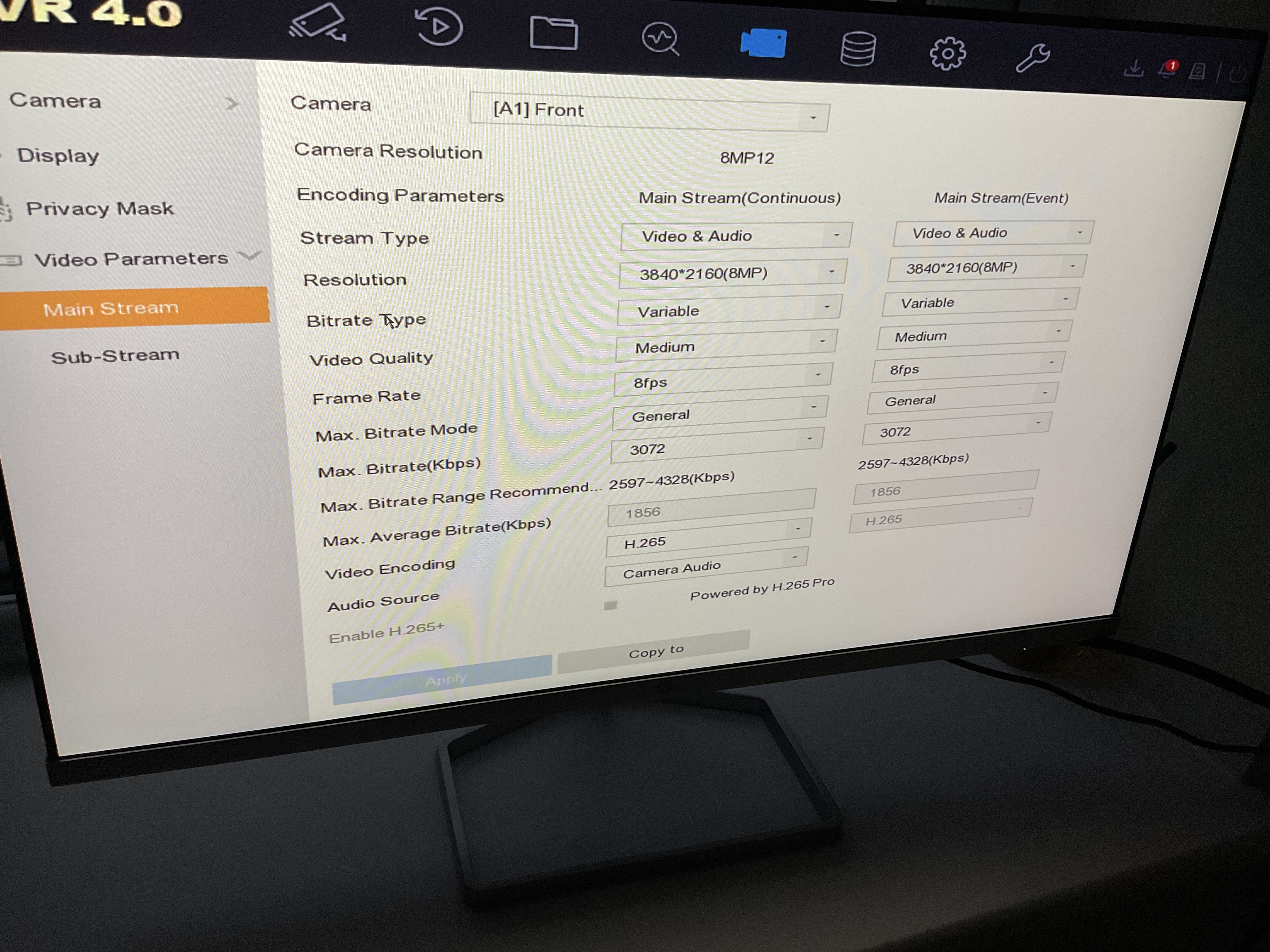

Upon viewing my cameras after fitting them the images on three of the cameras are bad and the one that was always good is still perfect.
I unplugged the good camera and individually plugged in the other cameras only one in and then out on the dvr to see what the image was like and none of the cameras came on.
The cameras wil only come on if the good camera is connected.
I’m beginning to think it had something to do with the resolution,the good camera is the first picture and the second image is of the other three cameras,the resolution has changed to lite I can’t alter it to the same as picture one.

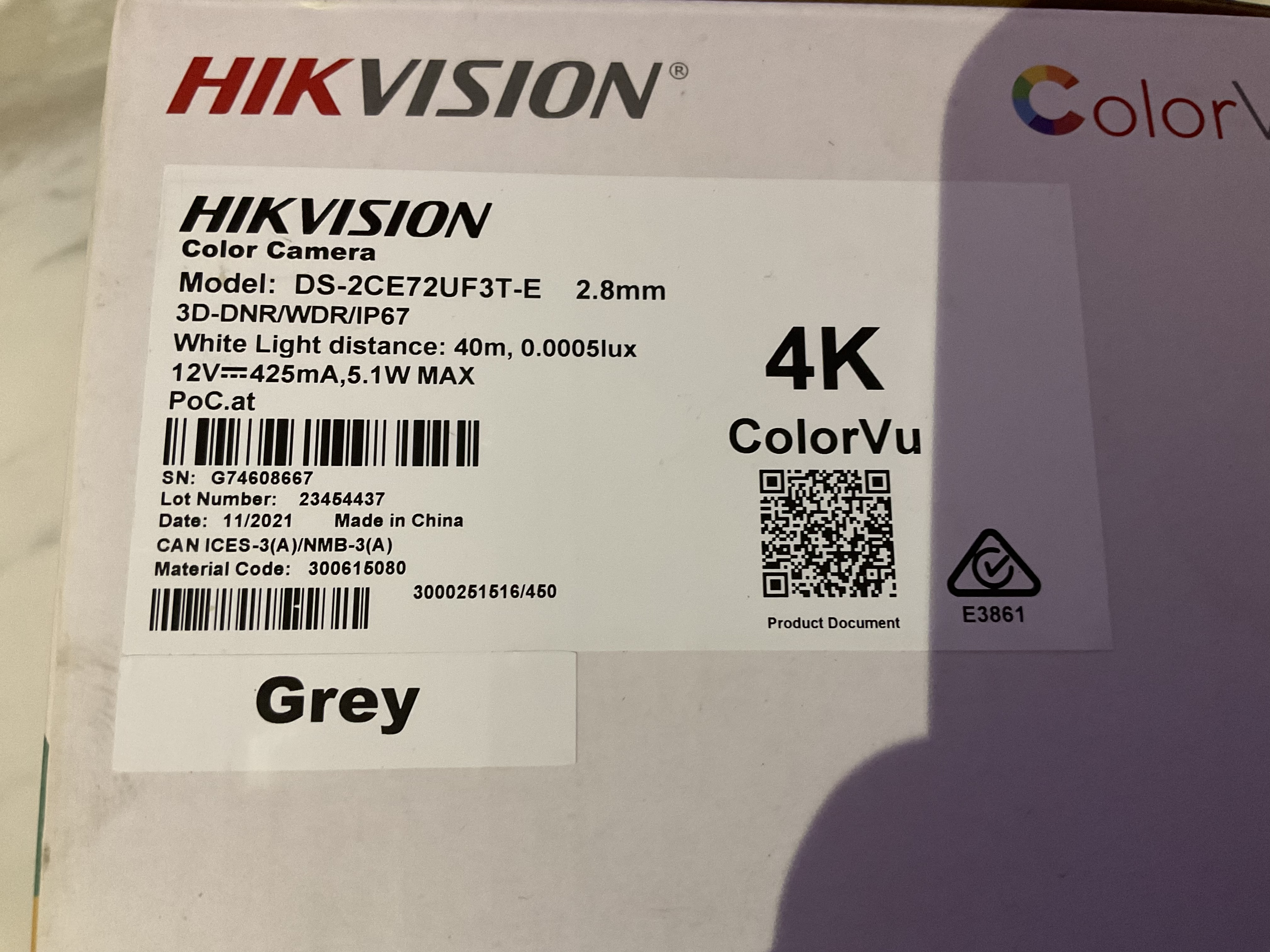

The cameras were the same as the ones that I took down with no problems at all….these are the cameras below.
The strange thing is that I never had the problem before and the cameras are identical,it’s just that the resolution has changed and it should be 3840 as the other cameras.
I just don’t understand why the option in the drop down for the resolution isn’t available for 3840.

Hi @Kejn
It's very strange. Are you absolutely sure that the 3 problem cameras have exactly the same model numbers as the camera that is working?
The Hikvision analog model numbers are quite confusing so it is easy for one or two digits to be different in the model number and you not notice.
I ask because the specs for the DS-2CE72UF3T-E do not mention anywhere an option for 8MP Lite resolution so I can't understand why that would be the only resolution option.
