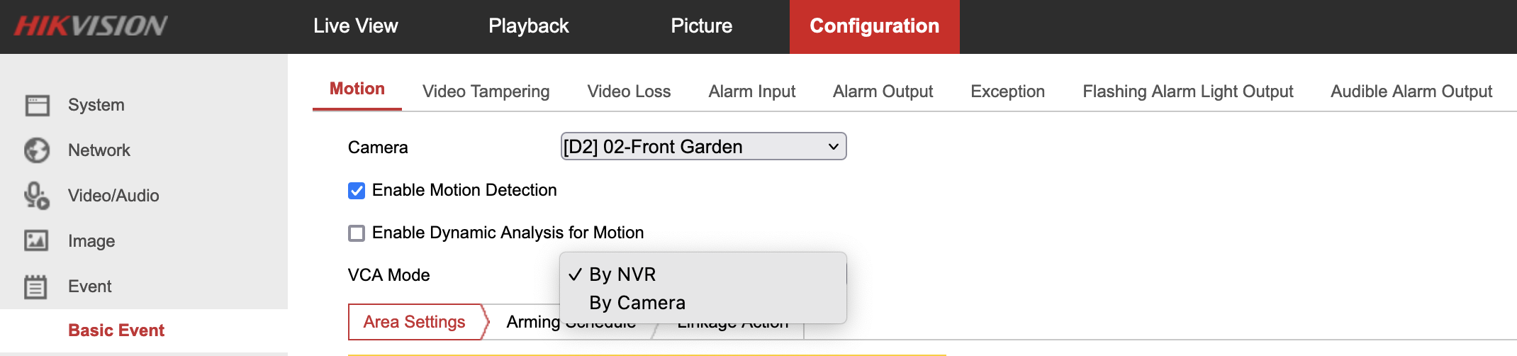

Enable AI by 'Device' - typical of Hikvision to call it 'Device' rather than 'NVR' or 'Camera' and cause confusion. It's a little more obvious if you use the web configuration as it's very clearly indicated there. This is a DS-7608NXI-K1 and rather than a single checkbox uses a dropdown for VCA mode:

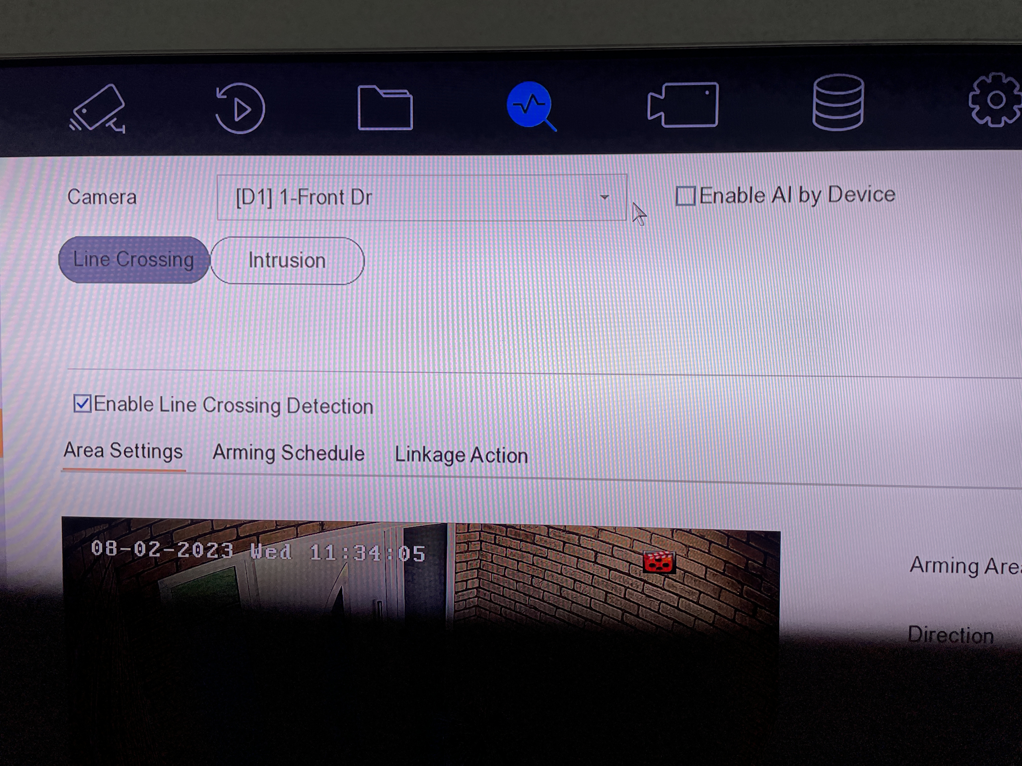

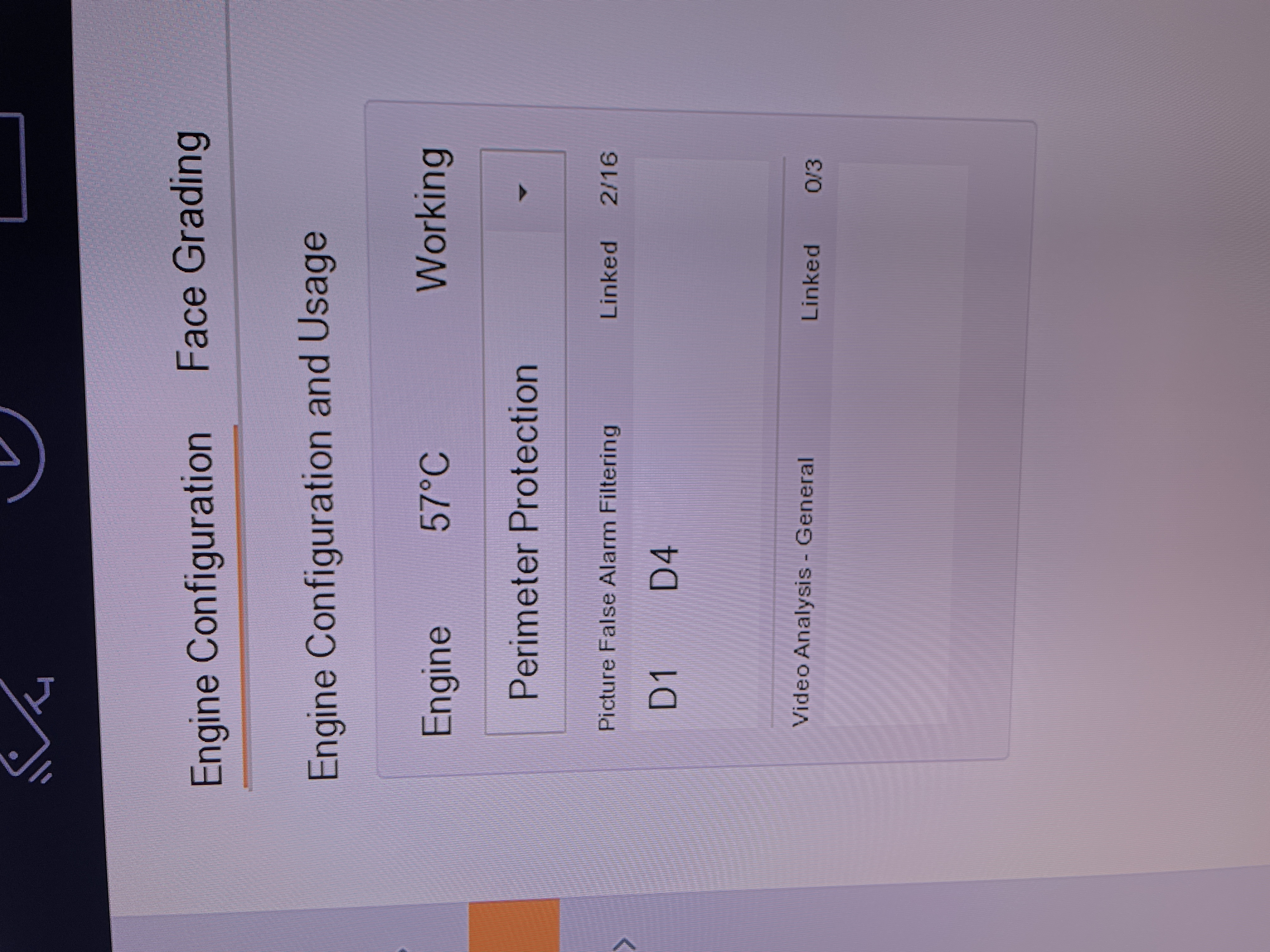

@mkssab I can confirm that on the local GUI, "Enable Device AI" translates as "Enable NVR AI". If you set up line crossing or intrusion on a camera and leave the "Enable Device AI" box unchecked, the NVR does the processing. In the local menu there is a screen that can be accessed in Smart Analysis > Event Engine and that will show which cameras the NVR is doing the processing for. For example in the images here you can see that Line Crossing is enabled for camera 1 with the box unchecked and the Event Engine shows that it is doing the processing for this:
