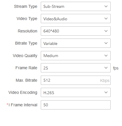

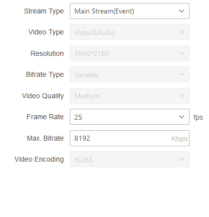

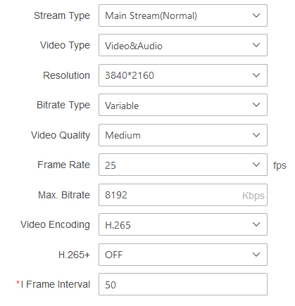

As for best camera settings, you shouldn't need to compromise as I have 8 of these 4K liveguard cameras on the same NVR at full res/frame rate and never have experienced bandwidth issues. In fact I had them on my old K series NVR but upgraded to the I series for 2-way audio. I have added screenshots of my settings for main stream, sub stream and main stream event
Main Stream
Sub Stream
Main Stream Event

Thanks for the camera settings, i notice you have video quality set to medium, what is the difference between video quality and resolution. Does setting it to medium have an impact in quality on live view and playback.
