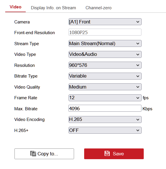

I've configured my Hikvision DS-7204HTH1-K1 to record on motion detection, but when I try to playback the recordings I get a nastygram saying:
The current recoding resolution has exceeded control's decoding capability.
The cameras I am using are analogue cameras, configured like:
What do I need to do to fix this?
Update: Solved it!! Set encoding to H.264 and now it all works (and at 1920x1080).
