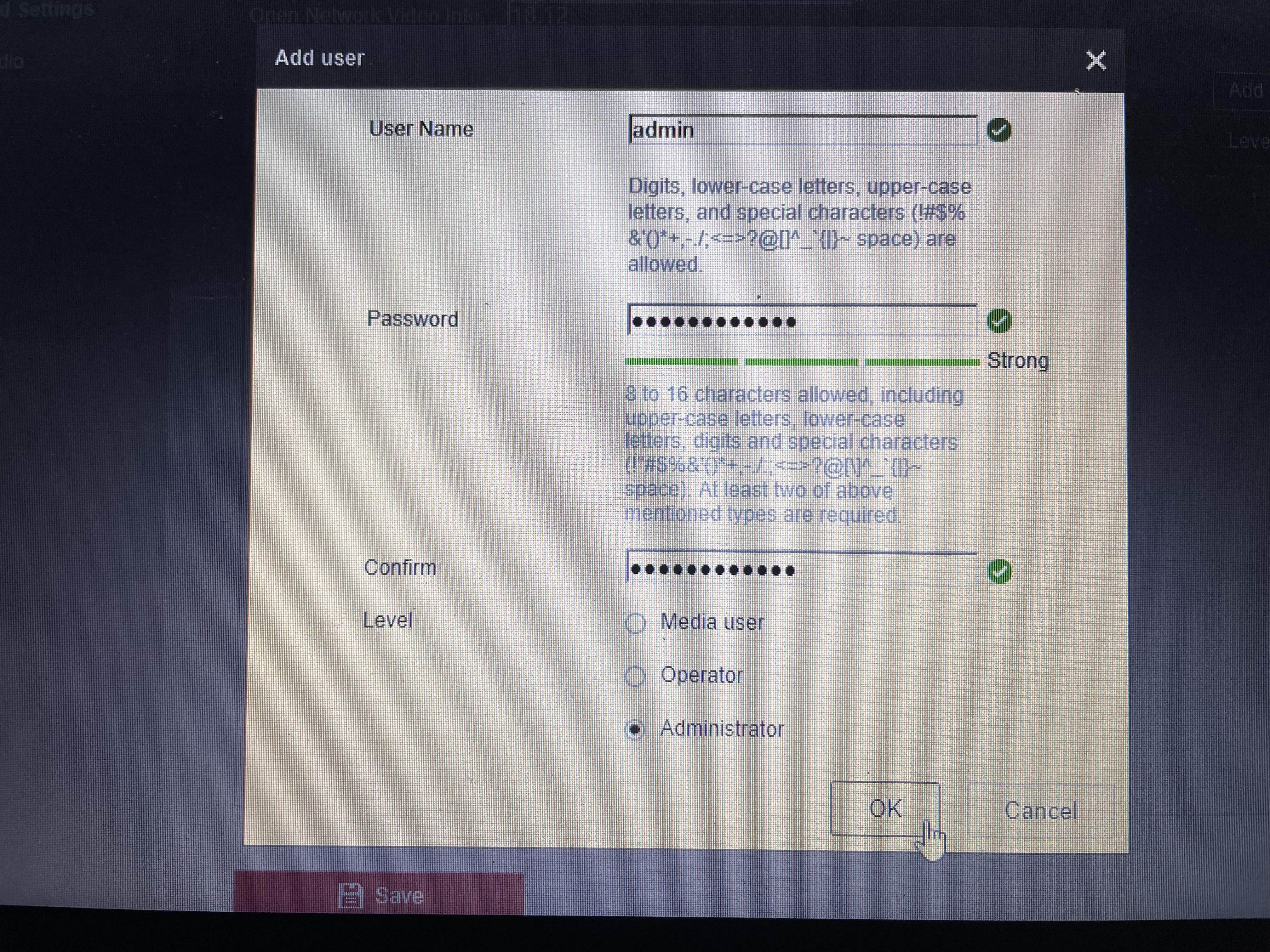

In IVMS, I open the settings for the camera, go to advanced network settings and then Internet Protocol. I click the tick box for Open Network Video Interface and then I click create user.
As you can see here, it accepts the username and password I enter.

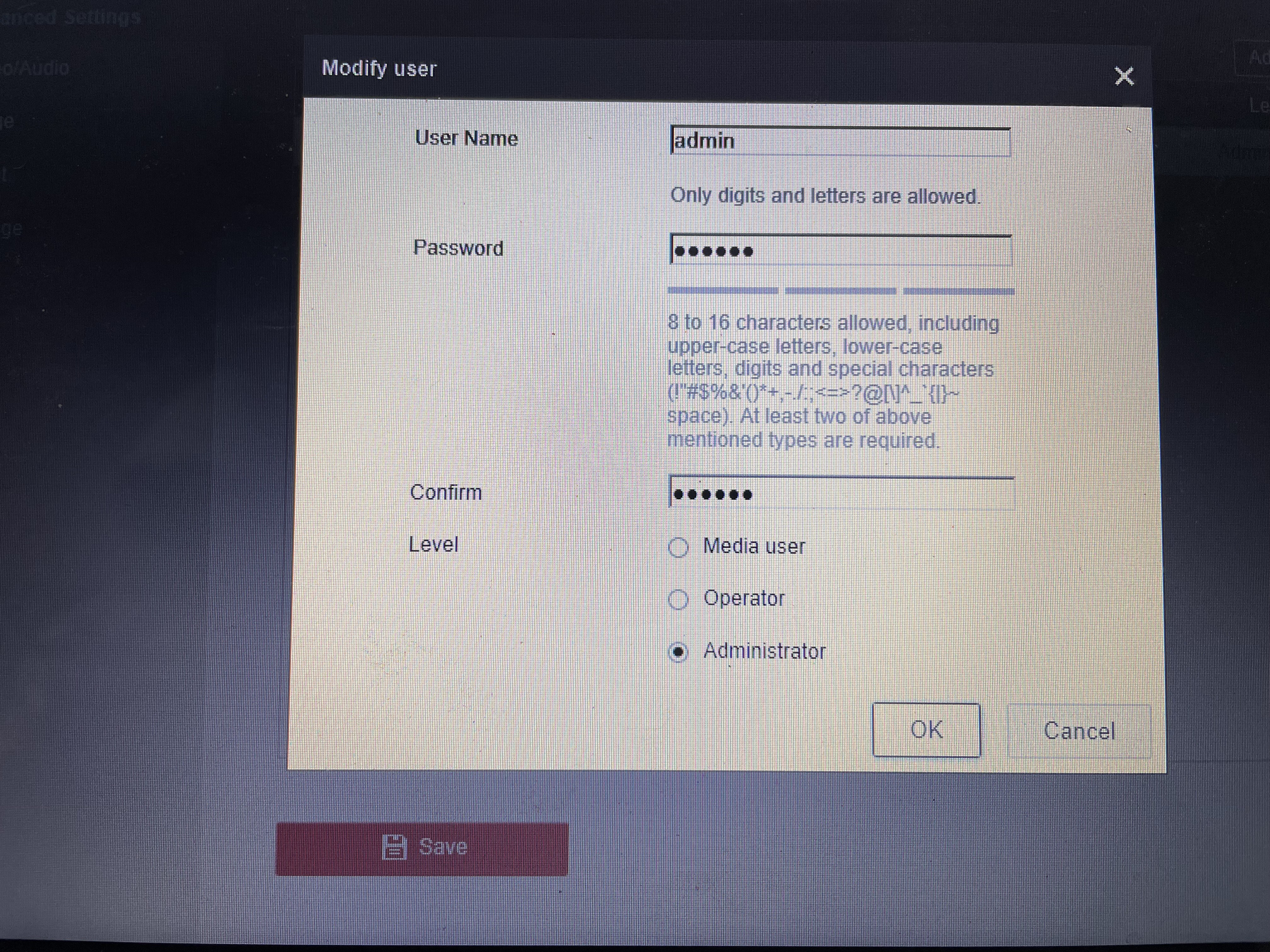

When I go to attempt to add the camera to the unifi console, it detects the camera, but the password I entered doesn't work. So then when you go back into IVMS and go to check the password, it is reset to this 6 digit password that I do not know.
I have tried and tried several attempts to no avail. When I check the saved password on other cameras (the 9 which worked), it does show enough password digits to be my actual password.

Its not reseting to 6 digit password, this is known as default password filler. So it shows that its set and not empty.

I appreciate the reply but I'm pretty sure in this specific circumstance its not default password filler. When I go to change the password on any of the other 9 cameras, it shows the total amount of characters of the password which I set. Do you know where abouts I can change the RTSP settings?
