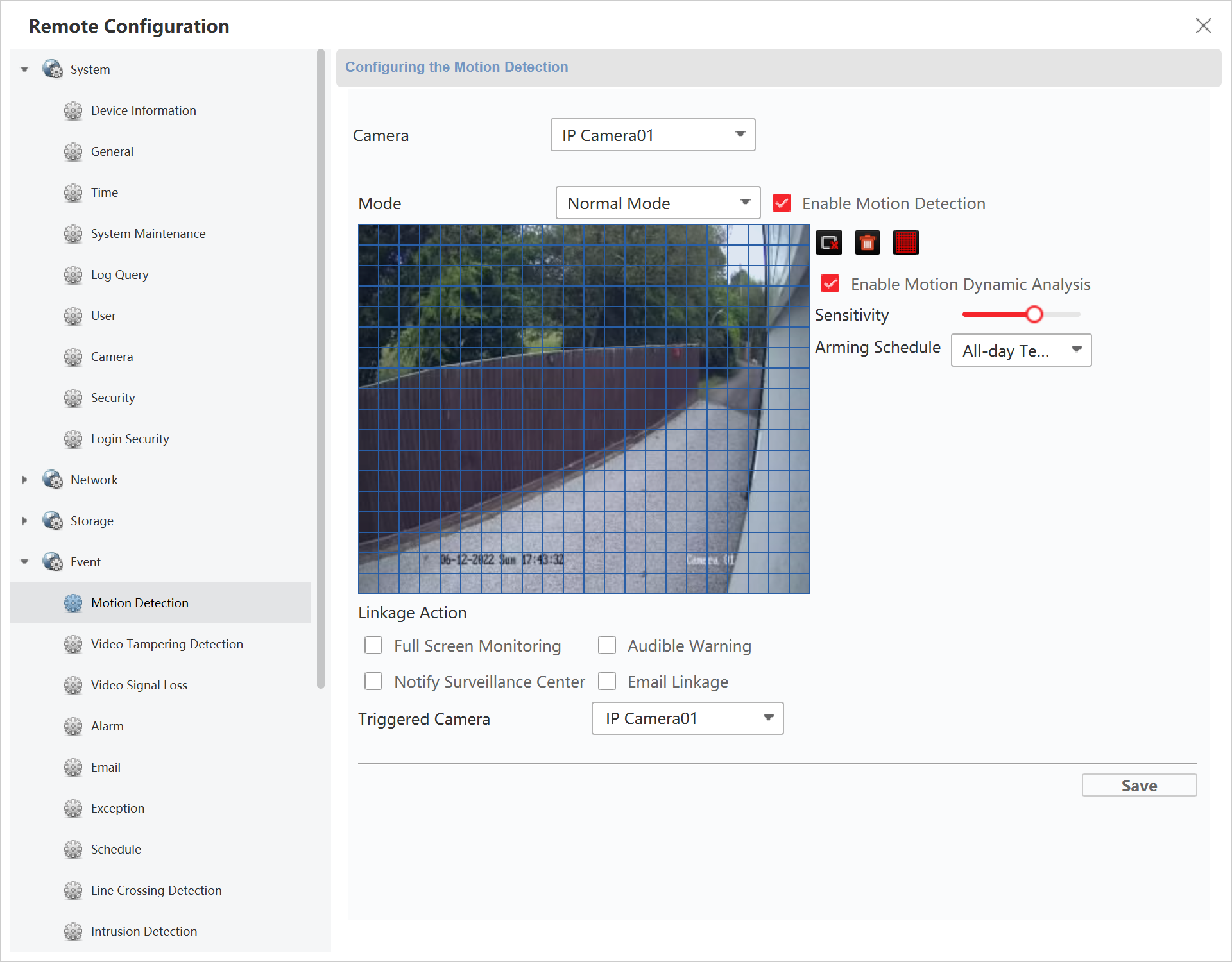

Hi,
I have two identical NVR's with identical cameras behaving differently within iVMS.
NVR 1 - DS-7608NI-K2 firmware - V4.32.116 build 220112.
8 x DS2CD2345FWD-I cameras attached directly - firmware V5.6.6 build 210625
NVR 2 - DS-7608NI-K2 firmware V3.4.100 build 180310
4 x DS2CD2345FWD-I cameras attached directly - firmware V unknown (no access currently)
On NVR 2, using iVMS (V3.7.0.5) i can access the camera settings and see the live view to draw areas etc. Also, all 4 cameras appear in the Camera section of the settings window.

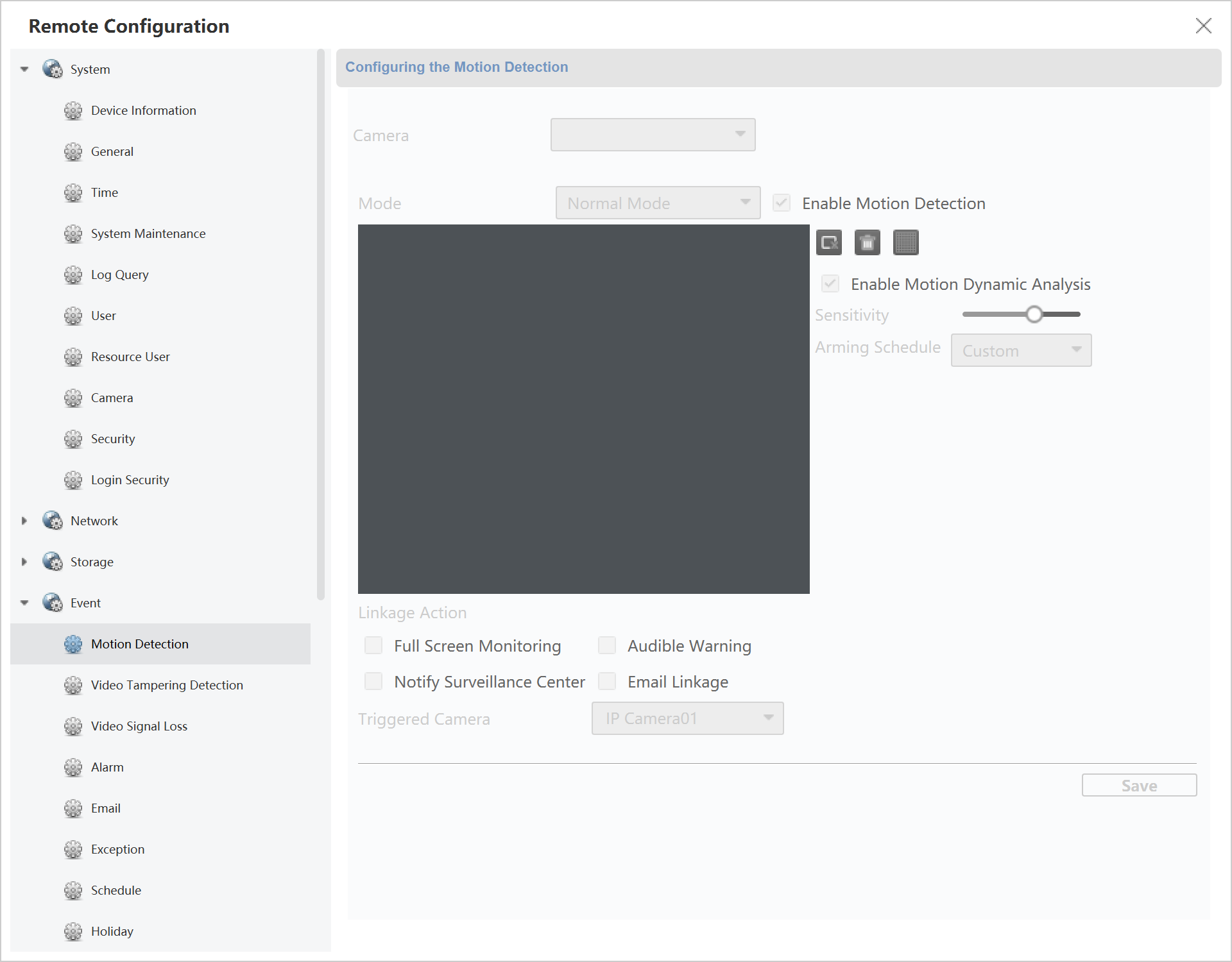

On NVR 1, live View works for all 8 cameras but when i access settings, none of the cameras are available to edit and none of them appear within the Camera section. The whole page is greyed out.
Is it likely to be the updated NVR or camera firmware stopping this working? The older versions on identical hardware are still working? All settings seem fairly similar on both NVR's and both show online on the Hik-Connect site.

Thanks again for the help. I actually posted a similar thread in another forum and a user there was having the exact same problem as me. He eventually found out that, although not documented anywhere, the functionality was removed in the V4 firmware?
I'm definitely running the latest version of iVMS.
I think I will stick to my original plan and update the the older firmware on both the cameras and NVR and see if I lose the functionality once they are up to date. At least that will prove the theory either way.
My apologies, I thought it may have been an old version of iVMS from your screenshots.
I'm seeing the same problem with our K-Series NVR on V4.32.116 (I'm also seeing the same on .115 and .110), so I think it is almost definitely linked to the NVR firmware not working properly with iVMS, as the connected cameras are all up to date.
The live preview does work for setting up events if you use an internet browser to connect the NVR though, which is at least a fallback until it gets fixed in iVMS.
