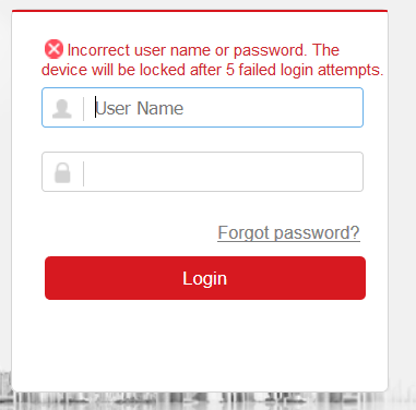

The password I use for NVR interface and SADP is identical to the one I use on Internet Explorer. Internet explorer does not accept it. See screen snip below.
I am at a completely loss as to whats going on.
I did as you say just now and revealed the password to ensure I was typing correctly but the issue persists.

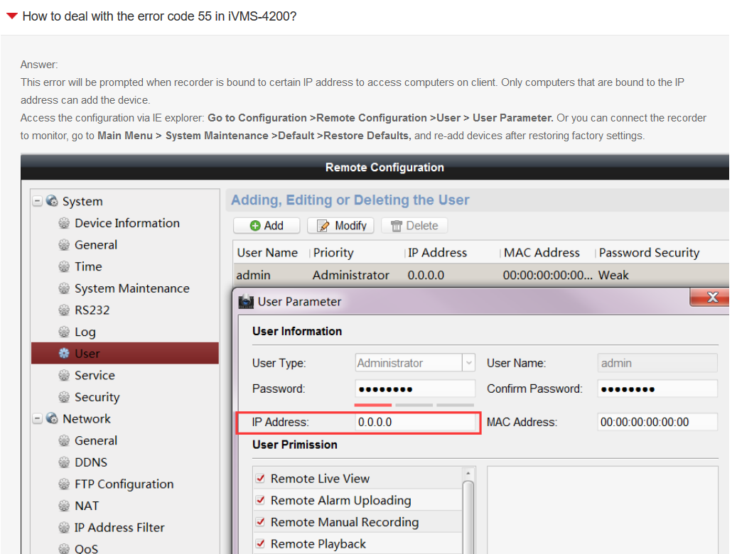

I found a solution to my ivms 'error code 55' issue below from Hikvision Support site under FAQ's header for 'Client Software and tools', however, for me to resolve it I need to access NVR via web. Apperantly the reason I cant add nvr to ivms is because ip address of admin user accessing web portal is not bound to NVR ip. Does that make sense to you at all Phil as its double dutch to me.. See below.
I cannot remember if I changed anything in the below section on web interface when I had access last week.
Might you or any reader be able to confirm that the below screenshot is indeed a screen shot from web portal "Remote Configuration" screen or is it accessible from somewhere else possibly?? It looks like IVMS to me but I cant replicate anywhere in IVMS personally..

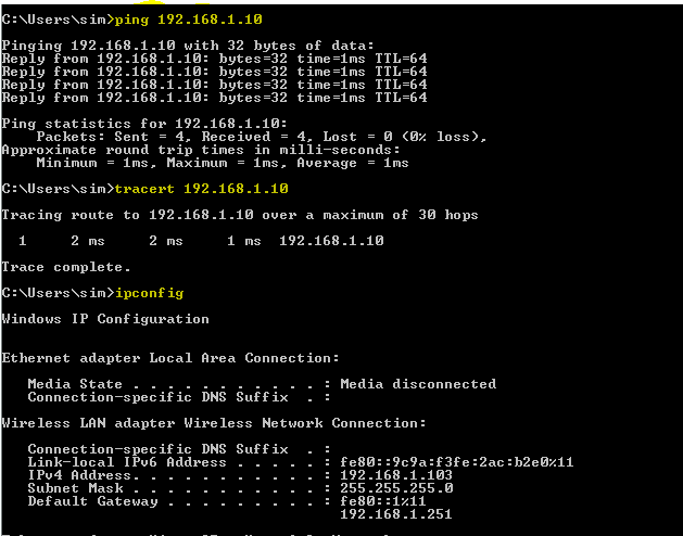

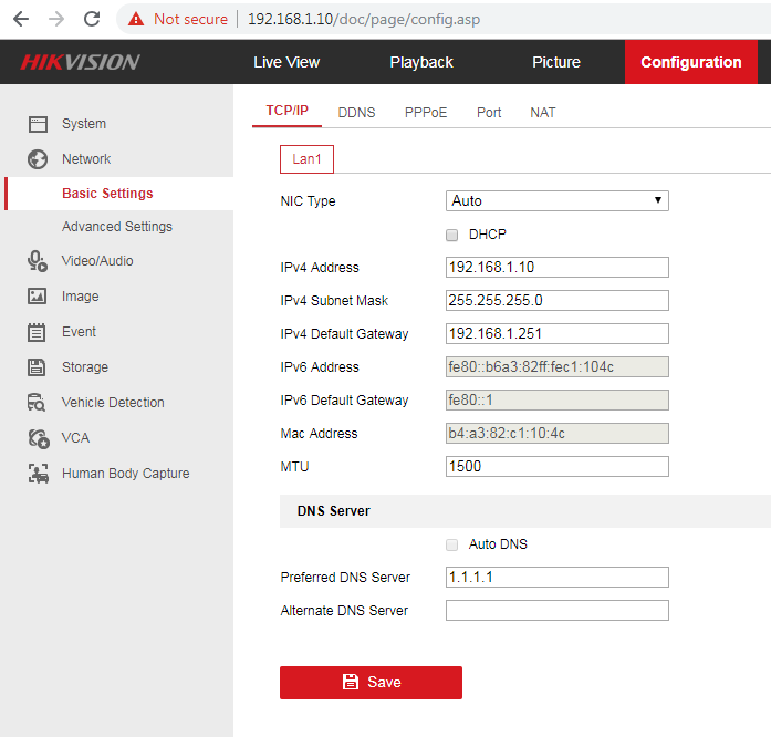

Just to eliminate the possibility of a network issue, would you post a capture of the highlighted commands? Supplement your NVR IP over mine. Also, the network settings of the NVR, which you would have to source directly on the NVR (second image). It may help.
Just a quickie to let you know that the OP emailed me this afternoon:

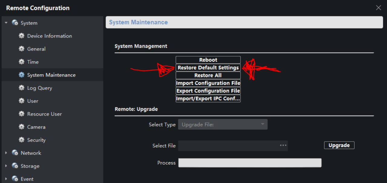

I assume restore to inactive does a complete reset of the unit include the admin password. Which option is this? Is it restore default settings or restore All? what is the difference?
Restore All is a factory reset.
Restore Default Settings will keep your IP address and password, but reset all the camera's other configurable settings back to default.
