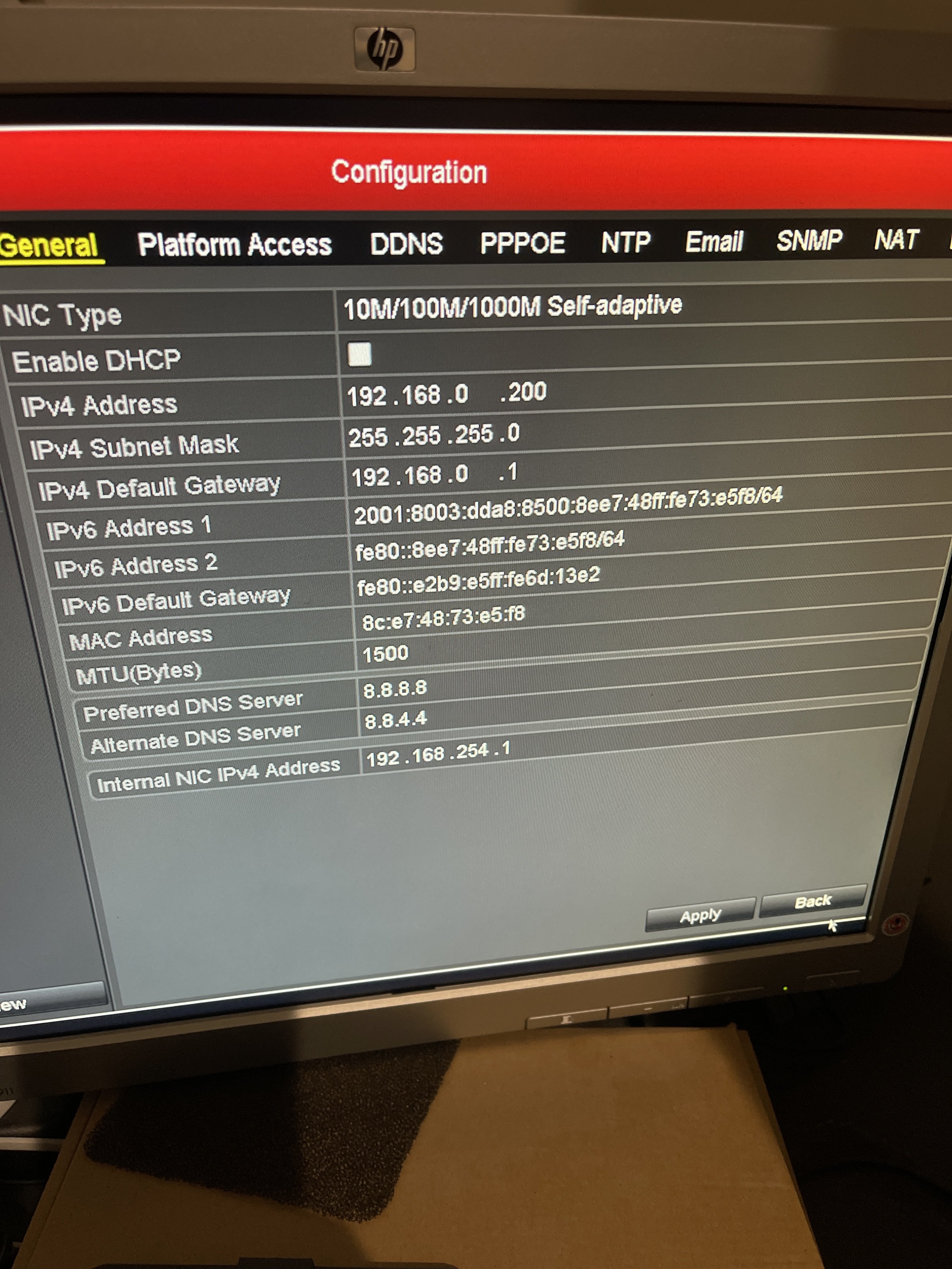

so you can now see all camera live views (except the one on its way out) but you still can't ping the NVR or log in to it with a browser?
What happens when you take the NVRs IP address from the Network settings on the direct monitor and put that IP address into a browser? Do you get any particular error message? (please share a screenshot if you can)
I can do that mate will do it tomorrow as it’s late now, dvr is set to a static ip.

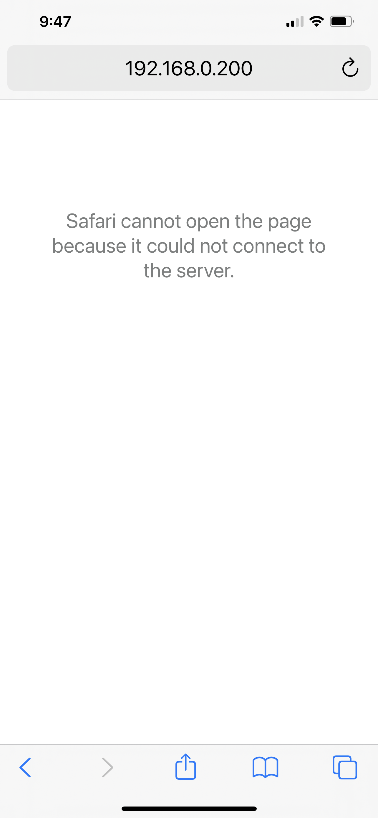

When I try to connect through URL it just times out.
Hi @jmercieca
That looks like a mobile browser, have you ever successfully accessed the NVR with a mobile browser?
Do you have a PC/Laptop that is hard-wired to the same local network/router as the NVR?
Your mobile device will be connected via WiFi/3G/4G which is not actually the same network range as the NVR which is hard-wired to your local network and so that might be why you cannot connect from the mobile browser.

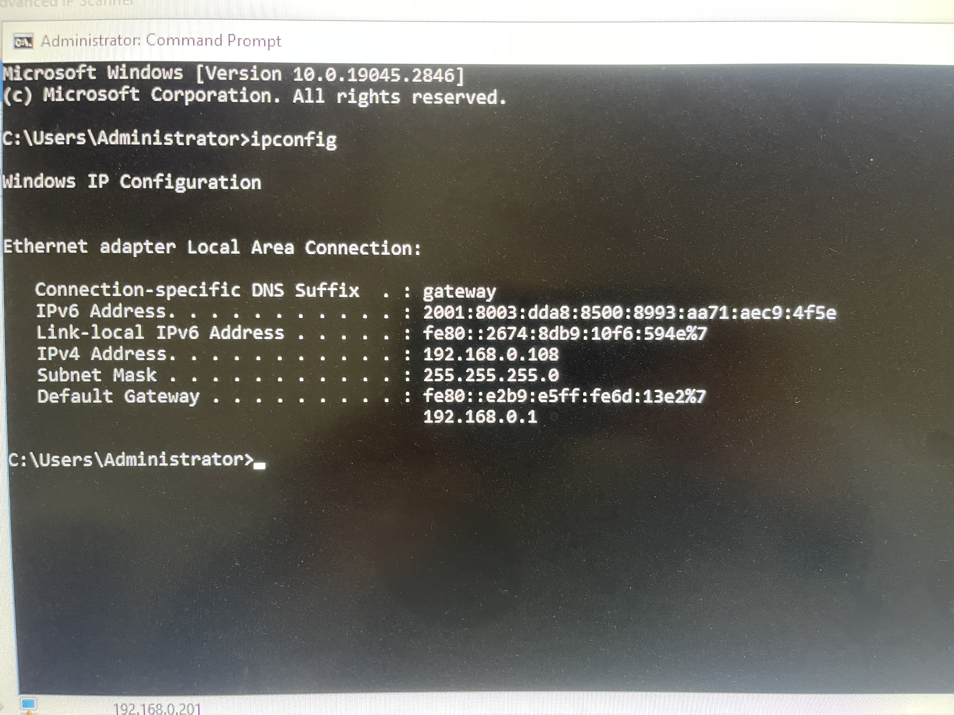

okay,
On the PC, can you open Command Prompt and follow these instructions to confirm that your LAN gateway is still on the 192.168.0.xxx IP range?
See attached

Okay,
the network information looks correct, having looked at all the above I can only think that due to the age of the NVR model some kind of fault has occurred with the NVR hardware and we would recommend looking for a new replacement.
