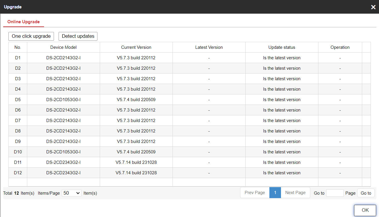

The NVR shows the cameras are all online (and I do see the video coming), but it seems like my NVR has no option to upgrade the firmware for the IP cameras from the NVR's portal from a file (only with "One Click upgrade", but unfortunately it doesn't detect the new version).
Trying to connect to the IP's of 10 of the 12 cameras directly over HTTP fails with time-out. I recently added two new cameras, and luckily I was able access their portal via HTTP and upgrade them manually (see image below).

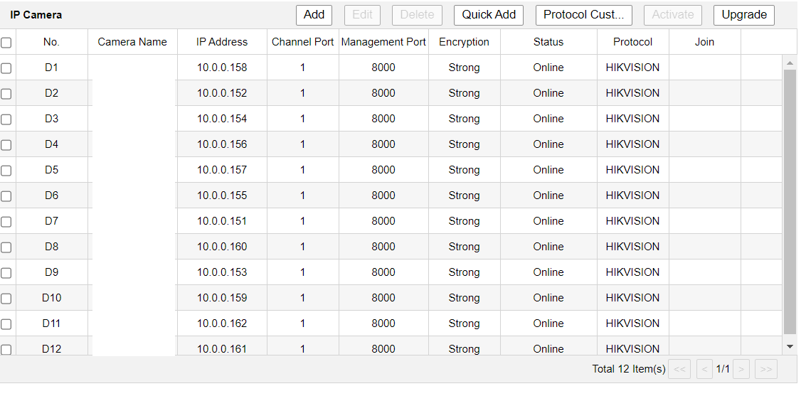

Any idea why I cannot connect to any of the ports of the IP cameras? The default managements port is also inaccessible to any other tool like iVMS / Batch Configuration.

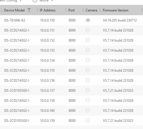

I do see all the cameras via SADP.

I just solved the issue, so happy to share in case someone come across this in the future...
All of the 10 cameras that I couldn't access their portal had the wrong gateway IP configured. It was set to 192.168.1.1 instead of 10.0.0.138.
In my case 192.168.1.1 is the gateway of a different VLAN and the connection between the two VLANs is blocked.
I noticed that after connecting my laptop directly to the switch of the Hikvision cameras... (before that I was connected to the router via a VPN)
