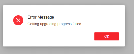

Hi @Dan
I have tried to downgrade and get the error message as shown on the attached file.
What can I do now ?
I have tried all versions that you suggested (starting with lowest to highest) and I get the same message each time.

Any other suggestions???
Should I contact the supplier/manufacturer and return the device ?
