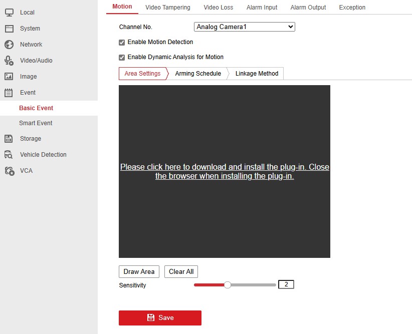

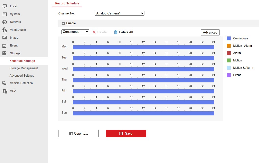

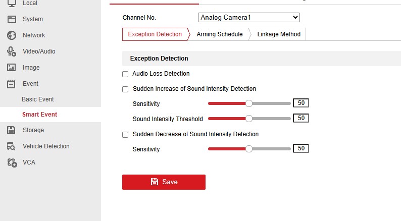

Can you please share some screenshots/photos of the event menus in your DVR?
here you go

Thanks @IMF73
It looks like Motion Detection is enabled, but you need to check that the arming schedule is set and that under the linkage method you have "Notify Surveillance Center" ticked.
If you still can't see the events, the last thing to check would be to log in to the DVR with iVMS-4200 or a direct monitor and check how the detection area has been set for motion detection.
