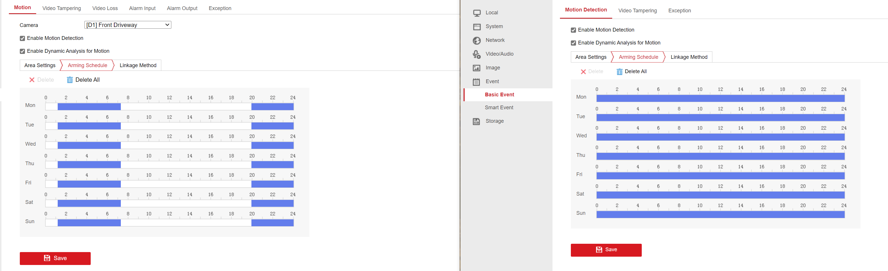

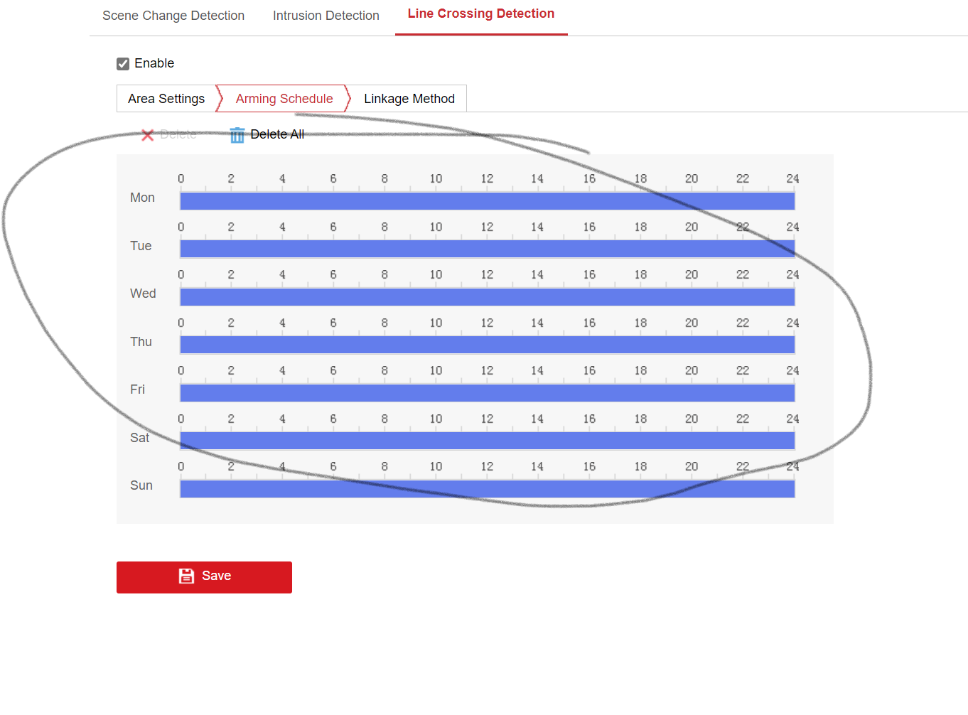

Right and Thank you for replying, I just think I'm doing something wrong. I setup NVR for the schedule typically 12:00-8 AM is the only time I want alerts. I check NVR and all settings look good. Go to the camera and this is what I see, a shared image. so would seem there is some communication problem between cam's and NVR since Cams constantly revert to 24/7

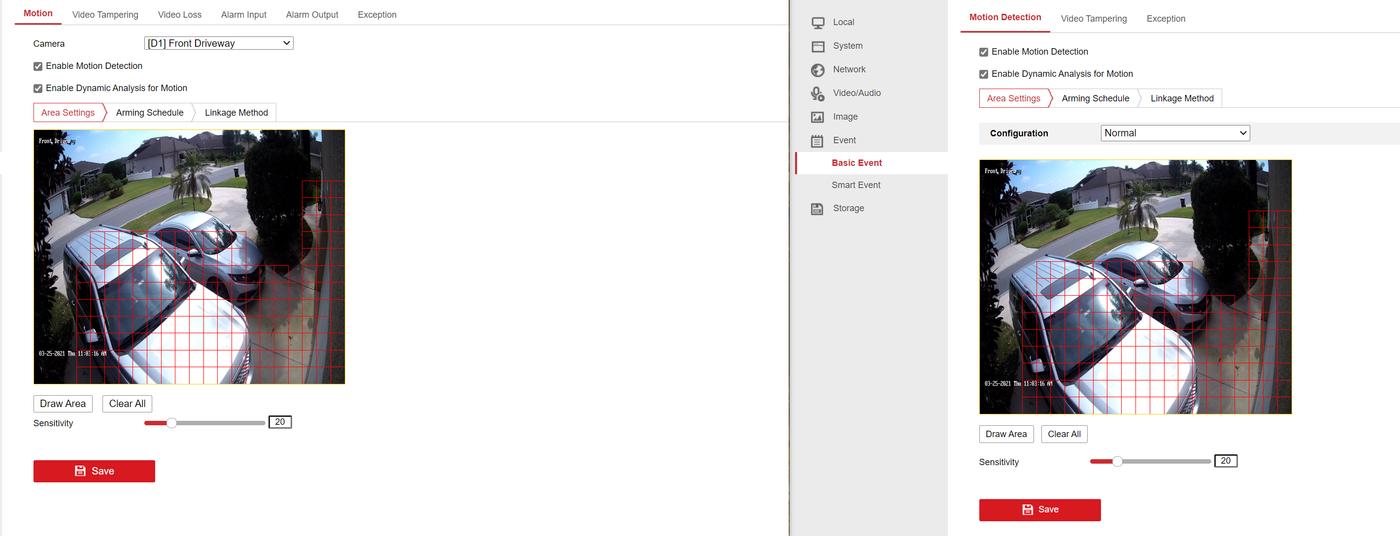

Here I did some side by sides, NVR Area highlighted agrees, Schedules does not NVR and camera. I would think this would not be this difficult so Leaning back to blueIris now ! I just feel like I'm doing something wrong but not so sure now after how you explained .

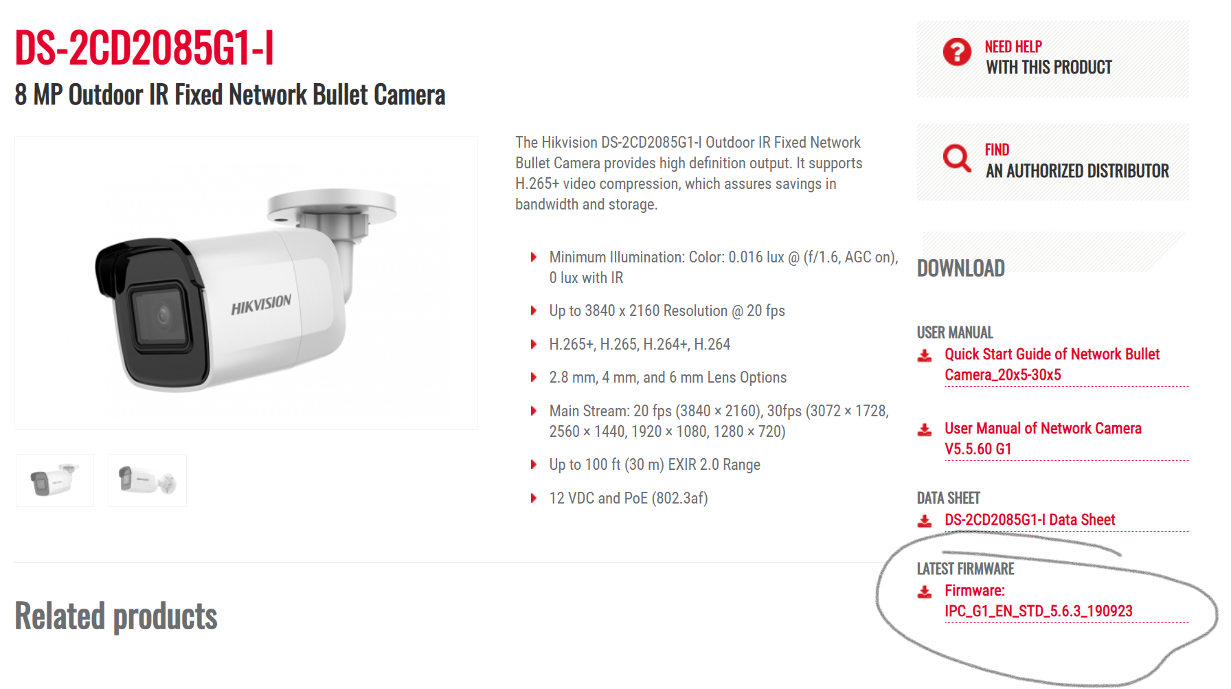

ok, you are on the latest firmware for the NVR, but there is a newer v5.6.5 firmware for the camera. Seeing as the schedule in the camera is where you are seeing the issue it is worth updating to this latest firmware as the issue may have been resolved in one of the versions since the v5.4.3 you are currently running.
(we tested a camera running v5.6.5 on our office I-series NVR and we did not see the issue you are seeing)
Well aint that interesting, when I go to HIK site i see this is there better spot to look for firmware?
trying one you provided now
