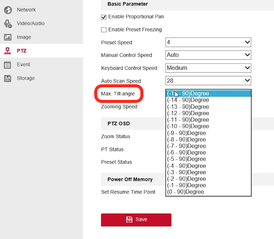

To change the movement range currently set on the PTZ, you will need to connect to the camera directly in a web browser.
Then, go to:
Once you have chosen an option that you're happy with, make sure to click "save" at the bottom of the page so that these changes are updated on the camera.
NB - If your camera is directly connected to an NVR's network ports, then you will need to use the Virtual Host feature to access the camera's backend. If it is connected to your local network, then you can just browse for its IP address to do this.
Then, go to:
Configuration > PTZ > Basic Settings > Max. Tilt Angle
You should have some different options in this dropdown, depending on the maximum tilt range of your camera. If you want to enable the complete range of movement, then select the option with the largest range between the two figures (in this case, "-15 - 90˚").
