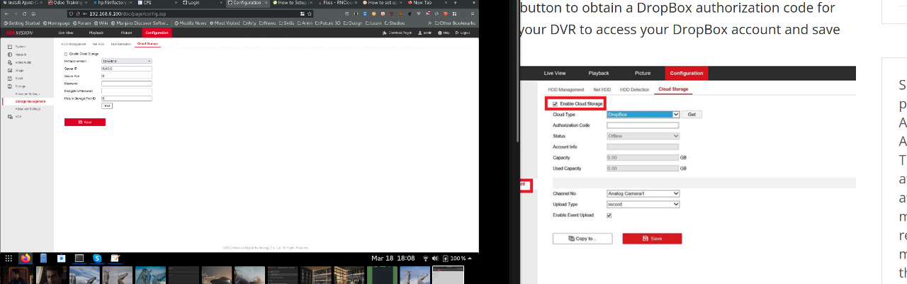

Hi. i have recently purchased

My intention was to take an image after interval ( 1 min ) and upload to dropbox. when i see documentation, my settings are different. Just wanted to know reason.? i can only see cloud1 and cloud 2. all docs and videos on youtube (in last year) shows dropbox option etc.

In regards to the first question, have you tried logging into the NVR with Internet Explorer? The older software on the K-series NVRs is not fully supported by modern browsers like Firefox or Chrome and so some features/menus can be missing when accessed with these browsers.
