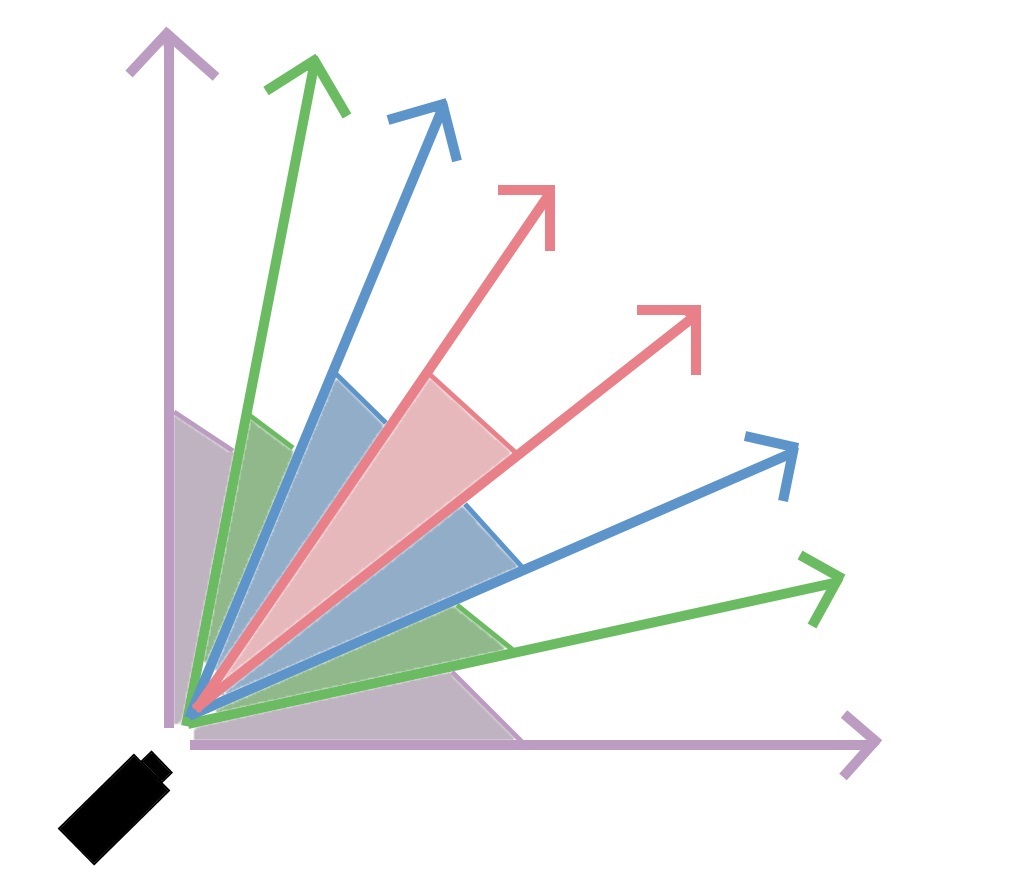

Another point to consider when selecting your camera is the focal length, many cameras have a range of focal lengths to choose from. Most commonly, 2.8mm, 3.6mm, 4mm and 6mm. Having a range of focal lengths to choose from means you can mix and match within your system depending on the application requirements. It is also more cost-effective than purchasing a varifocal camera.Frame-Rate
