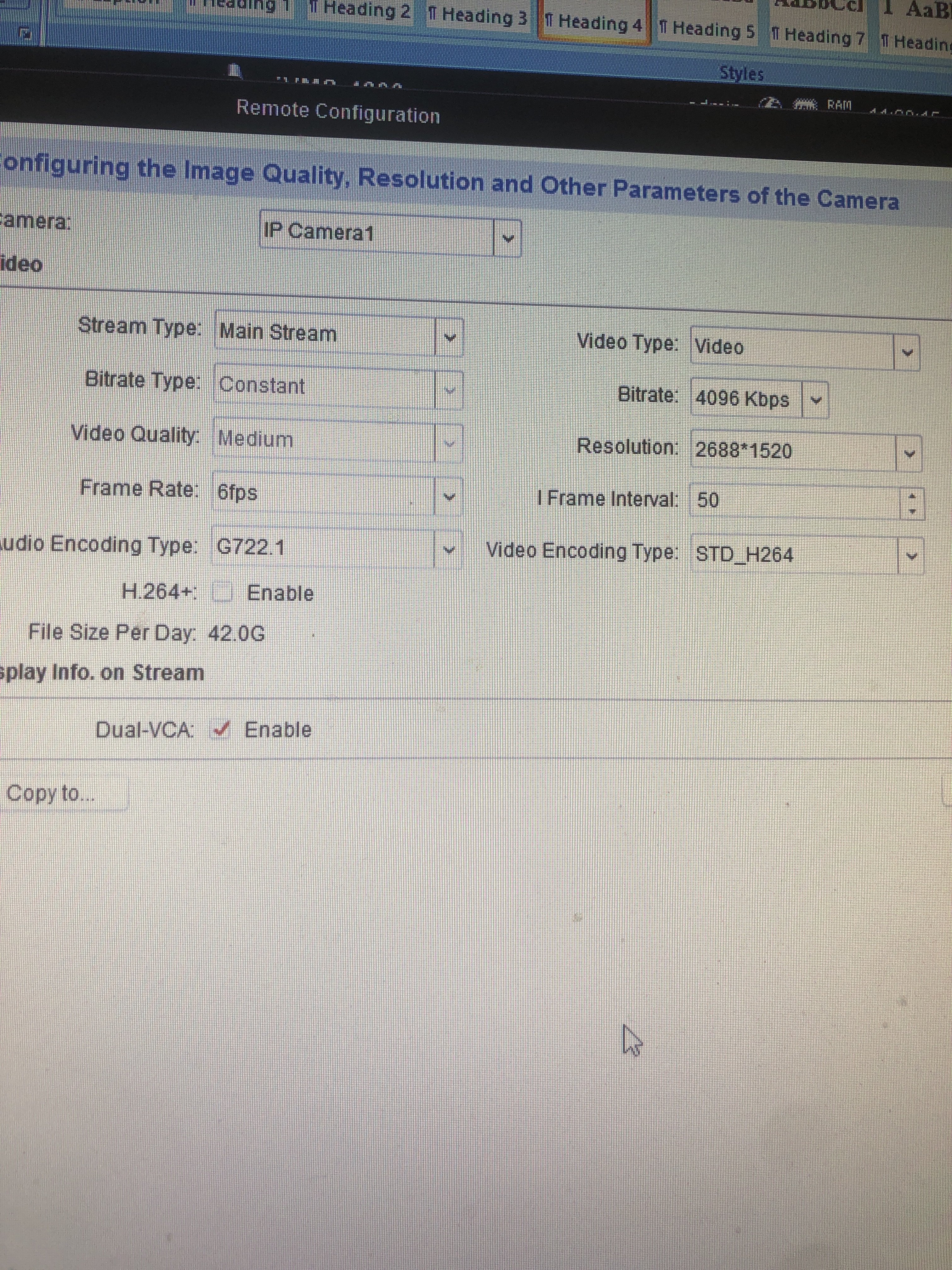

Can only settle on 4096 bitrate (all cams @ full res)
Is this correct? They should be at 16384 surely?

Please upload a screenshot of the settings you are concerned about
Thanks Phil, see attached. I can’t het higher than 4096 on Any camera regardless of resolution etc without locking up and freezing etc

Change to variable bit rate, High quality and set your cameras to use the h.265+ CODEC
