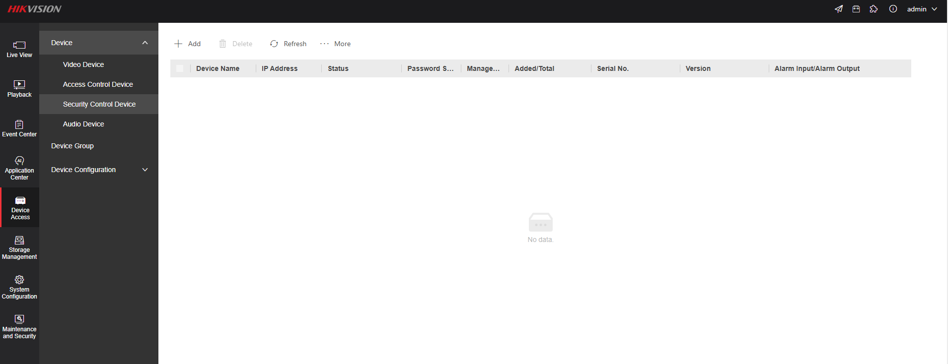

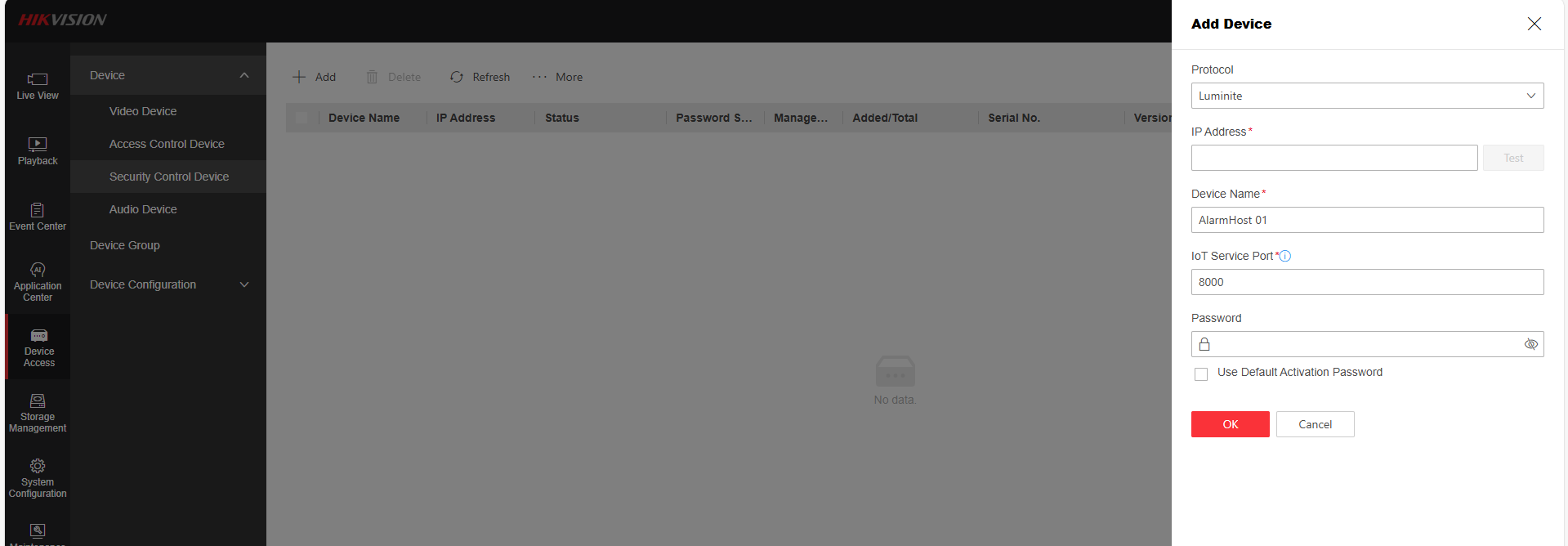

Hi @J273 ... this probably won't help because I have a DS-7616NI-M2/16P on V5 firmware... here is where an alarm host is setup on that model:
