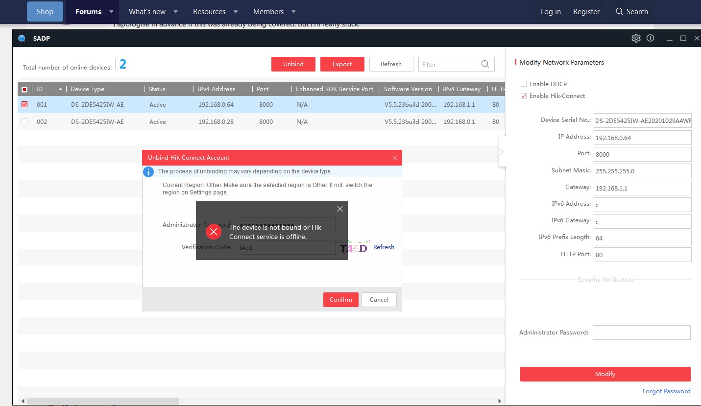

Apparently for some reasons I can't unbind any of my cams.
See screenshot
Any ideas would be greatly appreciated
Ok, it may be that because you had added via QR Code or IP address that the device was never properly bound to Hik-Connect, try skipping this step and see if you can add the device to the Hik-Connect portal.

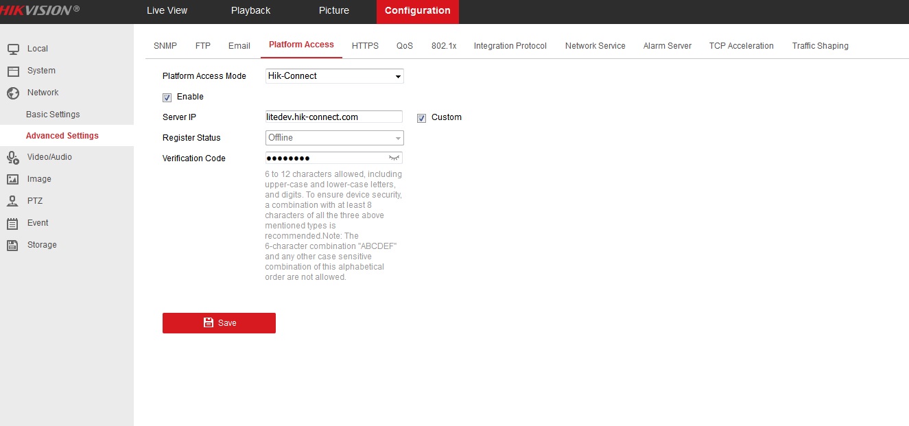

Hik-Connect is asking verification code after ive sn input
Yes, this should be the verification code/Encryption key you were prompted to set when enabling Hik-Connect in the camera's platform access menu
I honestly can't remember doing that :D how can i recover that code ?
ps. Hik-Connect can only find one cam, for the other one it shows offline
See my instructions in my earlier comment:
"Login to the camera with a browser on your local network and go to Configuration > Network > Advanced Network > Platform Access and make sure Hik-Connect is enabled"
By default, the Platform access page may be set to 'Ehome' but if you click the dropdown you can switch to Hik-Connect
Once you click to enable Hik-Connect a pop-up should appear asking you to set a verification code.

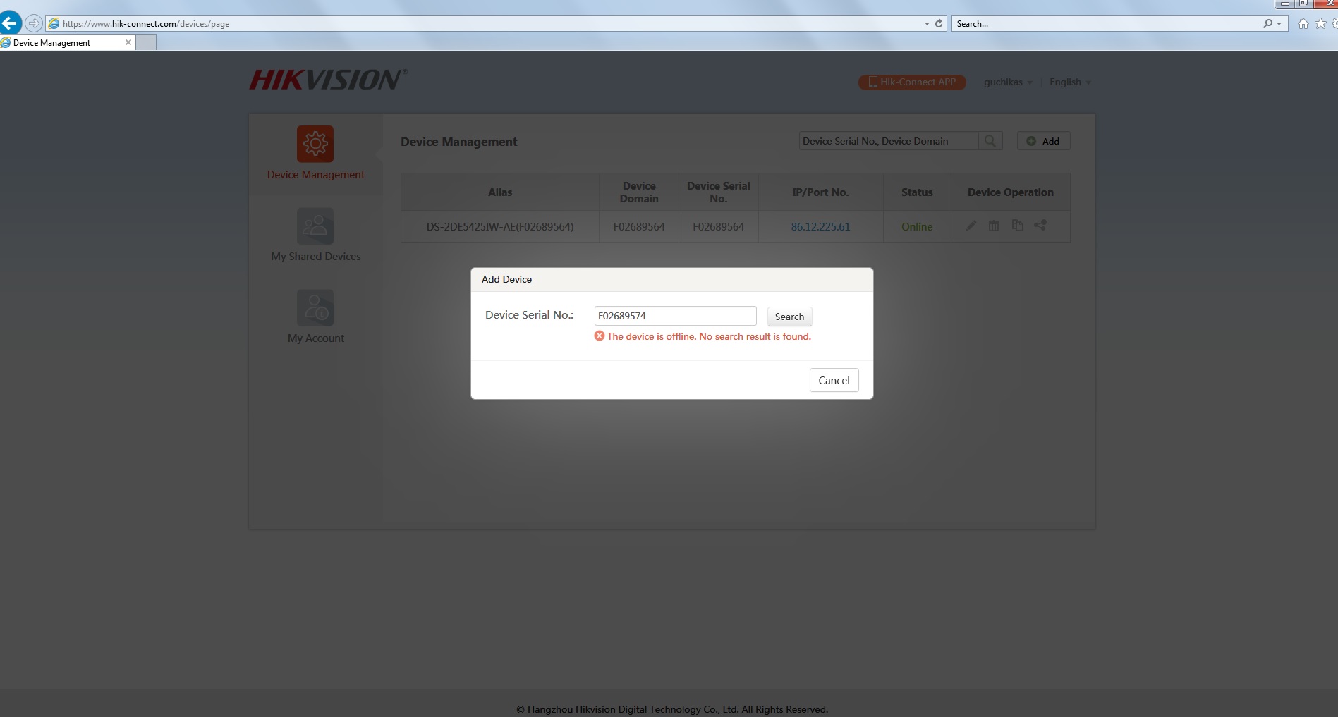

Ok I've added one cam, but the other one is showing offline :D
can you please share a screenshot of what you are seeing?
ok, and you have logged in to each camera and enabled Hik-Connect in the Platform access menu for both?
That one is showing offline, but its actually working

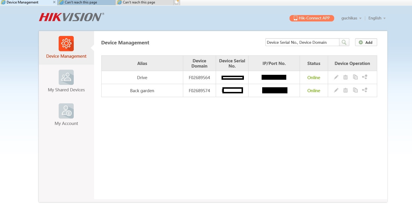

Got it in the end, why it should be so difficult to do?
