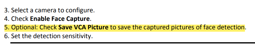

Do you have this option anywhere in the face capture settings?
