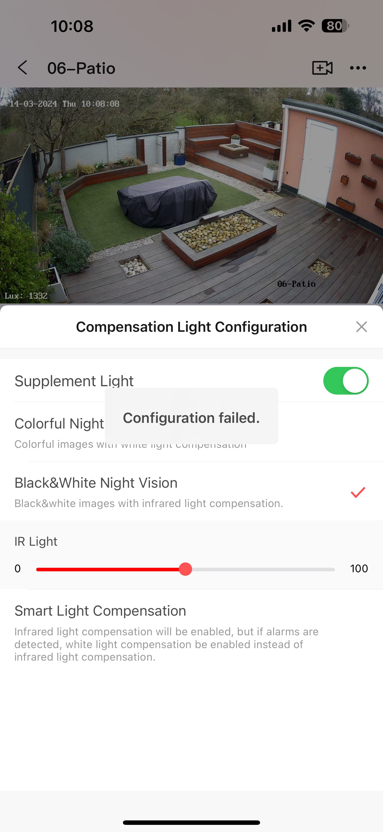

The bug regards control of the Hybrid Light Cameras mode in Hik-Connect. After clicking the icon for 'Compensation Light Configuration' in Hik-Connect, firstly the app fails to retrieve the status of smart light compensation and shows it as off. Turning the switch on results in 'Configuration Failed'. With the screen populated, changing the mode (Colourful, Night Vision, Black & White Night Vision, Smart Light Compensation) or adjusting any level result in 'Configuration Failed'

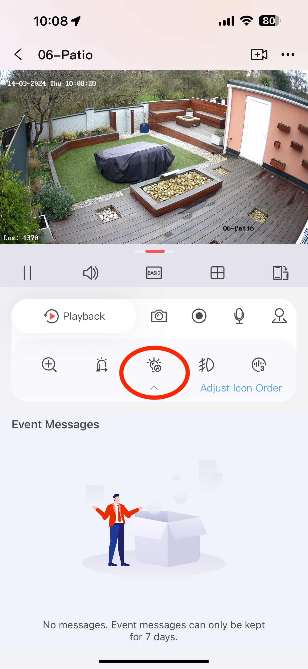

Thanks @Kyle - it's not clear where the issue lies. It doesn't appear to be the camera itself as I rolled back one version. Once I click this icon on any of (3) 2387G2H-LIU cameras:
Clicking any option gives me 'Configuration Failed':
I checked last night and it wasn't possible to alter the setting using Hik-Connect. Clicking the 'Defog' icon to the right has the same effect. It seems to save the setting fine when adjusted on the local UI in Device Access > Device Configuration > Device Parameter > Display Settings.
