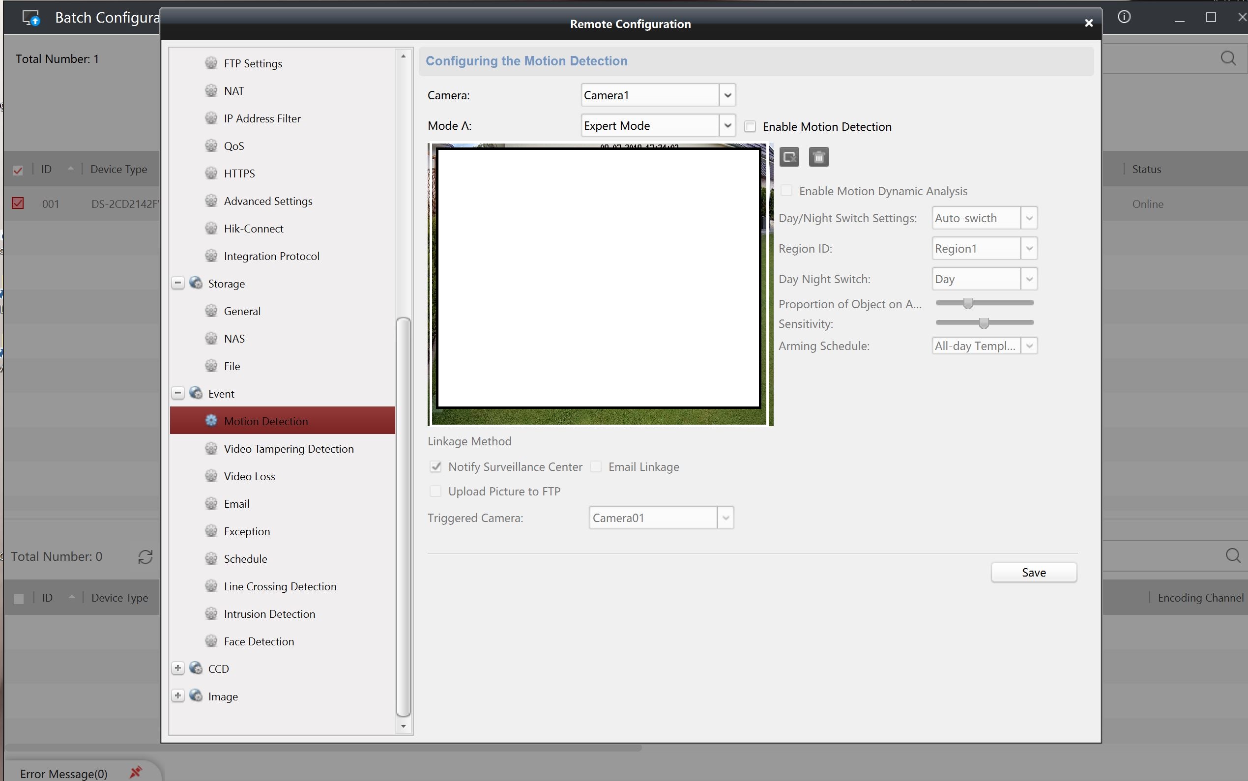

how can i Change the Name of the attachment (JPG) ? I have three Cameras and Always i get the same names of the Pictures.
HikvisionTools-Batch (Attachment here) . If i could Change the Name here, but there is no possibility.

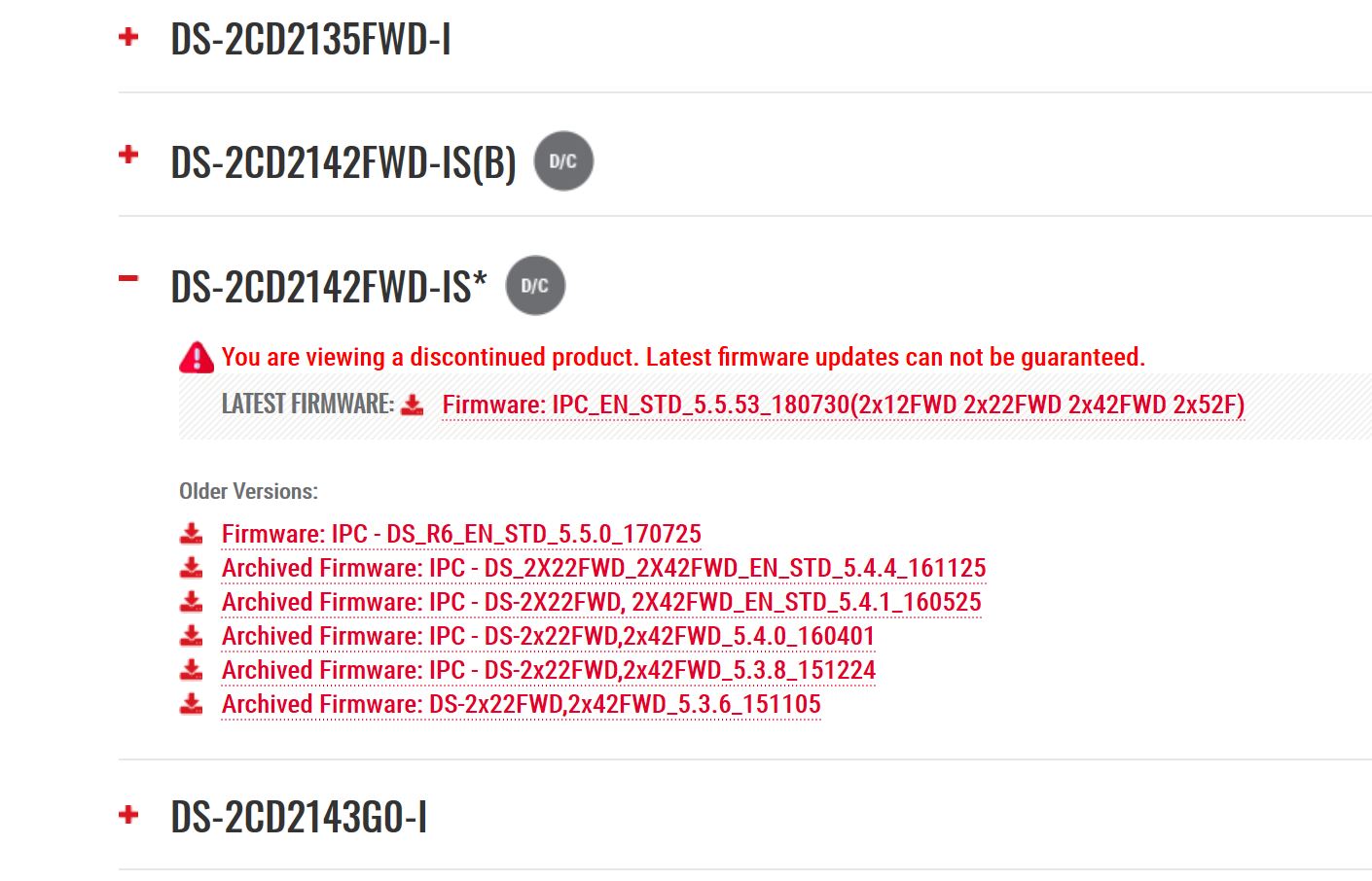

can not find v5.5.83
only v5.5.53 see Attach file
v5.5.53 is the latest firmware for your 2142 camera, your camera is R6 family and the v5.5.83 firmware is only for G1 family cameras, the person who posted about downgrading firmware above wasn't actually advising you, they have another problem relating to their G1 cameras and they are chasing StewartM around the forum trying to get answers.
