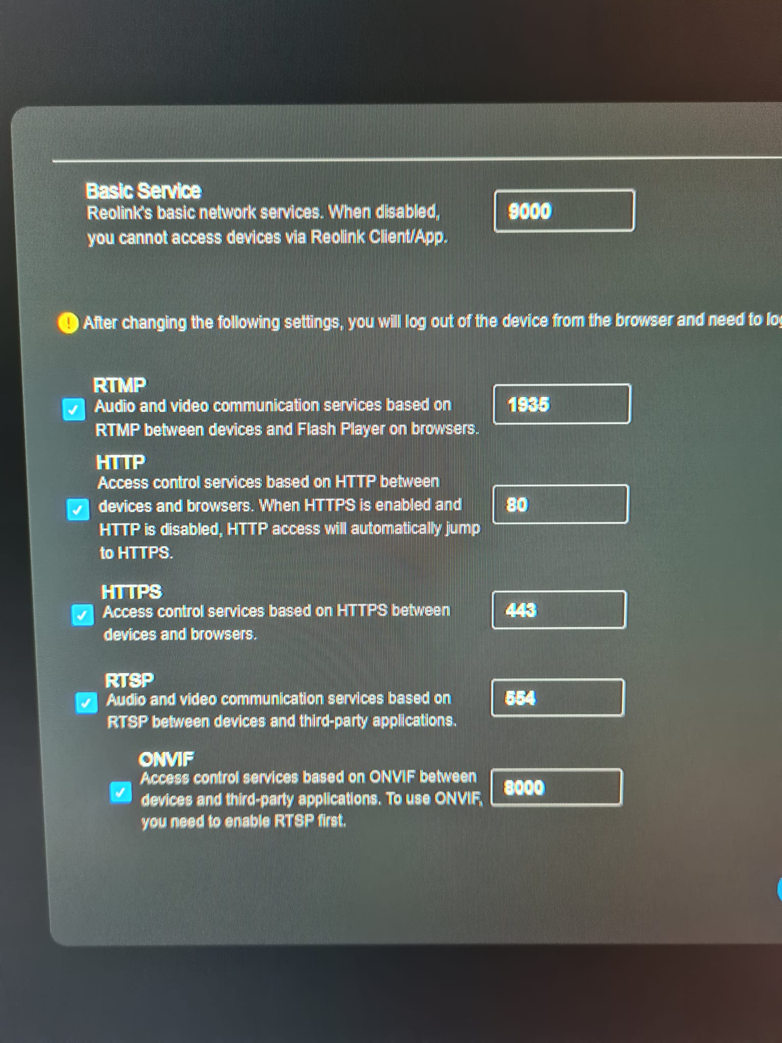

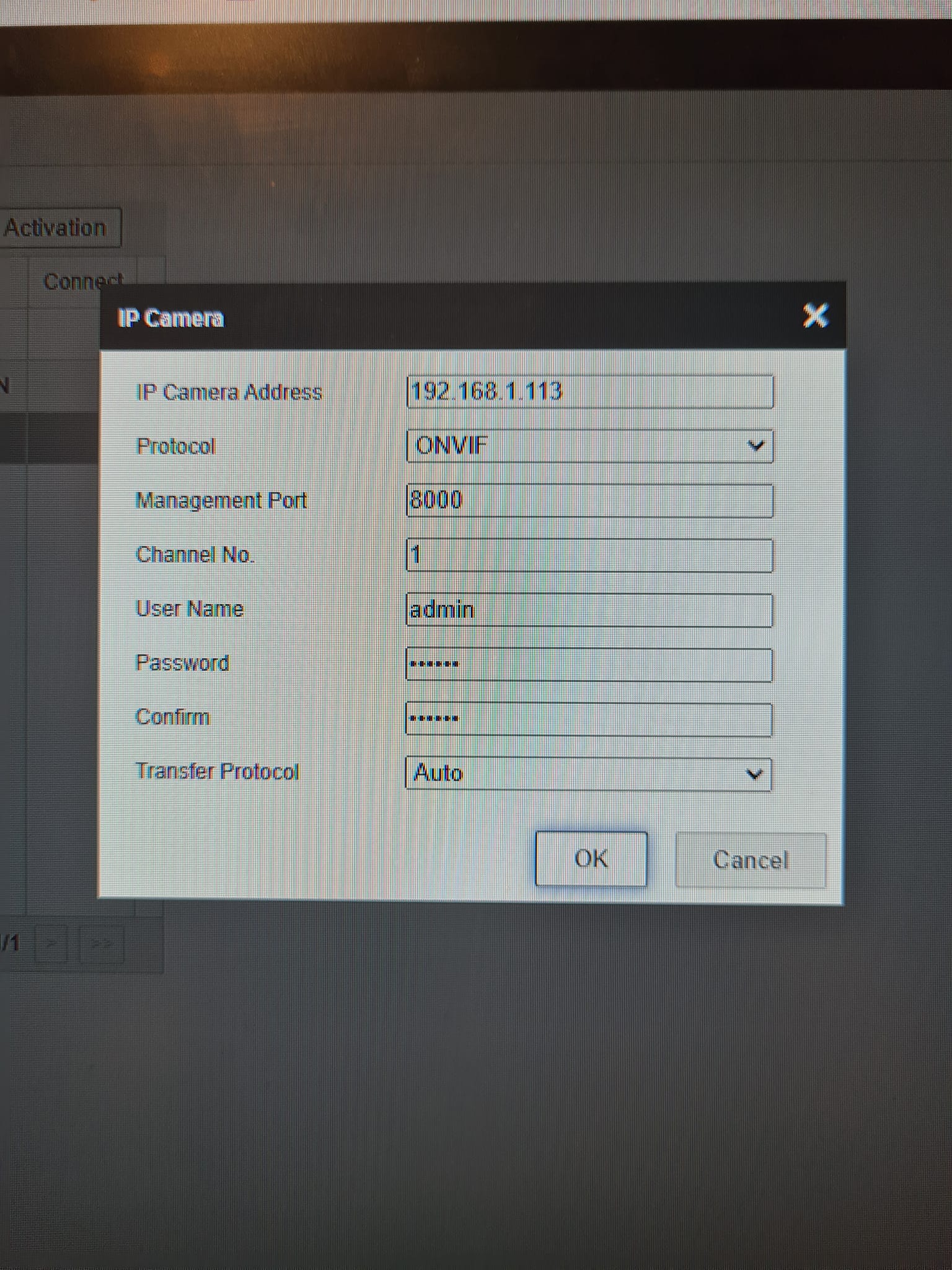

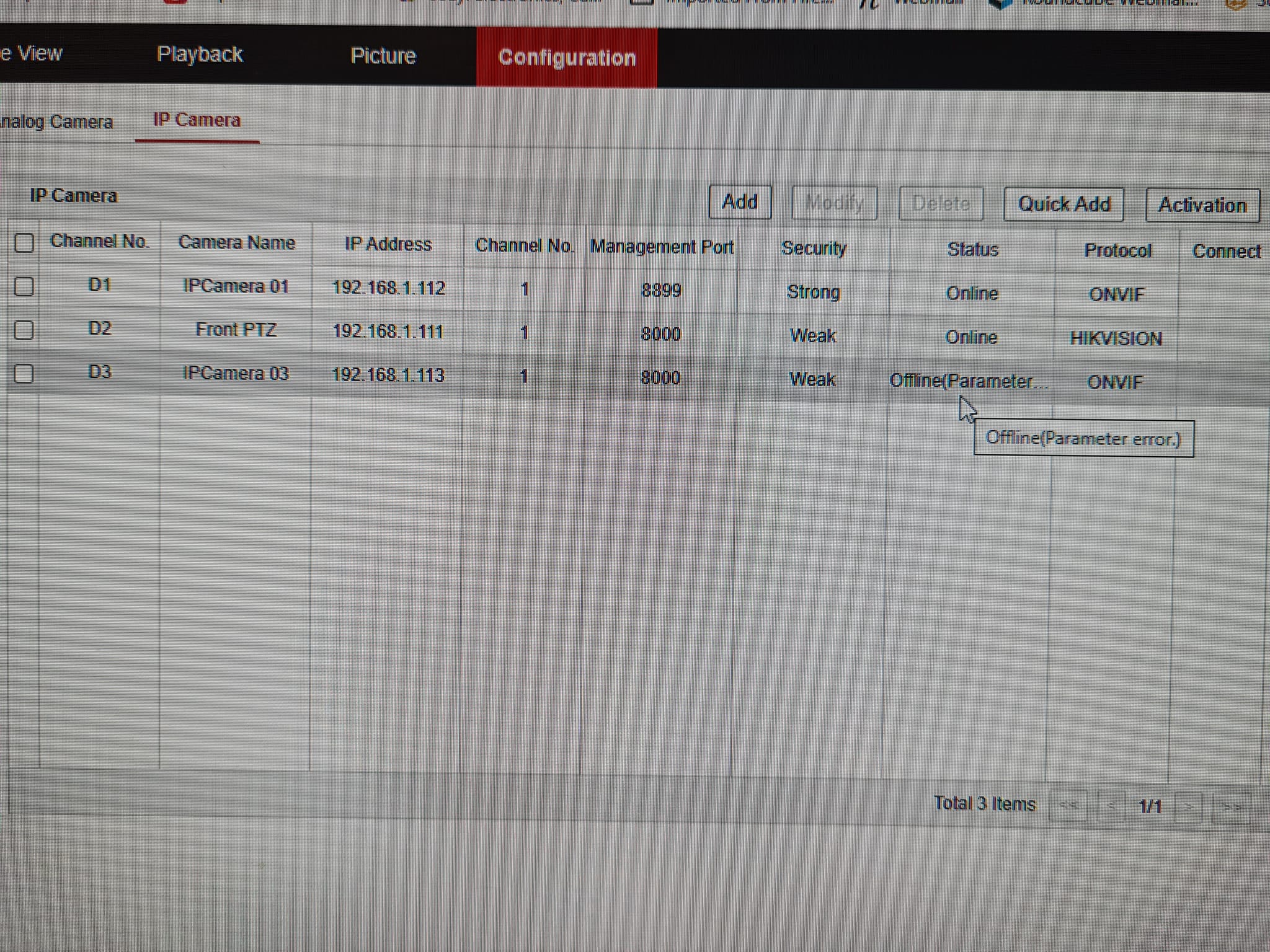

Trying to add a Reolink RTSP/ONVIF 2K doorbell camera as an IP Camera but getting Parameter Error from HikVision.

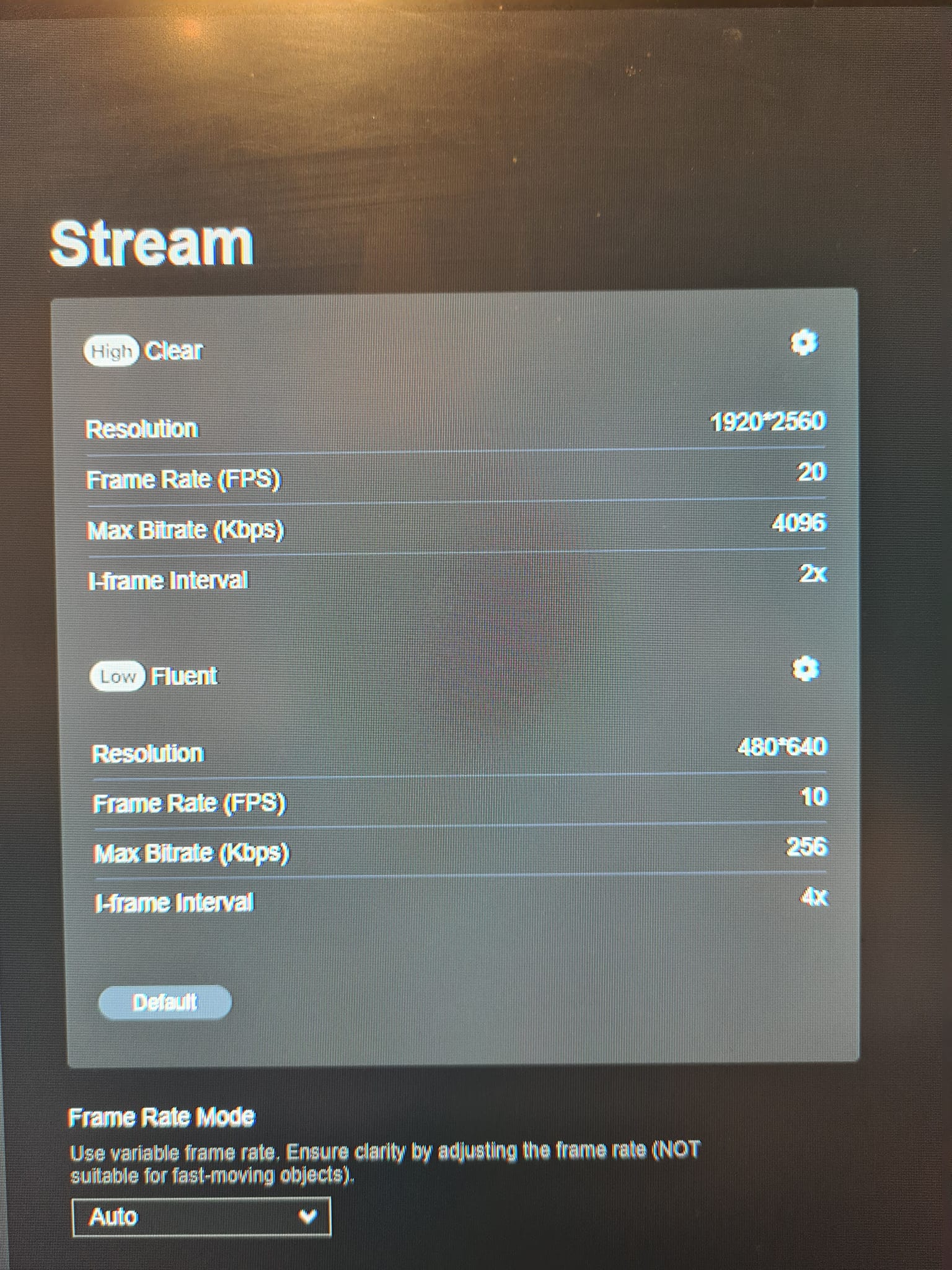

The camera resolution per stream is not changeable but it isn't unusual (Frame rate, bit rate and i-frame are all changeable though) and Hikvision won't allow me to add any different path to the low resolution if this could be the problem.
I can quickly and easily view the camera using rtsp://ipaddress from other tools such as VLC and TinyCam Pro just really struggling for hours with Hikvision.
