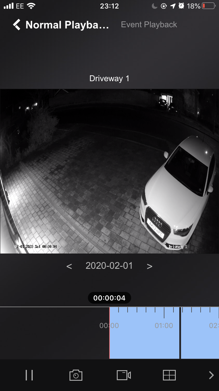

After digging a bit deeper, these “breaks” happen at least once a day, on 2 of the 2 cameras and have done so for many weeks.
NVR is a DS-7604NI-K1/4P(B) and the two cameras are 5mp and 8mp turrets. Firmware is up to date on the NVR, unsure about the cameras although I’m confident that they’re not the problem.
It appears the system completely restarts, and I’ll do some digging into the log files tomorrow to confirm, very frustrating to say the least.
I’ve read somewhere else that disabling UPNP could resolve, although that was suggested back in 2016! I’ve attached an example of what I see.

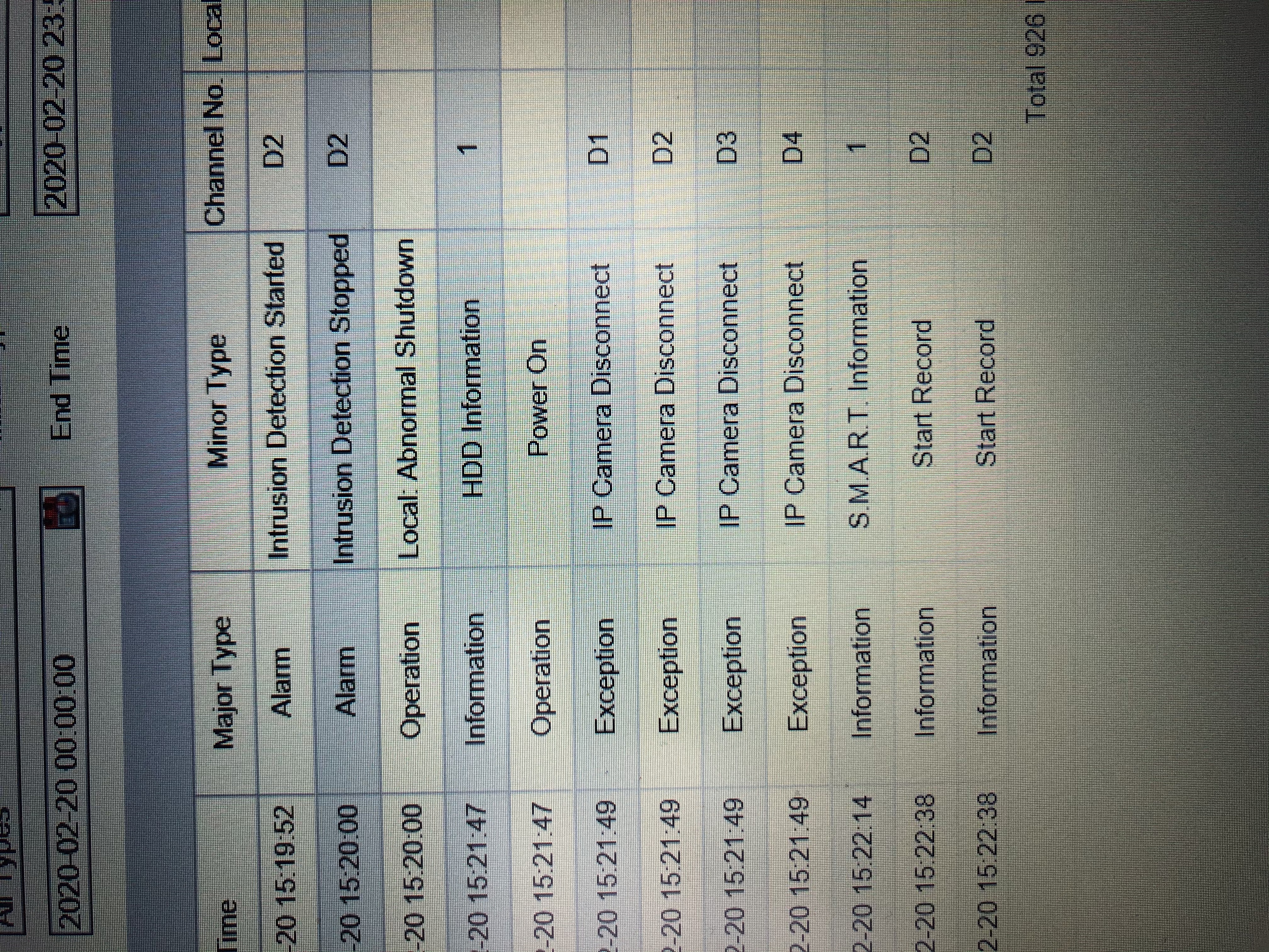

Just to add, I have attached the below log.
After doing a search it’s apparent I’m not the only one suffering!
I notice the shutdown seems to have been immediately preceded by an Alarm in that image.
Does that repeat? i.e. is it the case each time your NVR shuts down?
Do you have something wired to the NVR as an alarm?
I think that is a photo of your monitor, it's not easy to read.
Can you please capture a screenshot from your PC and upload it if you need to sahre more/again, thanks.

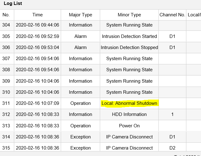

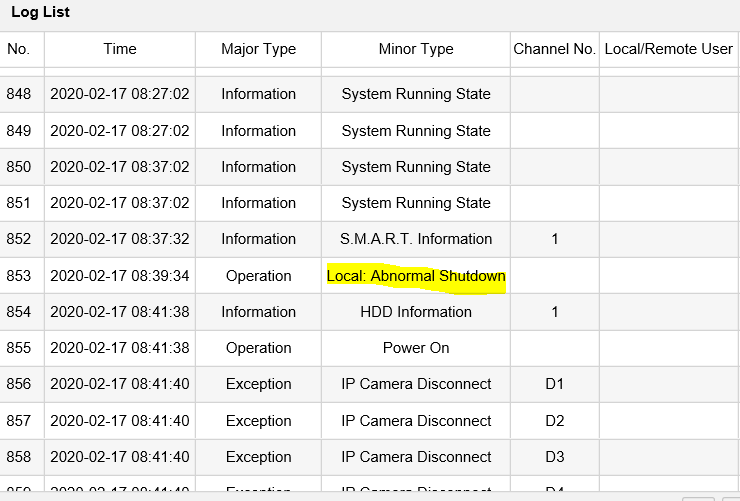

Thanks for the response Phil. You're right, I thought the same but after digging deeper I do have a few more examples that do not appear to be triggered due to alarm (see attached). I don't have anything wired into the NVR as an alarm.
My configuration is fairly straightforward. Contentious recording on both cameras, and intrusion detection on both so I can be alerted via Hik-Connect.
Could the attached logs rule out any HDD issues?
