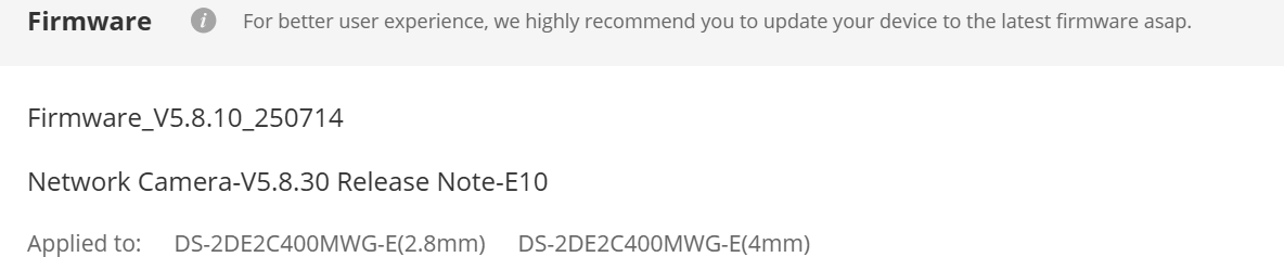

Howdy... Seems like a hardware issue, but you have two cameras with the same symptoms, so I would check that you are running the latest firmware... assuming you have the "Global EN" region cameras, the latest firmware is:
found here:
DS-2DE2C400MWG-E

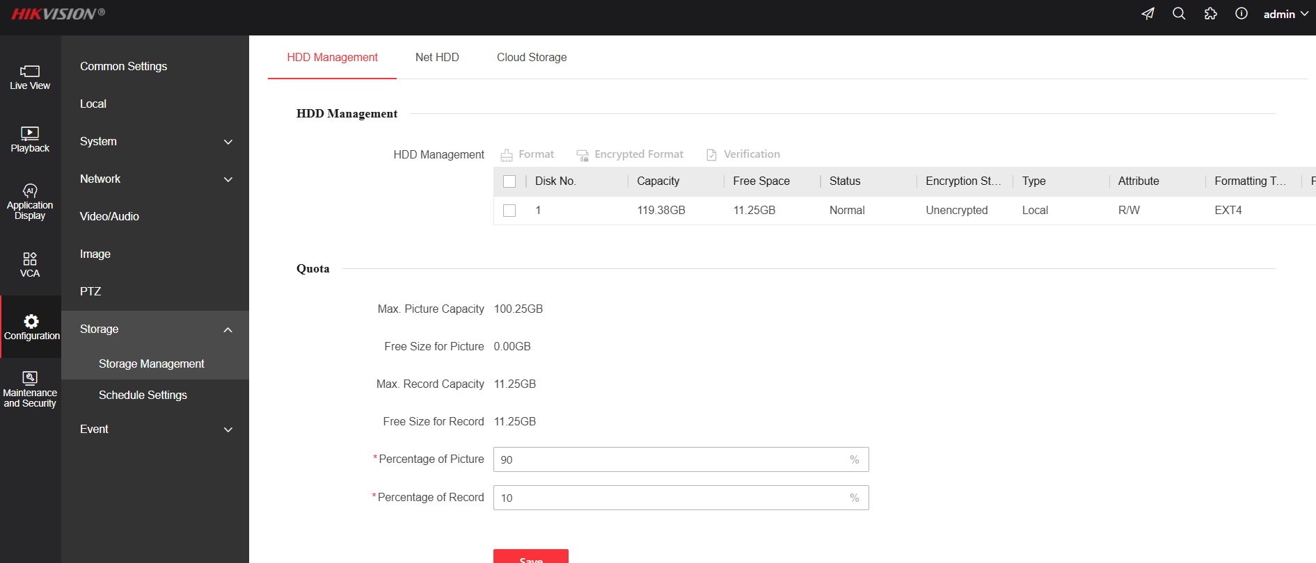

Try reformatting the SD card? What "Formatting Type" does the card have? Is the card encrypted?

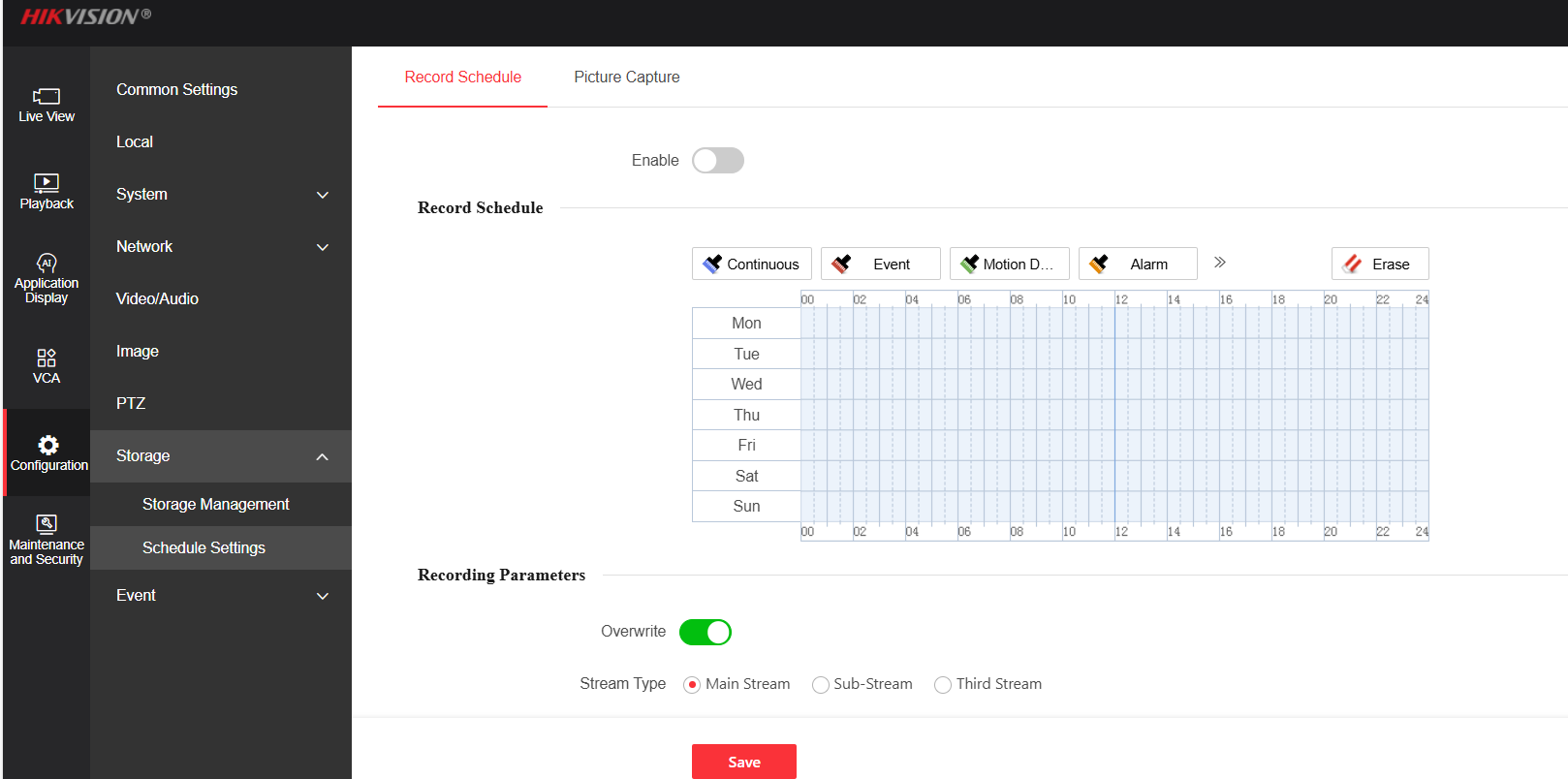

What record schedule are you using? Is overwrite checked?
Tryed formatting the SD card. Encrypted format is turned of. The cameras record on continuous mode 24/7.
