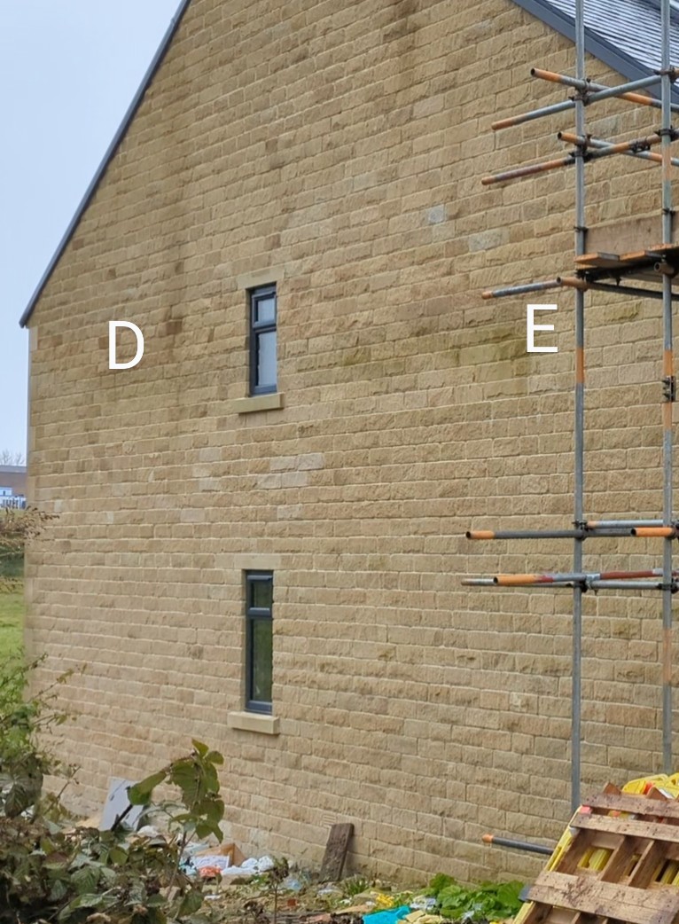

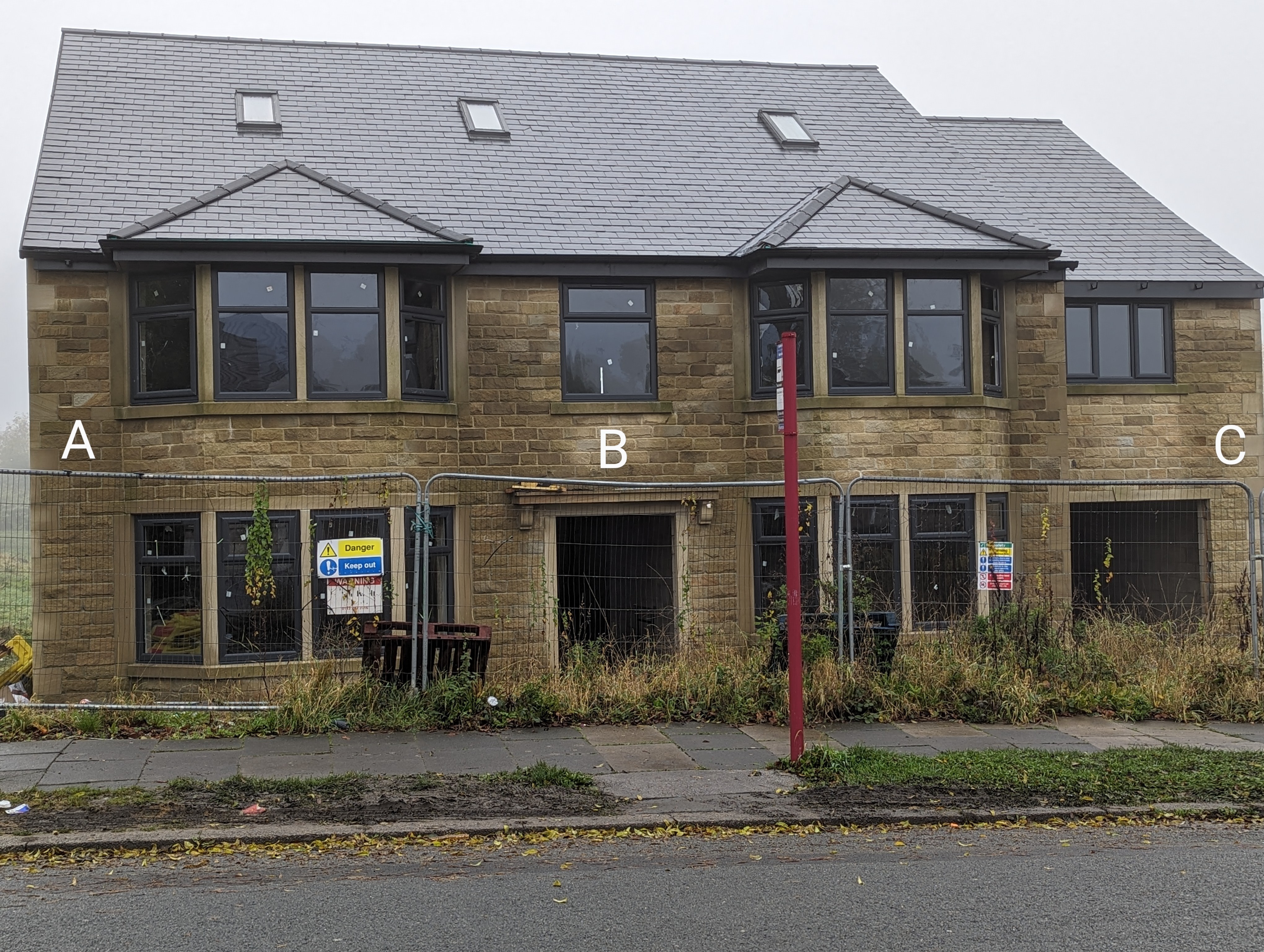

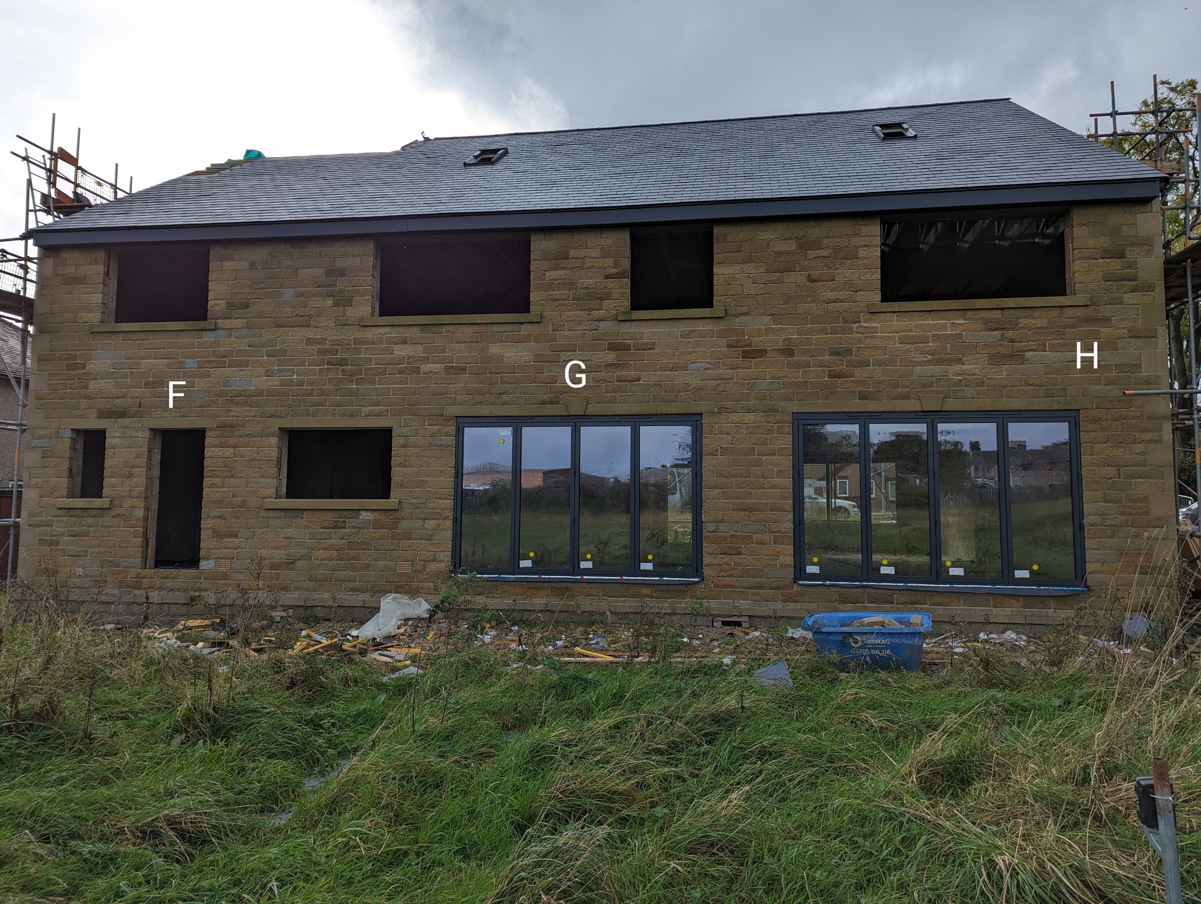

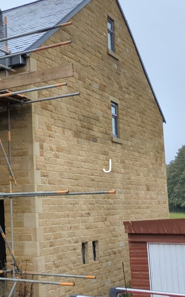

We're planning our CCTV system for our new self build house.
Considerations:
1) Detached house with large side garden 25x20meters on one side with trees around the boundary
2) Back garden is 5 meters with large field at the back with public footpath.
3) Front garden is 6 meters to footpath/street.
4) The front door is half a meter lower than the footpath.
5) Busy (traffic and pedestrians) street throughout the day.
Please see attached photos. We seek some advice/suggestions for the best camera locations.
Furthermore, would POE be the most appropriate system?
Any advice is highly appreciated.

Front of the House - Position B is fine for covering the front door and position C is roughly okay for covering the garage and drive.
Sides of the House - One camera on each side of the building, probably positioned something like position D and angled to look back to the front of the property (assuming that the most human activity down the sides will be people walking from the front to the back of the property).
Back of the House - Positions F & H, one camera positioned to look along the back of the property and the other positioned to look out across the back garden.
With the areas you need to cover, 6 cameras should be enough.
