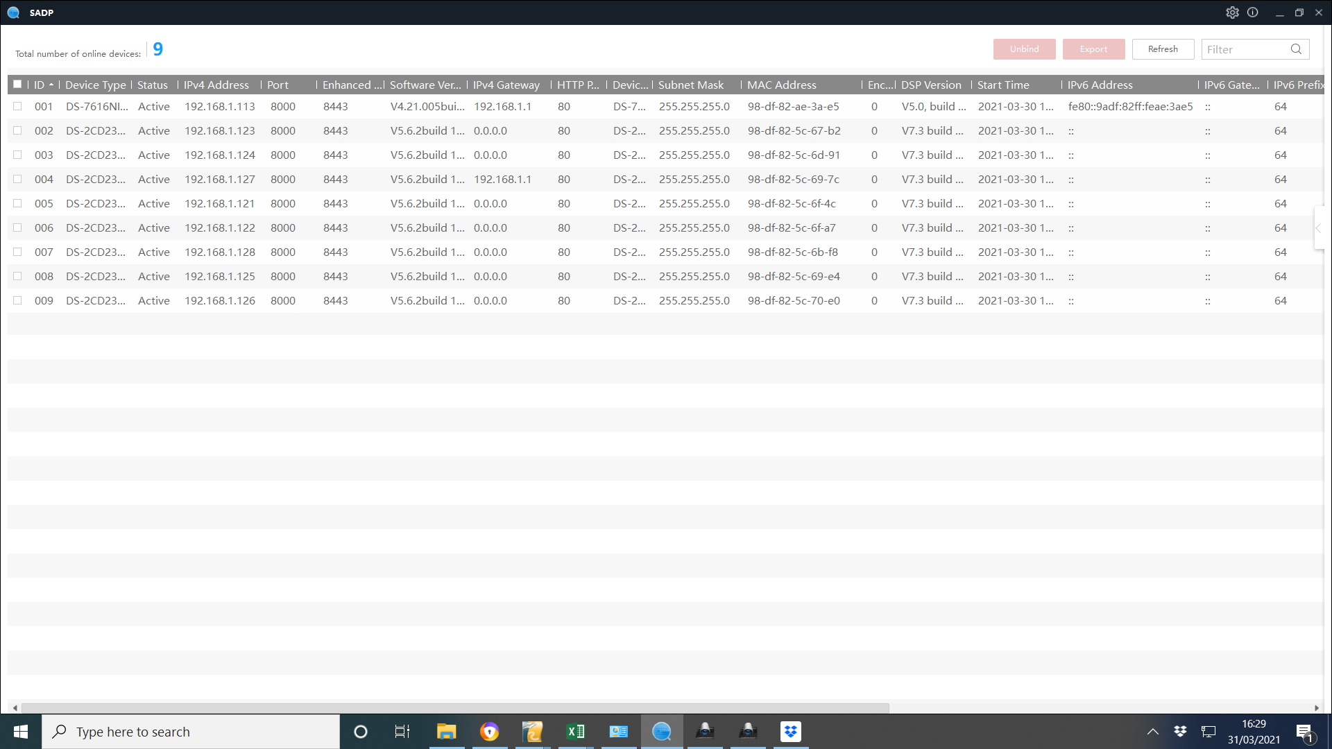

Hi Phil
Screen shot below. Thank you for help

Hi @Ruttla
The issue is likely IPv4 Gateway address which on the majority of your cameras is not set to anything (0.0.0.0)
You need to follow the steps in the below forum guide to confirm what your IPv4 Gateway address actually is:
If the gateway is 192.168.1.1 (which you currently have 2 of the devices set to) then you should set all the cameras and the NVR to that gateway address, if it comes out that the IPv4 address is completely different, then you will need to change all the IPv4 gateway address to match.

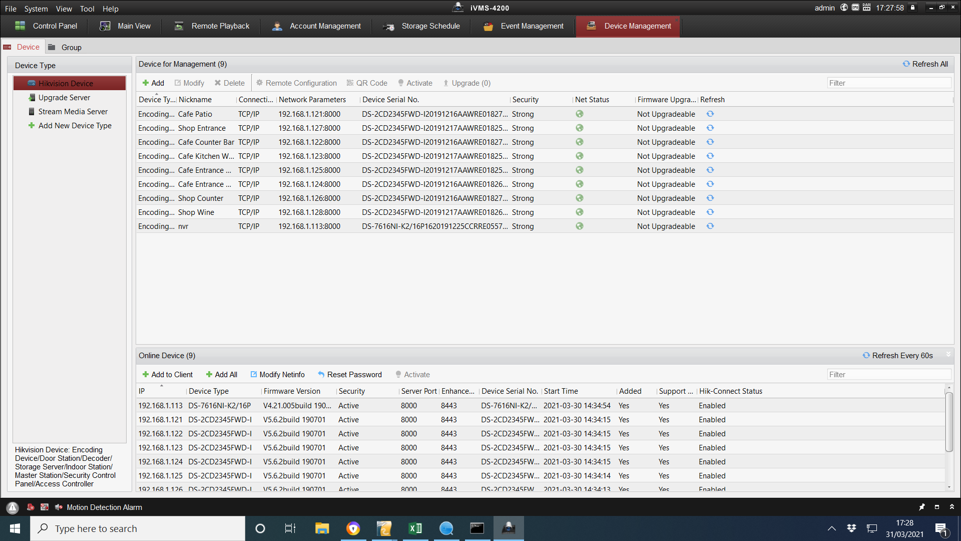

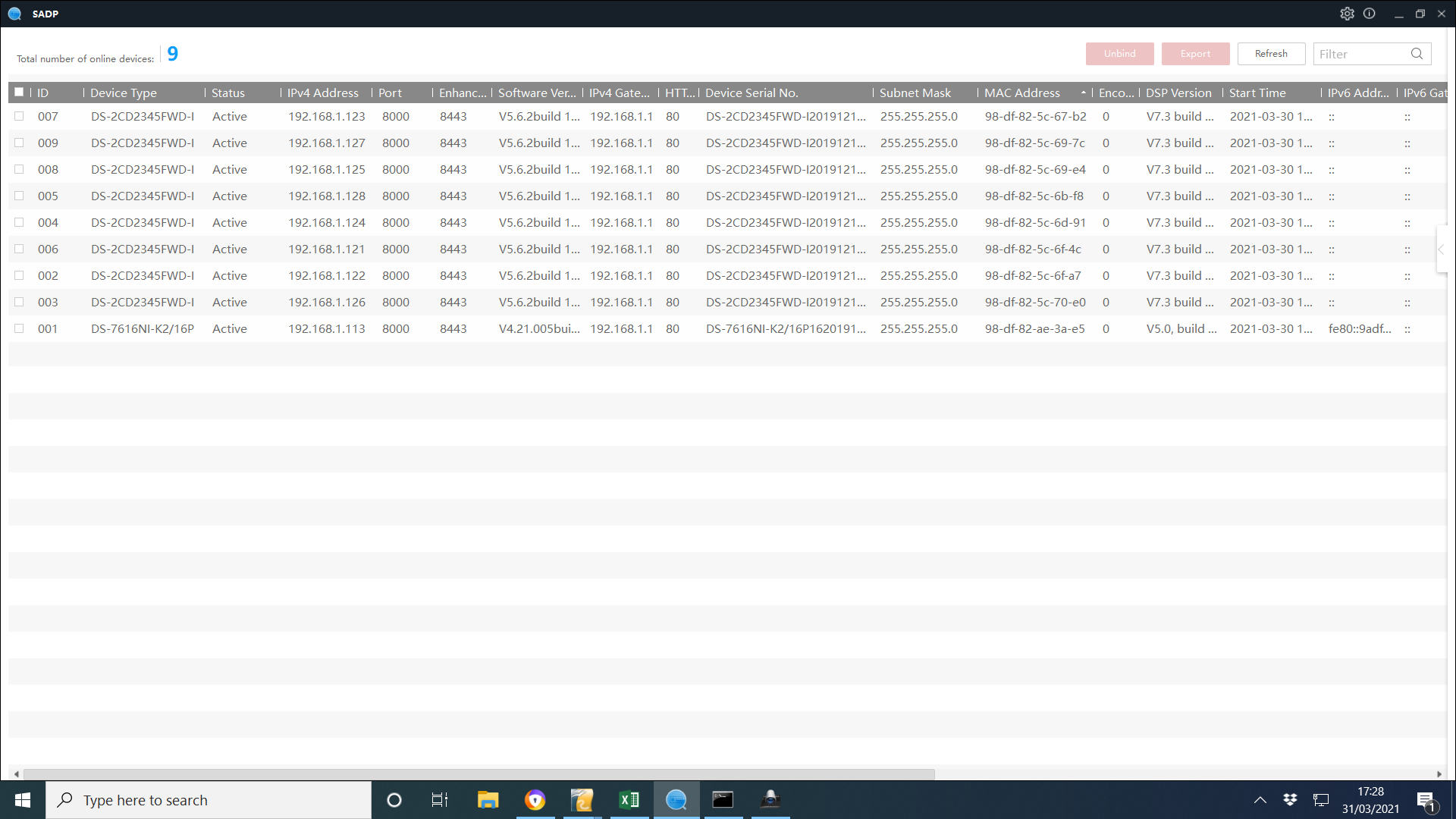

Hi Dan
I have altered the ipv4 addresses as recommended, using the SADP tool. However, I still cant remotely log into the NVR. It does appear though that I can now play back footage using the iVMS-4200 program. Although its a sketchy, sometimes i get error messages. I also still cant remotely manage the nvr/change settings. Screen shots below.
Thanks for your help

Within iVMS what happens when you select your NVR in the device list and click the "Remote Configuration" option at the top of that list?
There are two things it could be that I can think of:
1 - If something else also has the same IP address on your network - that will cause it. Depending on the router you may be able to check the connected devices there. If not just pull the network plug on the NVR and ping 192.168.113 - if you get a response then something else has that address. Of course not all devices are guaranteed to respond to a ping so you could just try changing the IP of the NVR to something different and higher in the range (192.168.1.250 for example)
2 - Reconnect the monitor and in the menu go to Maintenance > System Service > System Service and make sure that the http service box is checked/enabled. Without that box checked the web server is disabled on port 80. You would normally only disable the http service if you wanted to enforce the use of https
