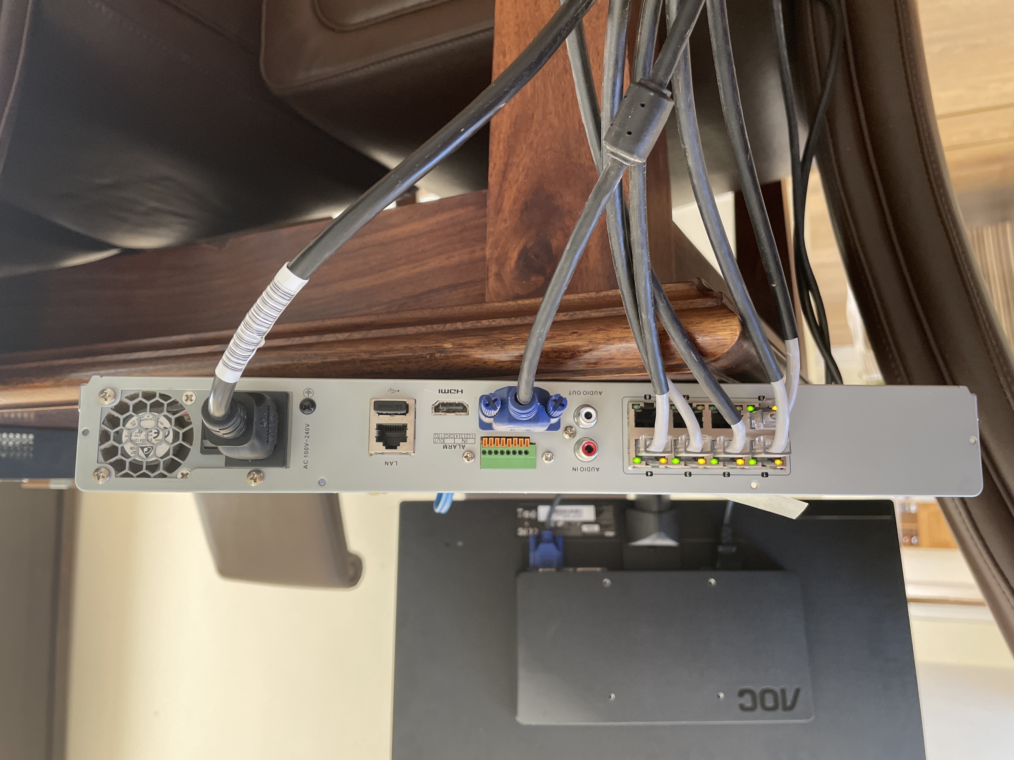

I’ve downloaded the hik connect app and tried scanning the QR code on the back of the NVR but of course the device is already registered to the previous owners acct. They are not responding to requests to unbind the device.
I tried the red ‘unbind device’ button in the app but it says “network exception….pls connect device and phone to same LAN”. I assume this means the house’s wifi? Of course we have just moved in and had new broadband set up they are not on the same network.
The previous owner had turned the system off and taken the power cables for the NVR and monitor but we got some others and turned it on and can see all five cameras working on the monitor but can’t access it on the app and can’t change anything. Any more worryingly the previous owner presumably still has access and can look at our camera feeds?

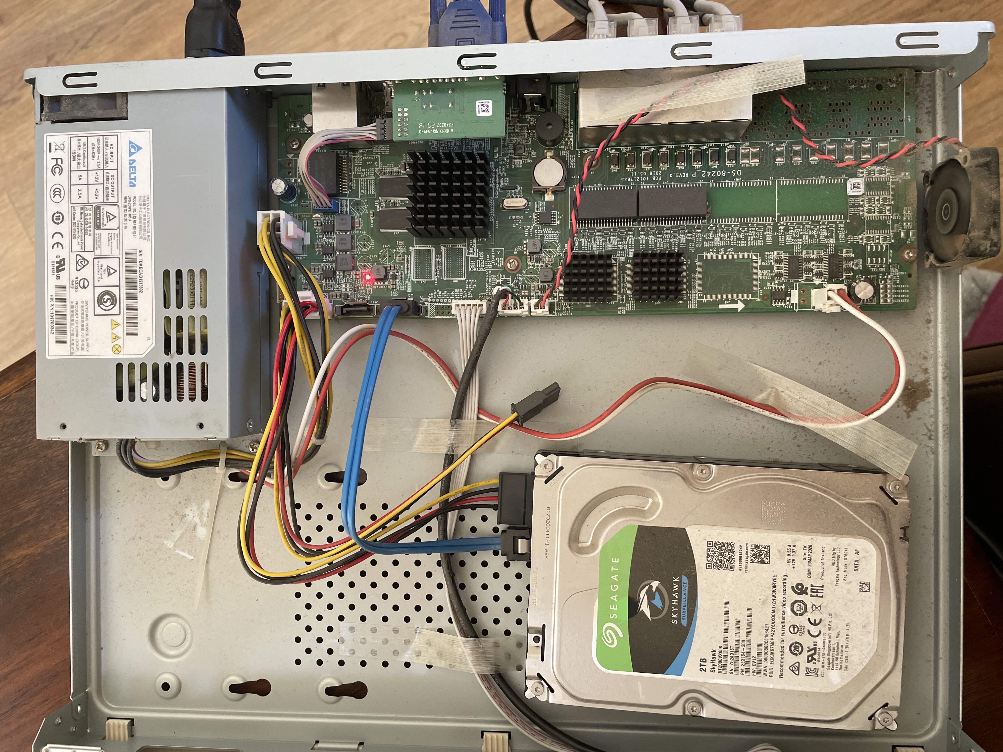

I did some Googling and found out about doing a hard reset on the NVR by pushing a button but I cannot find a reset button anywhere. I have taken the cover off the NVR and cannot see it.

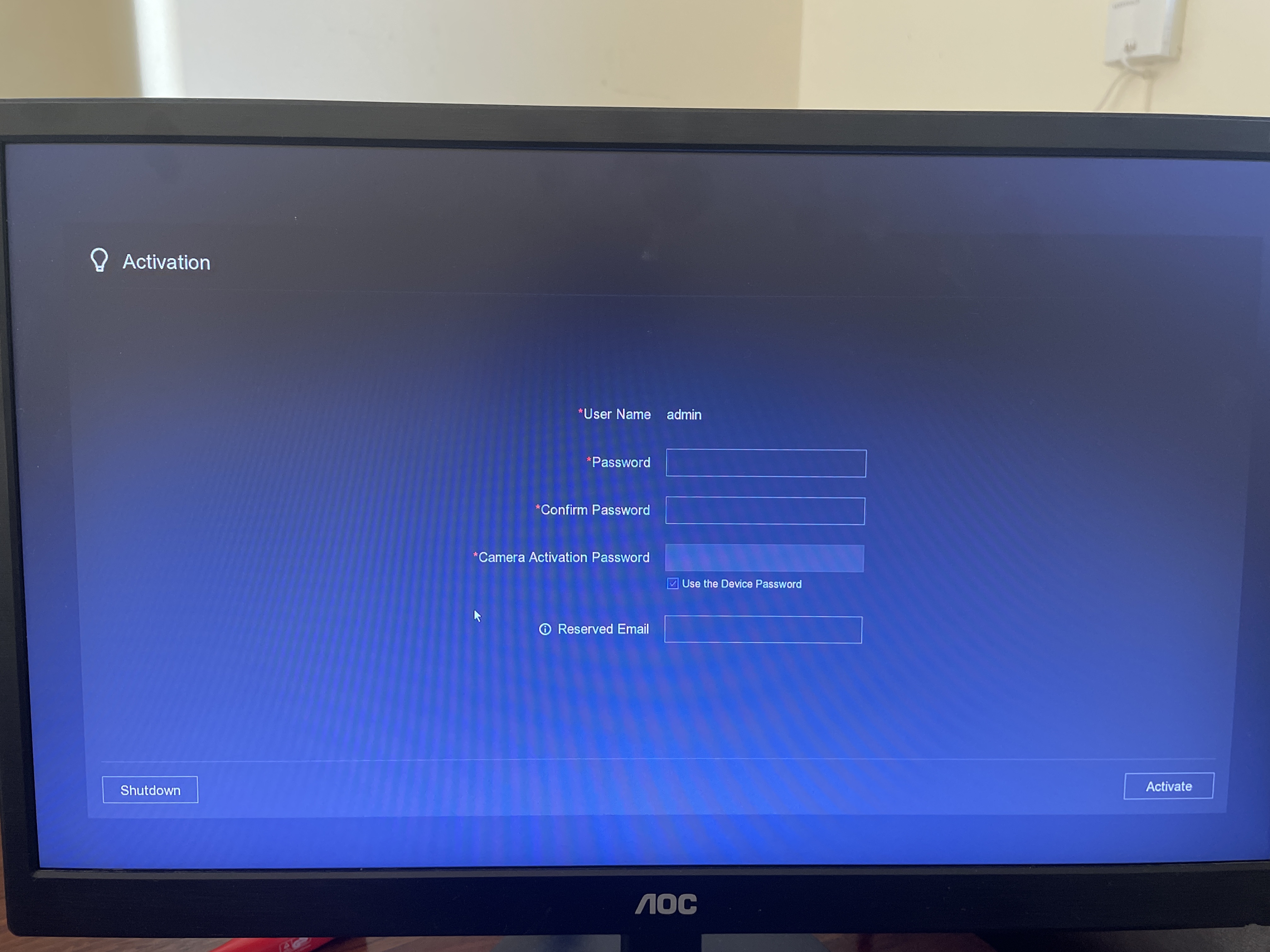

Now for the bit where I’m sure I’ve gone wrong - I was looking around the menu options on the monitor and tried ‘factory reset’ (or something similar). The screen went blank, there was a beep, everything rebooted, but now I have a screen called ‘Activation’ requesting a password that of course I don’t have so now I’m stuck.
That screen you arrived at is the activation screen so you've successfully reset the unit and the password it's asking for is a new one that you create (not the old one that you didn't know). The only issue will be that you don't have the original password and that will be the same in the connected cameras.
So you can create a new password on that screen for the NVR, but the cameras will not recognise that password and will need to be reset.
I'd have to disagree to some extent that it's an old worn out system. While we cannot see the model number, the activation screen indicates that it has relatively recent firmware loaded (V4 as opposed to V3) and may still be updatable. The hard disk has a May 2020 manufacturing date so will have been fitted some time after that.

Apologies @s_mobee that was me being lazy/distracted this morning.
I scanned the original post and thumbnails but didn't see that last section about resetting from the direct monitor and didn't open the display thumbnail so thought it was just the login page.
AS JB says, you have successfully reset the NVR and can reactivate the NVR with your own password, but this will only reset the NVR password and the cameras will likely still be using the old password and would need to be reset if you wanted to access any camera specific settings or update camera firmware.
JB is also correct that the system is probably not super old, but what I meant by 'worn out' was that internally it looked quite dirty/messy but if you give it a good clean it should continue to work fine.

You were right and I could set up my new password and can now access everything on the NVR monitor.
As predicated though the cameras have now lost their link. Does this mean I now need to hard reset the cameras individually? I’ve taken the back off the easiest one to reach and found the reset button. But everything I’ve read online says I also need to disconnect the power supply. How do I do that? The cameras just have one black cable that go straight to the NVR. Do I just unplug that?

Yes the cameras will have to be reset. Your cameras are PoE so are powered using the network cable. Usually when I'm resetting cameras I'll remove it and use a 12V power adapter as follows:
  • Press and hold reset button
  • Apply power
  • Continue to hold reset button for 15 or so seconds
  • Release button
I've not previously done the above using the PoE connection at the camera but it certainly won't do any harm to try:
  • Disconnect the network cable
  • Press and hold the reset button
  • Reconnect the network cable
  • Continue to hold reset button for 15 seconds
  • Release button
That should reset it. Wait about 5 minutes and if the image comes back all is well. If it still does not come on after 5 minutes go to the recorder and unplug the camera that you've just reset and swap it with another. The NVR will see a different camera on the port and hopefully activate it with the same password you just created.
