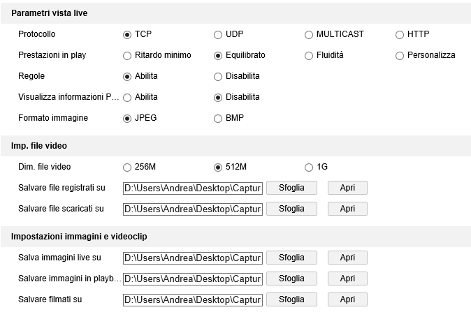

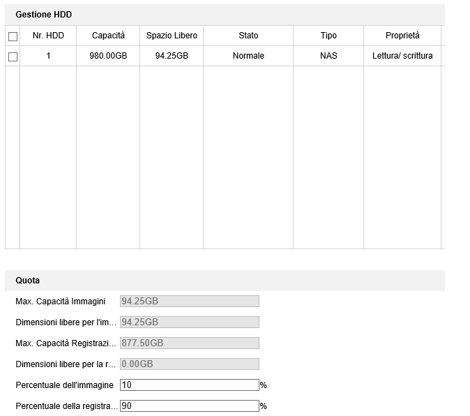

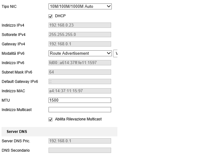

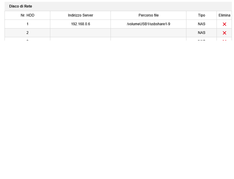

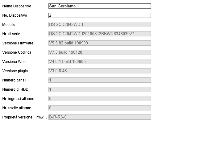

Attached some config.
What should I check?
Please, help me!!!

Are you saying that when you run Edge / IE as an administrator you cannot download to a folder / file within the C: Drive of the browsing PC?
Exactly.
Furthermore I can neither record locally from Live view, nor capture a screenshot.
