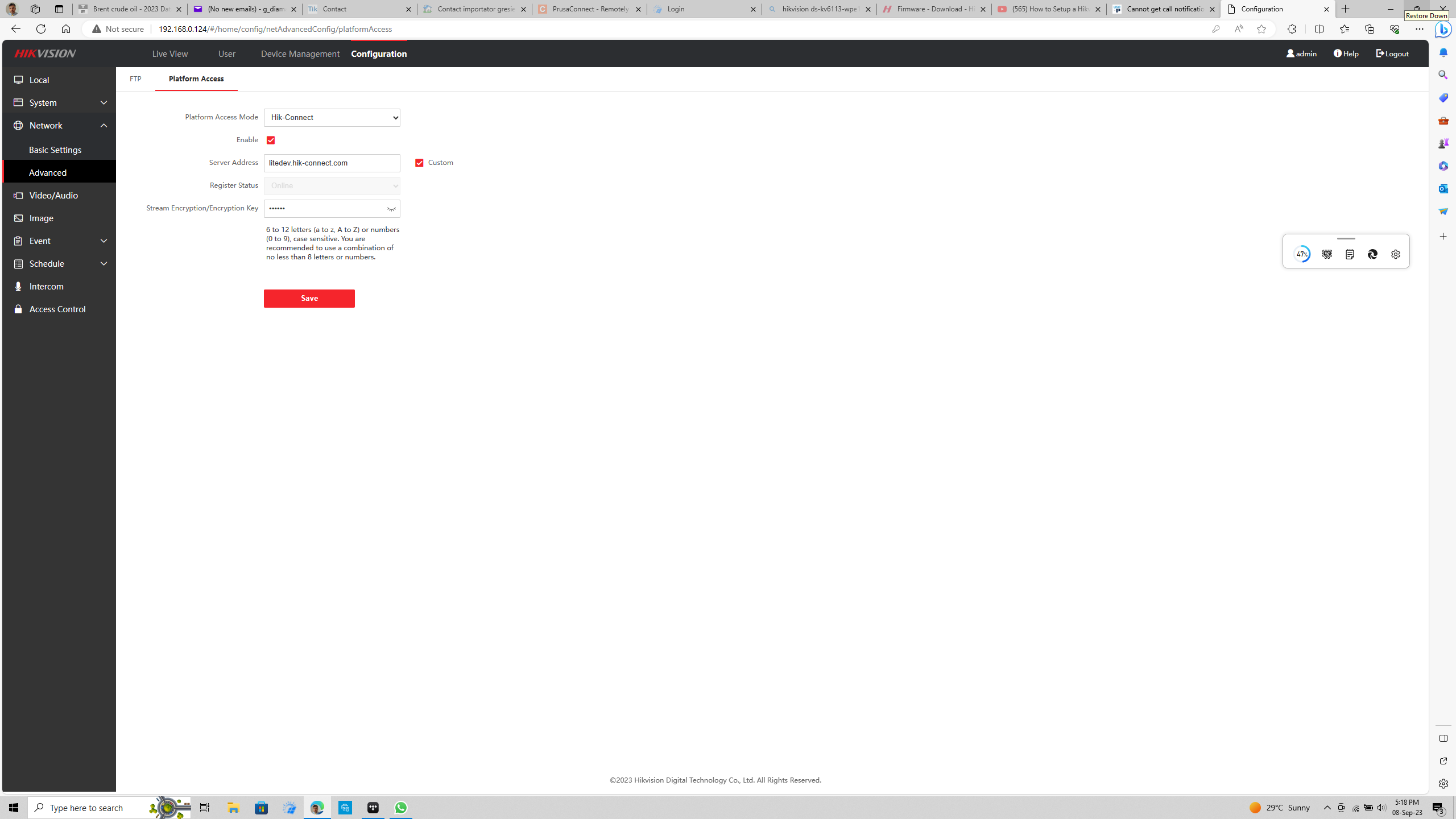

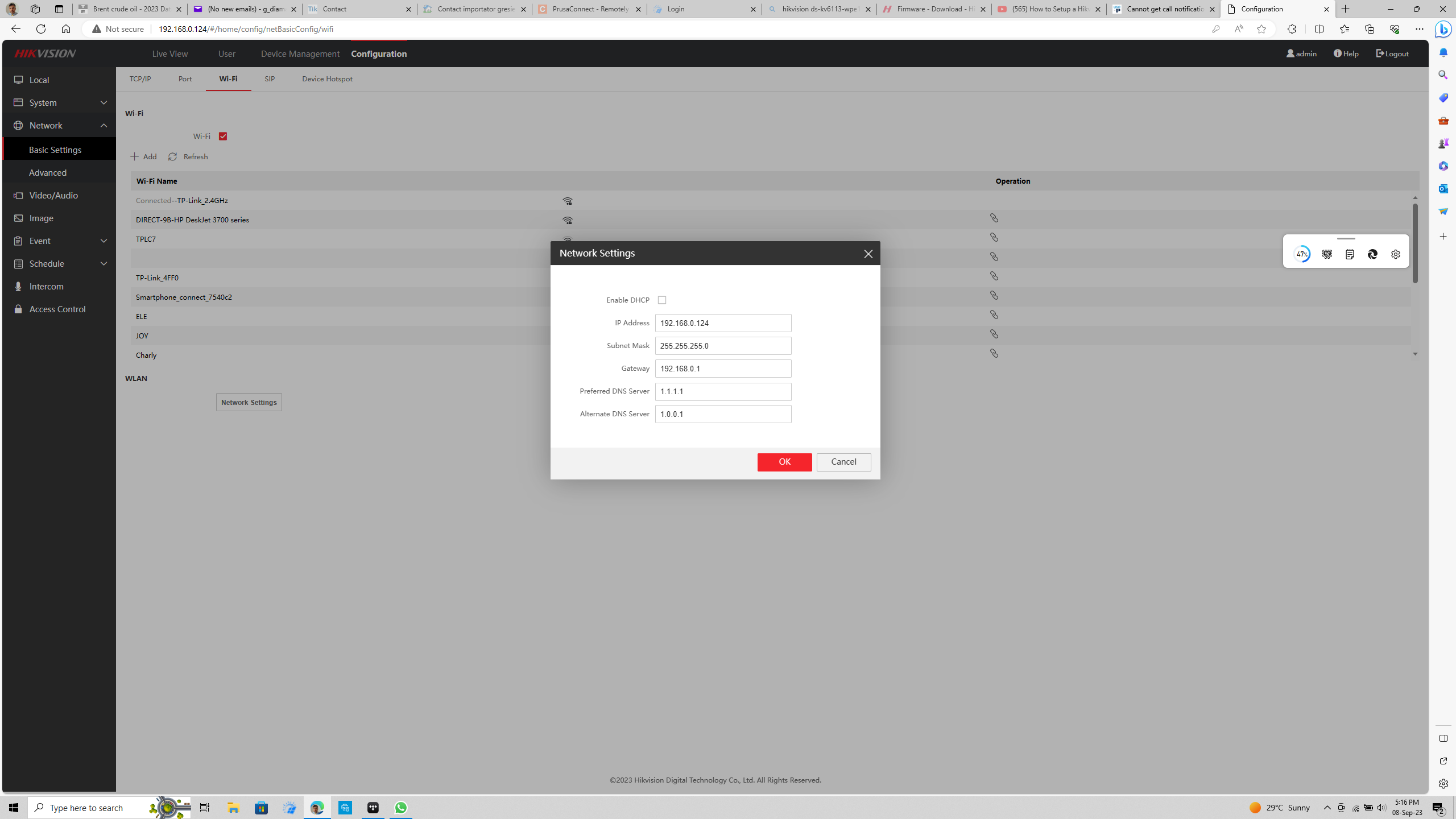

There’s little information to go on. Screenshot and post the network settings page that shows the IP address etc and also the platform access page that shows the Hik-connect status. How did you add the device to your Hik-Connect account? If you added it by ‘online device’ that could be the cause, but I’m guessing without further details.
Indeed, I added the device via "online device" method. Thought about it and tried the QR or manual (serial number) but strange enough the Activation code as printed on the back of the device was repeatedly rejected as wrong.
View attachment 9755 View attachment 9756 Indeed, I added the device via "online device" method. Thought about it and tried the QR or manual (serial number) but strange enough the Activation code as printed on the back of the device was repeatedly rejected as wrong.

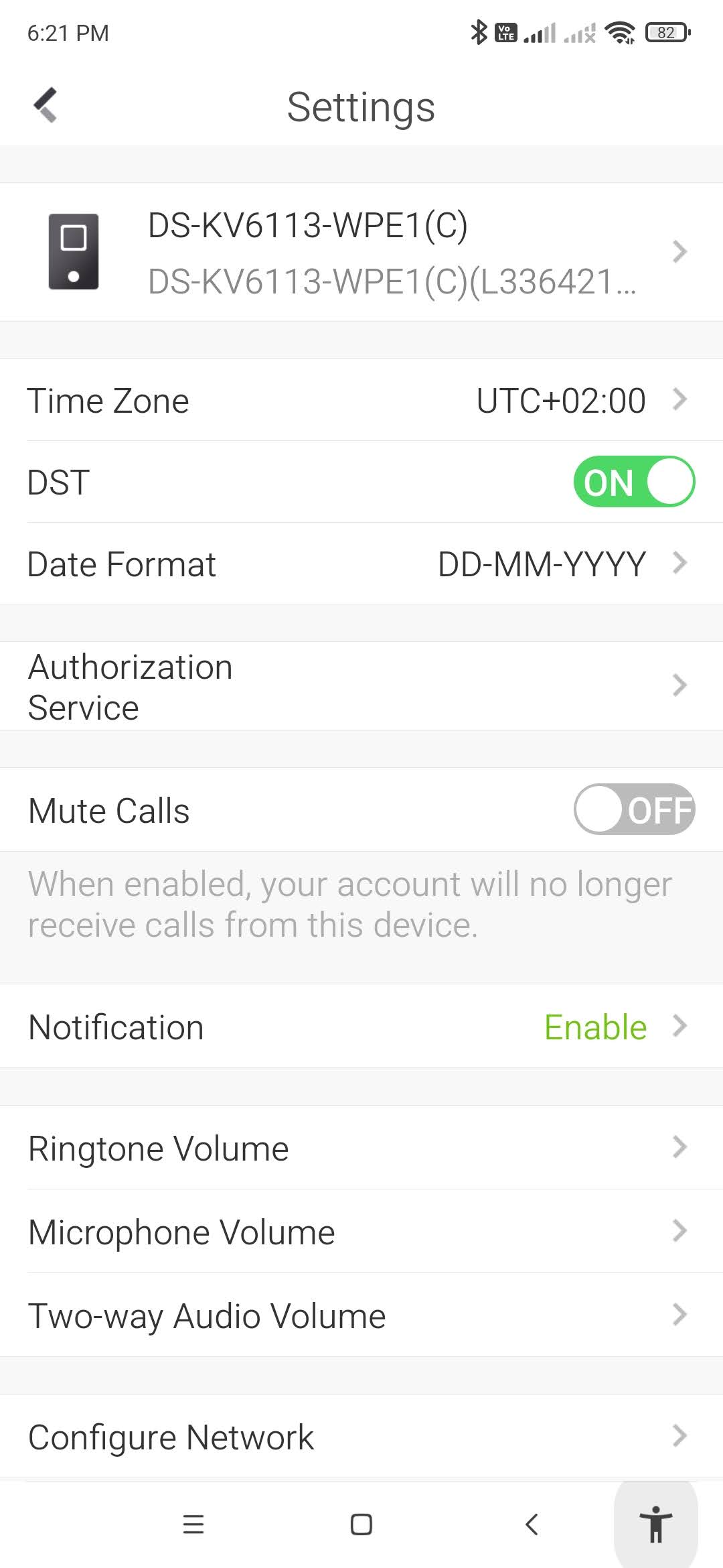

Strange. I don't suppose you have the 'mute calls' switched on in the settings for the device?
Mute Calls is 'OFF'. Unlike your print screen my Notifications are set to 'Enable'

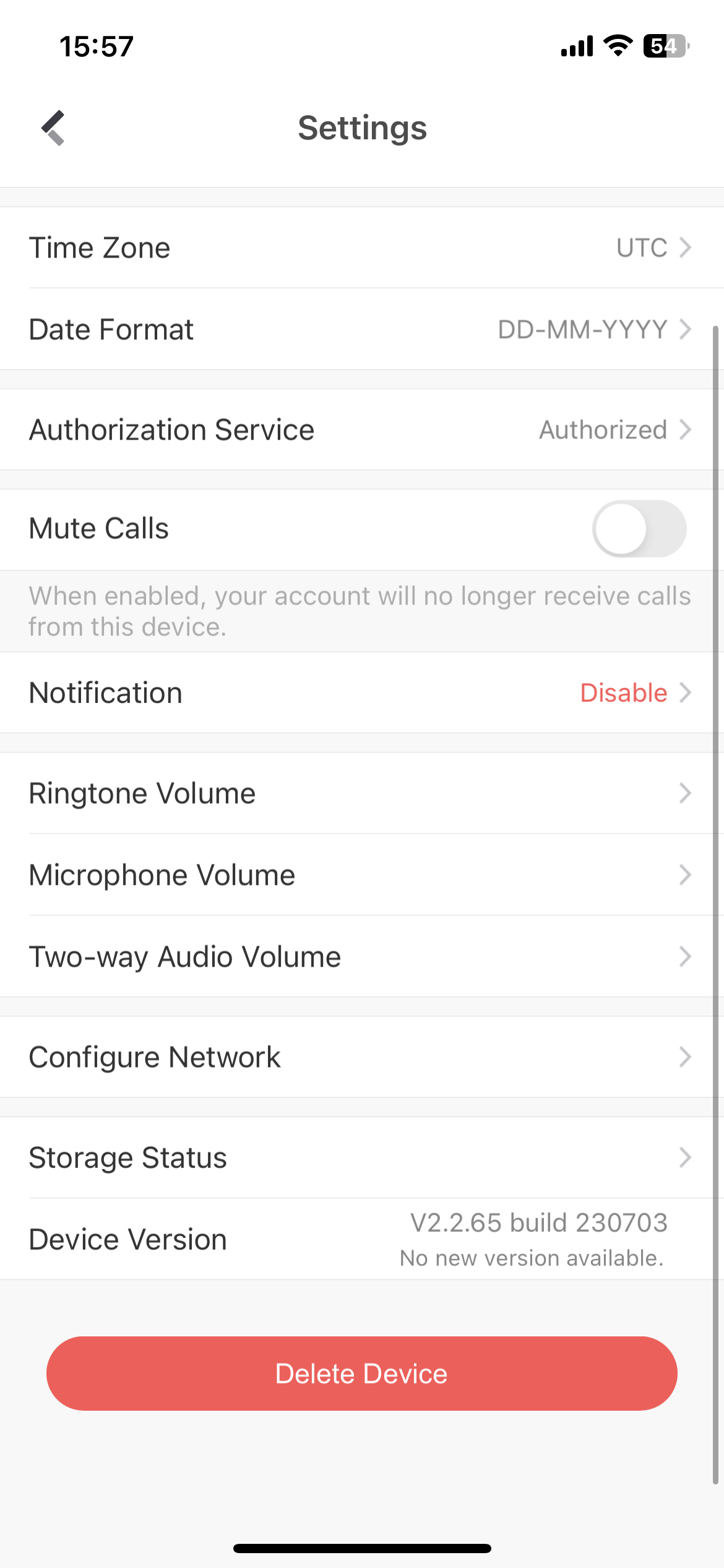

I can't fathom how mine works with Notifications disabled as shown in my image. I noticed that it was set to disabled the other day and it's always been that way.

No that's normal. The top entry is the friendly name, the second entry is the devices actual name. When you add the device it's name is assigned to the friendly name automatically but you can change it - mine is just 'Doorbell'

192.0.0.65? The IP address of your unit was 192.168.0.124 as shown in your earlier screenshot. 192.0.0.65 is unreachable because it is on a different subnet to your home network.
On a PC use Hikvisions SADP tool. It should discover your device at its current IP address. You can then change the address back to 192.168.0.124 and enter your admin password to confirm the change.
