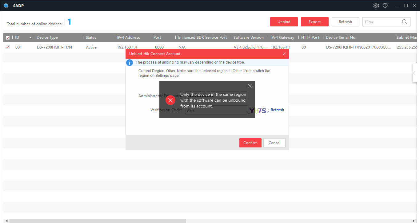

i have a same error, what can i do ?

Take note of the words behind the error message with regard to setting the region to other.
Download the latest version of SADP (V3.0.2.4) from here:
See the attached Release Notes on setting the region to other, and then try again to unbind.
Upvote 0

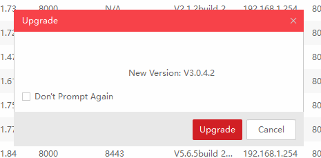

Despite the above version being THE newest I could find at the portals, when I installed it and allowed it to check for updates it then found a newer version V3.0.4.2 which I have now installed (and it does seem to be THE latest).

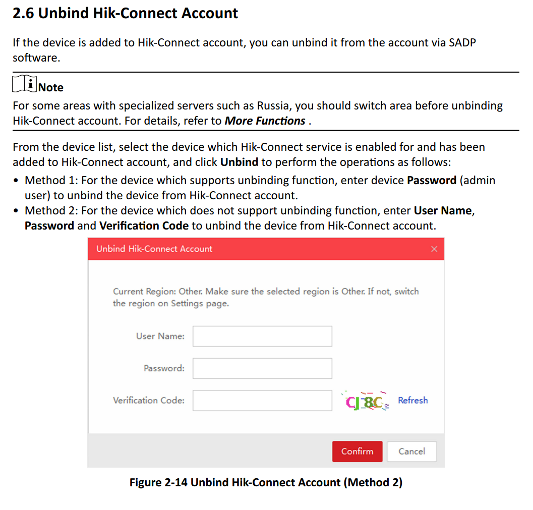

From the user manual for that latest version (attached), here are the unbind instructions:
Upvote 0

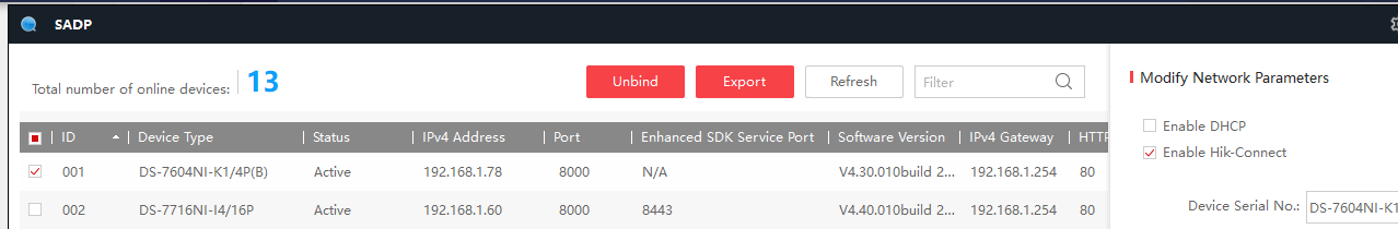

Top-centre in SADP:
(Make sure you put a tick at left side for the device you wish to select)
Upvote 0
