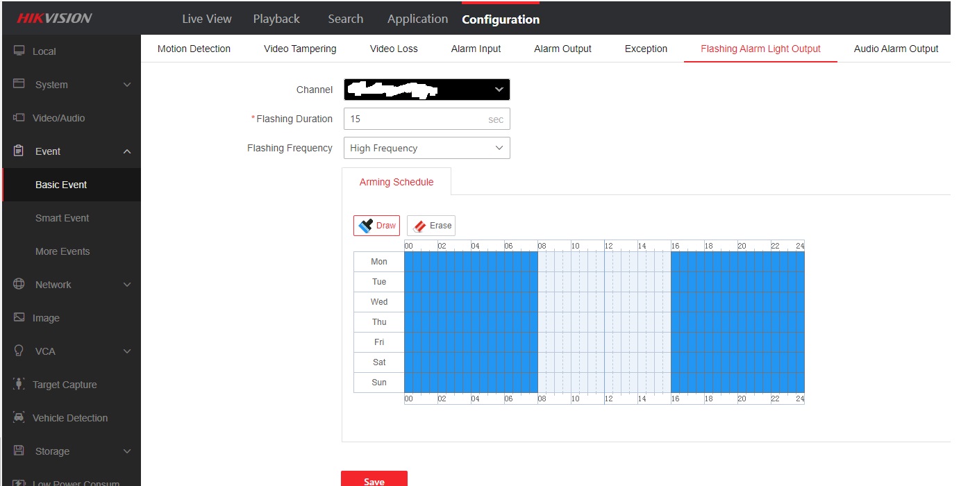

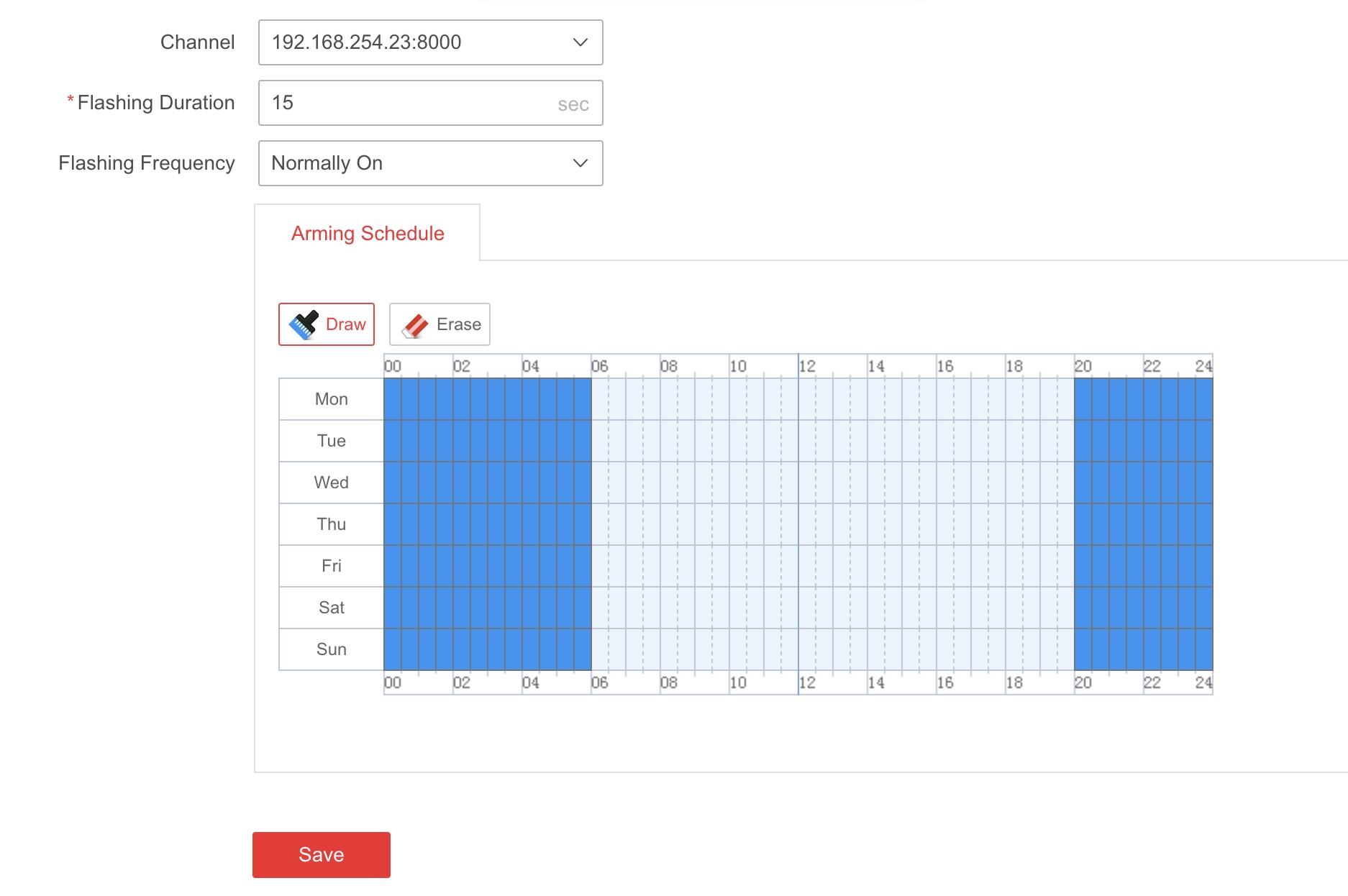

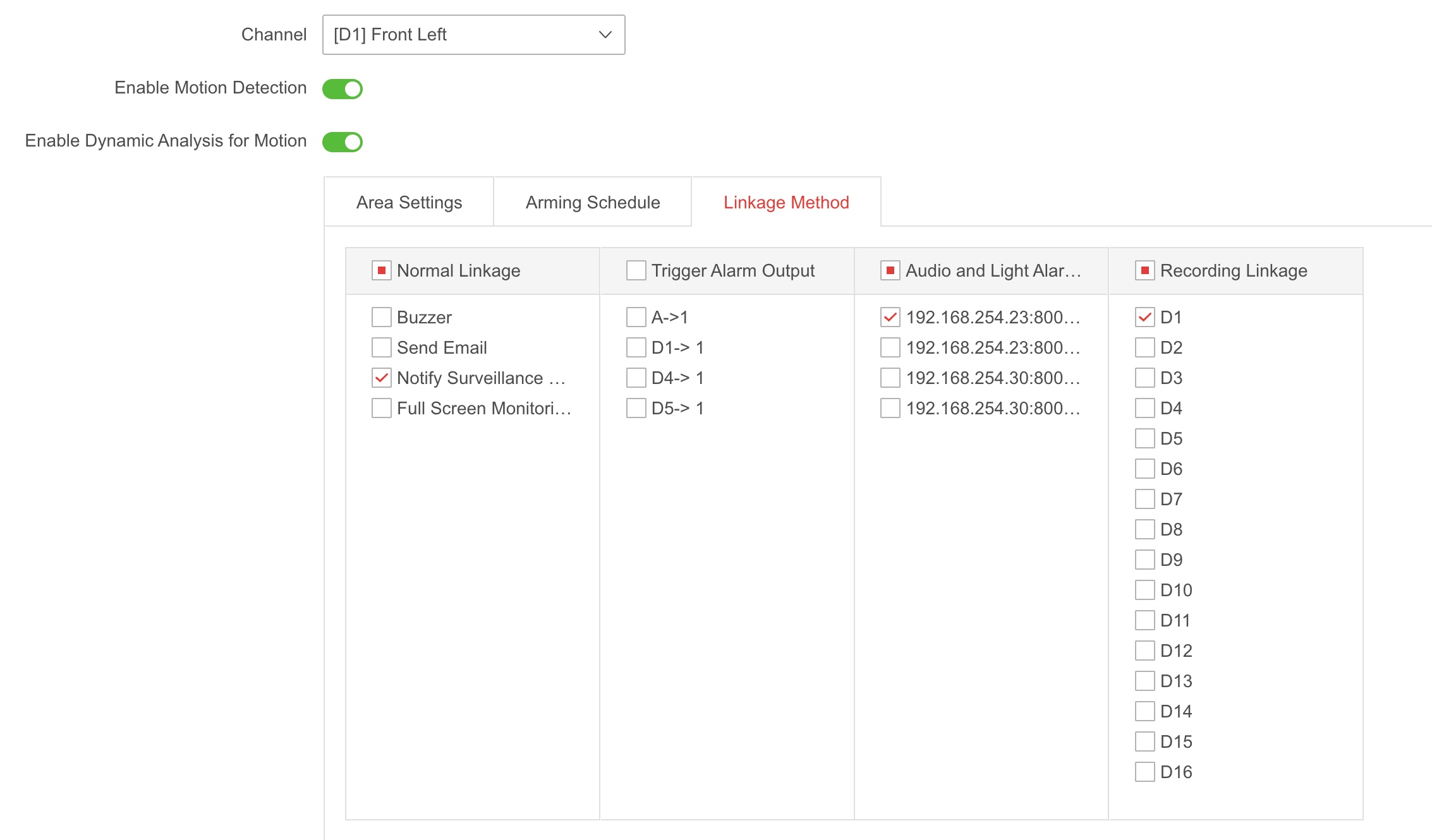

I have set up linking the LED light on my ColorVu cameras to the motion detection basic event, however the light linkage is not working at all. Even though a motion event is triggered the light is not coming on.
Please can anyone suggest what I might have done wrong?

All looks good. From your pics motion would (should) trigger the strobe light (solid on without flashing) for 15 secs so long as the motion occurred between 8 PM and 6 AM (make sure that your motion detection schedule is at default 24/7)

In the "Basic Event" setup, please ensure that you have appropriately selected the activation times in the "Arming Schedule." This should be done for both the "Flashing Alarm Light Output" tab, which controls the flashing lights, and the "Audio Alarm Output" tab, which manages the audio output.
