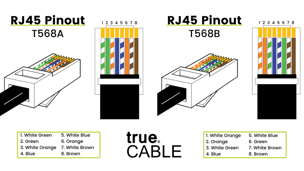

I would check the RJ45 wiring against the below forum post because the Hikvision colour coding is not always standard:
For high bandwidth data applications you should always wire both ends of cables to the ANSI standard TIA-568B so just do a search engine image search for "TIA-568B" and you will see the required pin/colour order.
For technical reasons (I admit I don't fully understand) it is important to keep to that standard otherwise on long lengths or high bandwidth applications you can get errors which may be what is causing your problem.

Correct I am not replacing any connector rather creating a cable with 25 meter length power over ethernet from nvr mentioned above I have just done parallel connection didn't follow any coding standard. I did continuity check all 8 wires are connected sequentially. Same connection in 1 feet cable works but not in 25 meter. Do you think it can be nvr power issue over long length?
No, it won't be a length issue. PoE/Data can travel a maximum of 100m over a single length of cable.
I would follow @codlord advice and double check your terminations are TIA-568B standard like the below example diagram:
If you still have issues you may have to try terminating a new length of cable or using a pre-terminated branded cable instead.
As above, it's important to follow the correct standards because the pins used for transmitting and receiving data MUST use the correct pairs within the Cat 6 cable, which are each twisted together in such a way so that the transmit and receive signals reject any interference and this is what makes transmission over such a long distance possible and is fundamental to the way Ethernet cabling works.
If you re-terminate both ends according to the TIA-568B standard then your cable will work just fine.
Thank you all. Use color code TIA-568B worked fine. So my understanding is length is short colour code may not matter but if length is more colour code matters.Thanks
