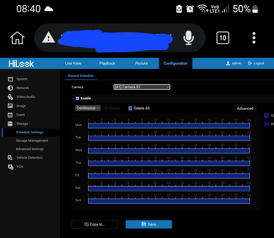

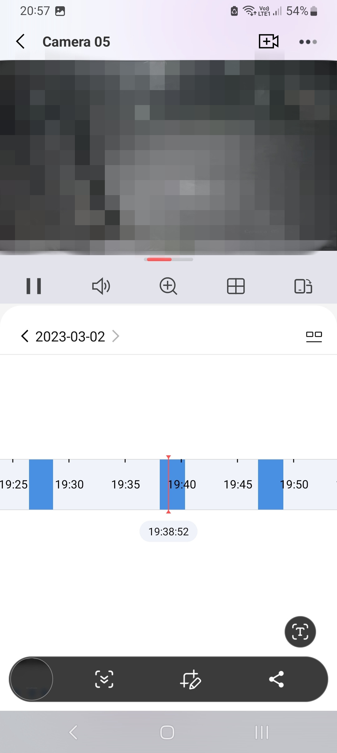

I have a HiLook DVR-116Q-K1 and recently enabled 24/7 continuous recording on Schedule Settings. However instead of a continuous solid blue stripe on time line, the cameras are still only recording based on motion detection events. Literally, the only thing that changed was the colour of vertical lines from red to blue.
I enabled continuous recording because the event-based one was completely unreliable. It commonly skips crucial moments, stops recording even though there's still clear visible motion and sometimes the cameras records a perfectly still scene. Essentially, the cameras record when they want so and are near useless.
What am I missing here? Is there any other option to ensure recording will be actually continuous? I enabled this feature on both web interface and iVMS-4200 in order to be sure the change would be applied, but still nothing. HDD is healthy and I can access the video files just fine, it seems the DVR algorithm/software that is completely useless.

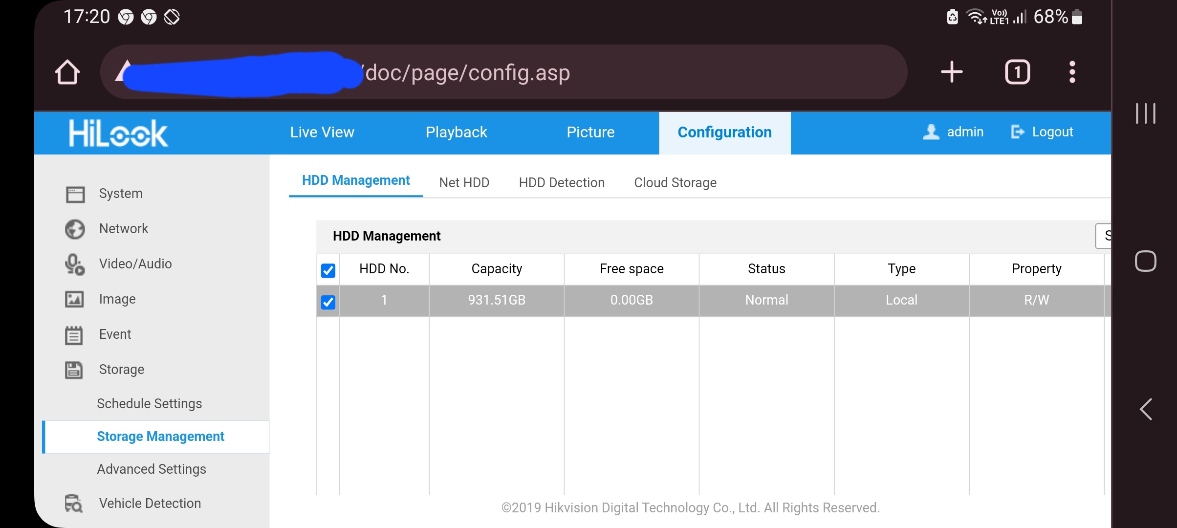

Sure Dan, but what settings specifically shall I share? I don't know if there's another relevant setting besides Record Schedule, but here's an additional screenshot which shows the HDD status:

Have you selected each camera from the dropdown at the top of the record schedule and set each camera to continuous?
If you go to Storage > Advanced Settings > Other do you have 'Enable Overwriting' ticked?

Yes, all cameras schedules are set as depicted in the screenshot, and overwriting is also enabled. I don't see any other setting which could make continuous recording work, I'm so disappointed by this HiLook DVR.
