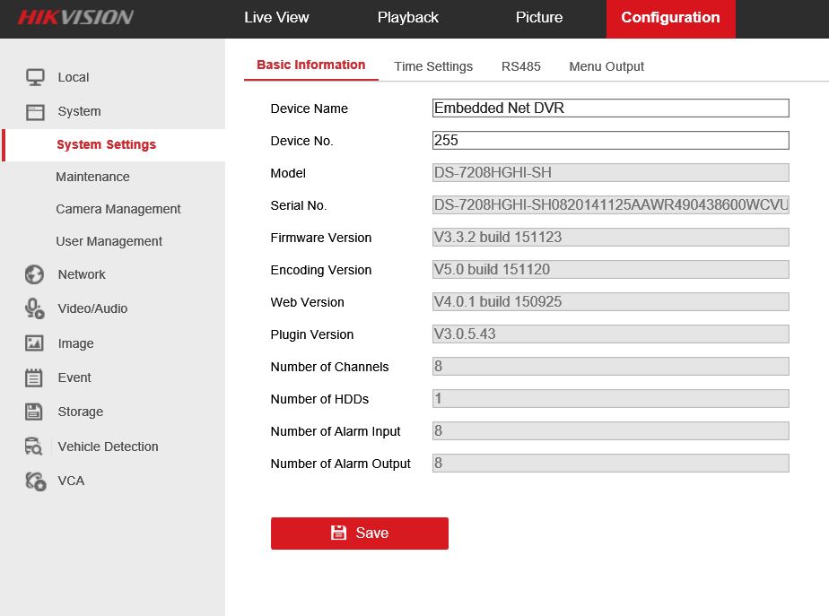

I thought I'd better update my firmware whilst I'm at it. My current one is shown on the attachment. Do you know if I can jump straight to the latest, or if I should update it in stages ? The latest looks like it's 3.4.98 (my current is 3.3.2 build 151123)
Any ideas ? I've attached my current version on a screenshot.

Hi @barnesy1977
We are confused, earlier you said you had a 7608 E-series NVR, but the screenshot above is for an analog 7208HGH DVR. Which do you actually have?
Where did you find the v3.4.98 firmware?
Ah yes, I hadn't spotted that. I based the model on what the quotation was for when I had it installed. On looking at the unit itself, you're right, it's a DS-7208HGHI-SH - which I'm guessing is a lower system than the one I thought it was. So sorry about that - not like me to assume things at all.
Hi @barnesy1977
Are you based in the USA? I was struggling to find firmware or any reference to this old DVR model on the Hikvision UK/EU sites, but when I googled the model I saw references to Hikvision USA and when I searched for the model on the American site I found this discontinued product page. Unfortunately, there is no reference to the latest firmware version, I think maybe due to the age of the model (online I saw references to people using this model as far back as 2015) they may have stopped publishing the firmware online and so you may need to contact your original seller or Hikvision USA support directly to get access to the firmware.
