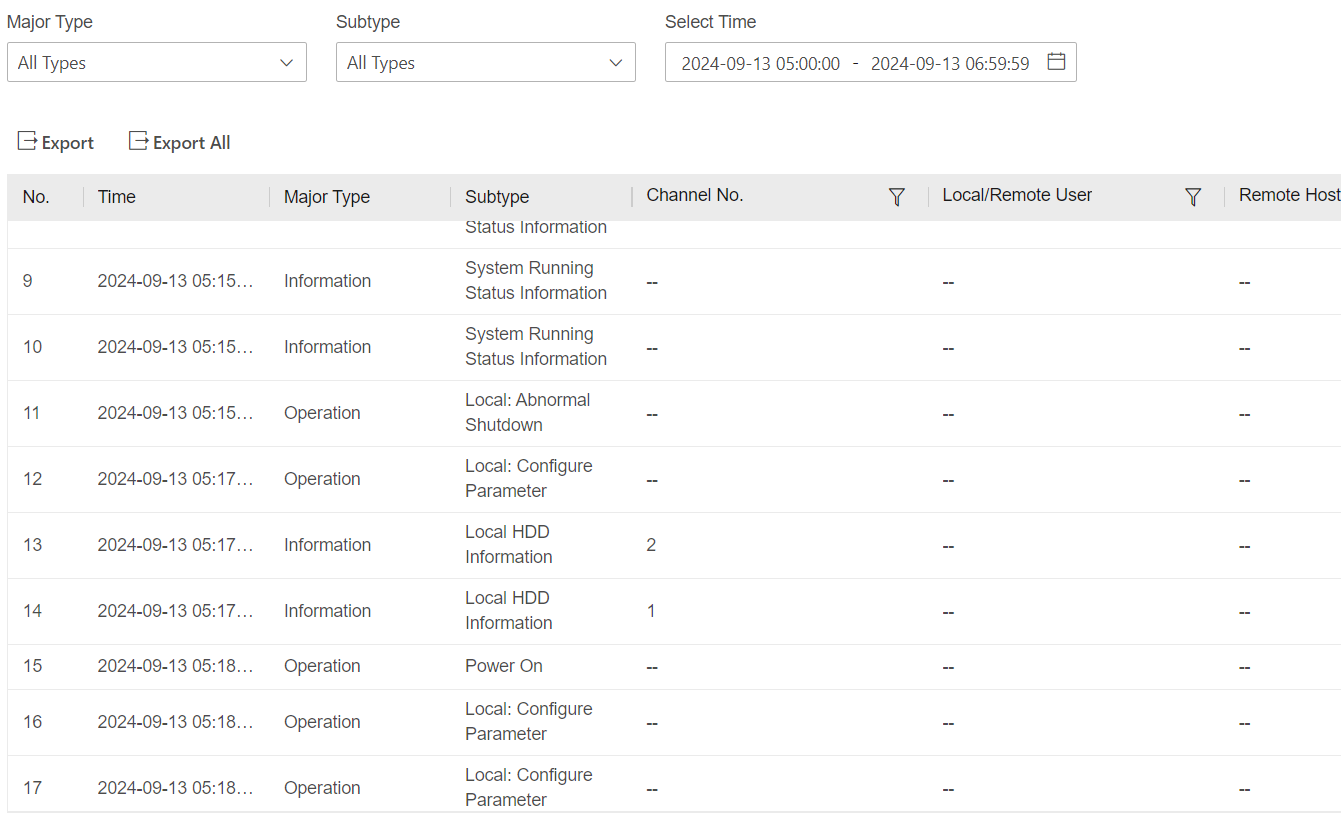

I can see nothing odd before a shutdown message
Check your power supply and try another kettle lead if you can.
Also, try V5.03.020 build 240904, just in case it is a bug on the 0.10 firmware that only affects certain setups / configurations.
Check the firmware on all of your cameras too.
If that doesn't help, we've seen faulty cameras and POE ports cause abnormal shutdowns too, so if possible, try disconnecting your cameras one at a time so determine if one seems to be causing the shutdowns.
FWIW, I was able to simulate those same LOG records by creating a power failure. Thus, as Kyle suggested, I'd attempt to work the problem on that basis.
