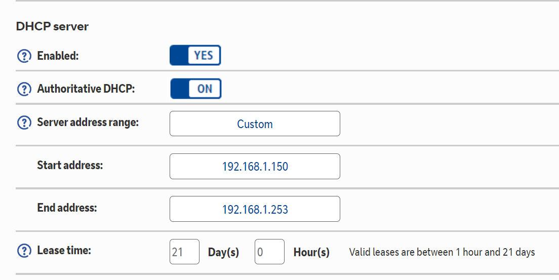

Many thanks for the reply.
I;m a windows user (although I have a mac that I struggle to get on with) I use FING as a network tool - but cant seem to locate what is causing the issue.
My Router is set to allocate DHCP outside a set range as you suggest...
Picture inserted / attached below
As I said the 'IP conflict' is most likely to be another device having the same IP address as the NVR itself (rather than a camera). Forgetting the router, are you sure that the NVR has a static IP address and that it's outside of the DHCP range?
Do you only have the BT Hub? Any other devices such as mesh access points? Another issue that can occur is when someone puts a mesh system in and simply plugs it into the router. You can end up with more than one DHCP server on the network. When that happens it doesn't matter how you have the DHCP set up in the BT Hub, as a device sending out a broadcast DHCP request on the network can receive an offer of a lease from the other DHCP server first and cause that conflict.
