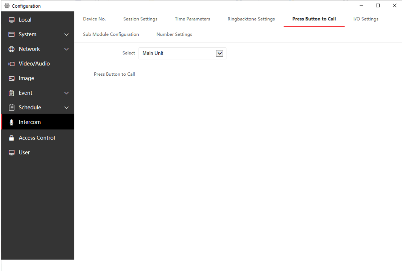

Hi , i have two ds-kd8003 with DS-KD-KK and DS-KD-KP , but in one of the two i can' see main unit and also second unit configurable why ? i have update the last firmware on all module and check DIP switch if correct . Thanks best regards

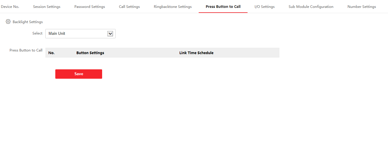

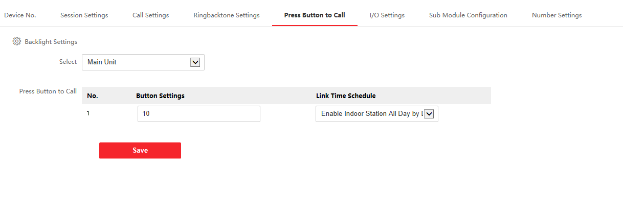

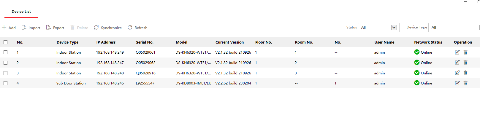

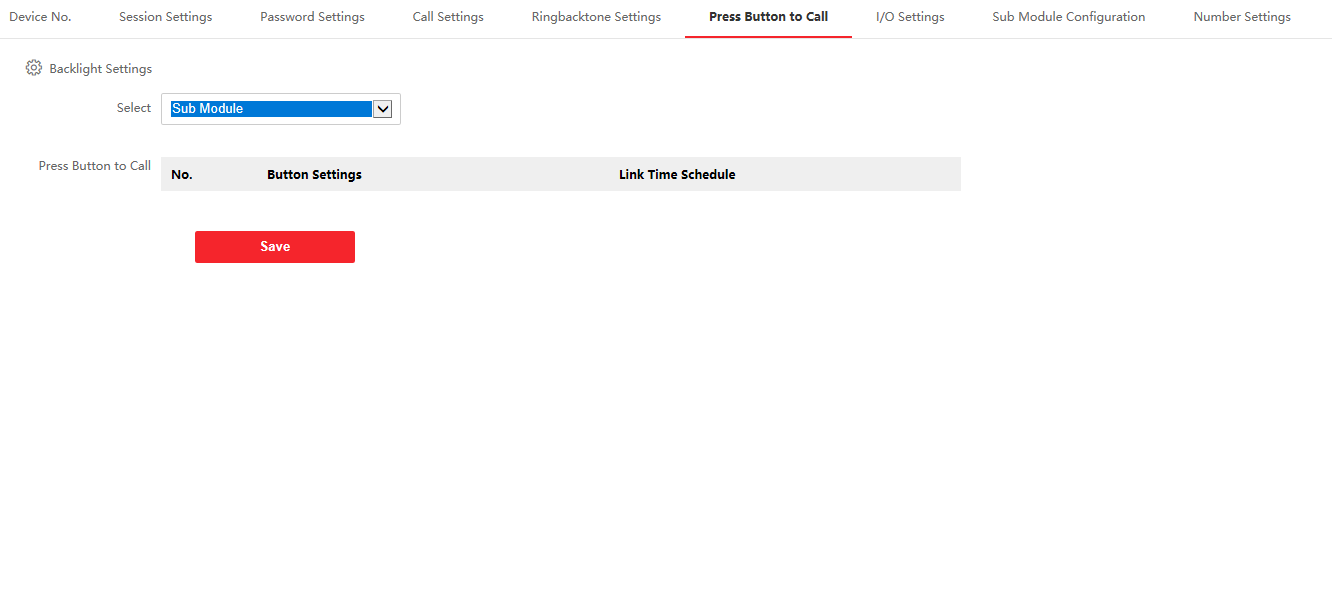

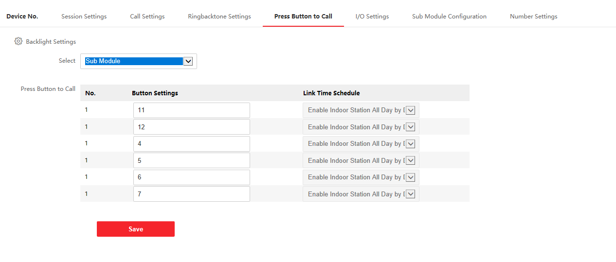

I will try to explain better, i have the first KD8003 configured as Main door Station , the second KD8003 configured as sub door Station , other information in my network i have also 3 indoor station DS-KH6320 that are configured always that following main door station ip , so i can configure only in the sub door "Button Settings" in press button to call in the Main Door i can't. Attach the screenshot .
The firmware are the same V2.2.62 build 230204 . Also sub module have same firmware Nametag Module and Keypad module V1.0.0 build 191213. I am using last version of client software Ivms 4200. The problem can be that with this configuration the form of configuration can't be modify?
