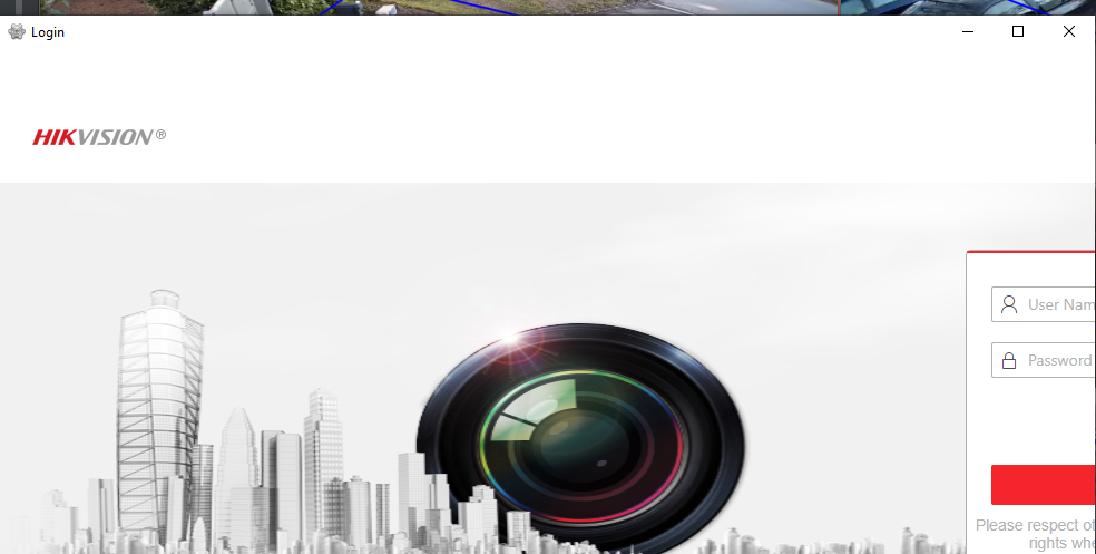

2) For some reason now when i try Remote Config/Basic Settings. From IVMS4200 - IT spawns a remote window but shows the login console. When i try remote password it doesnt allow me in, with an error top left (incorrect username/password) If i go direct to the cam interface via a browser i login fine (its a cam not connected to the internal DVR network).

The pop up window for login you’re getting is the cameras webpage menu (though it looks the same as the NVR) You must have a different admin password set for the cameras themselves.
The easiest way to find the camera password (and also check the firmwares match) is to bring up the NVR menu on a monitor connected to the HDMI output. Click the camera menu on the top bar, click the icon in the top right to switch from thumbnail view to list. Scroll to the right and you’ll be able to see the full model number and firmware build of your cameras (you may need to stretch the columns as it’ll be truncated). While in that same page you can find the camera passwords. They’re hidden by default but there’s a button at the top of the page to reveal them. When you click it you’ll be prompted for your NVR admin password. Once entered the passwords will be unmasked.
