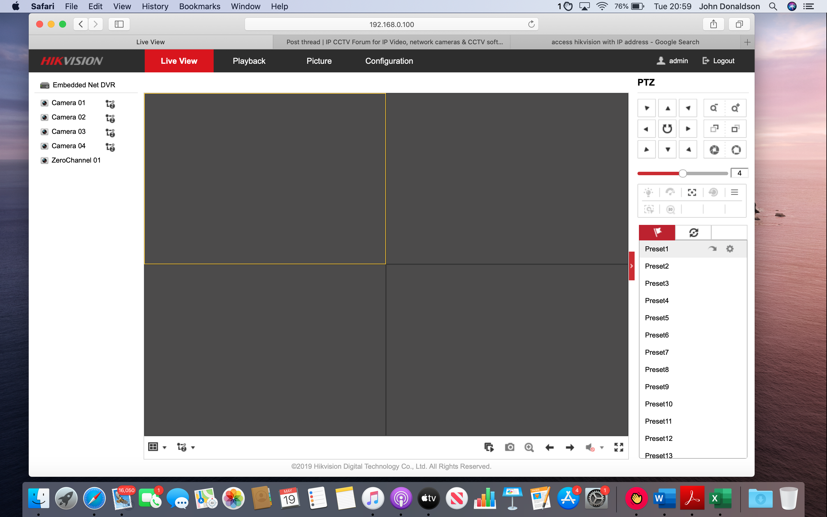

2) I can access my system on my laptop via the IP address and can view/amend/change all the settings - the one problem is I can't see any footage (live or prerecorded). The four boxes are all blank. The names of my 4 cameras are showing on the left hand of the screen and are selected, but I can't see any footage (see attached pic). Is there a setting I need to initiate?

2) No, there is no encryption key error - the camera are all listed correctly, there is just no picture from any of them on my laptop screen (via IP) - the camera work fine on Hik Connect app and on the TV connected directly to the DVR.

If I could just get my cameras playing on my laptop (through IP address) I would be sorted. The installer said viewing camera through the IP address does not work (which I think is just wrong) - he suggested downloading HikConnect onto my laptop - I didn't think this was possible?
When you enter your DVR IP adress can you log into camera? You are using Internet Explorer ( must use it )? When you log onto DVR you will need to install add-on for DVR.
It is utter bull*** that you cant watch trought IP adress.
And you need IVMS 4200 for that, not hik-connect.
What happens when you single click or double click on one of those cameras in the list? Or on one of the boxes to the right?
At the bottom of the live view you have this play button ( first from the left). Click that and see what happens.
Thanks everyone- really appreciate the advice. KamirZG got it- my laptops were running Chrome- have tried using Internet Explorer and it is working perfectly!! Interestingly the live view on the laptop is a good bit smoother than live view on my mobile, even though both are working off wifi in the house.
