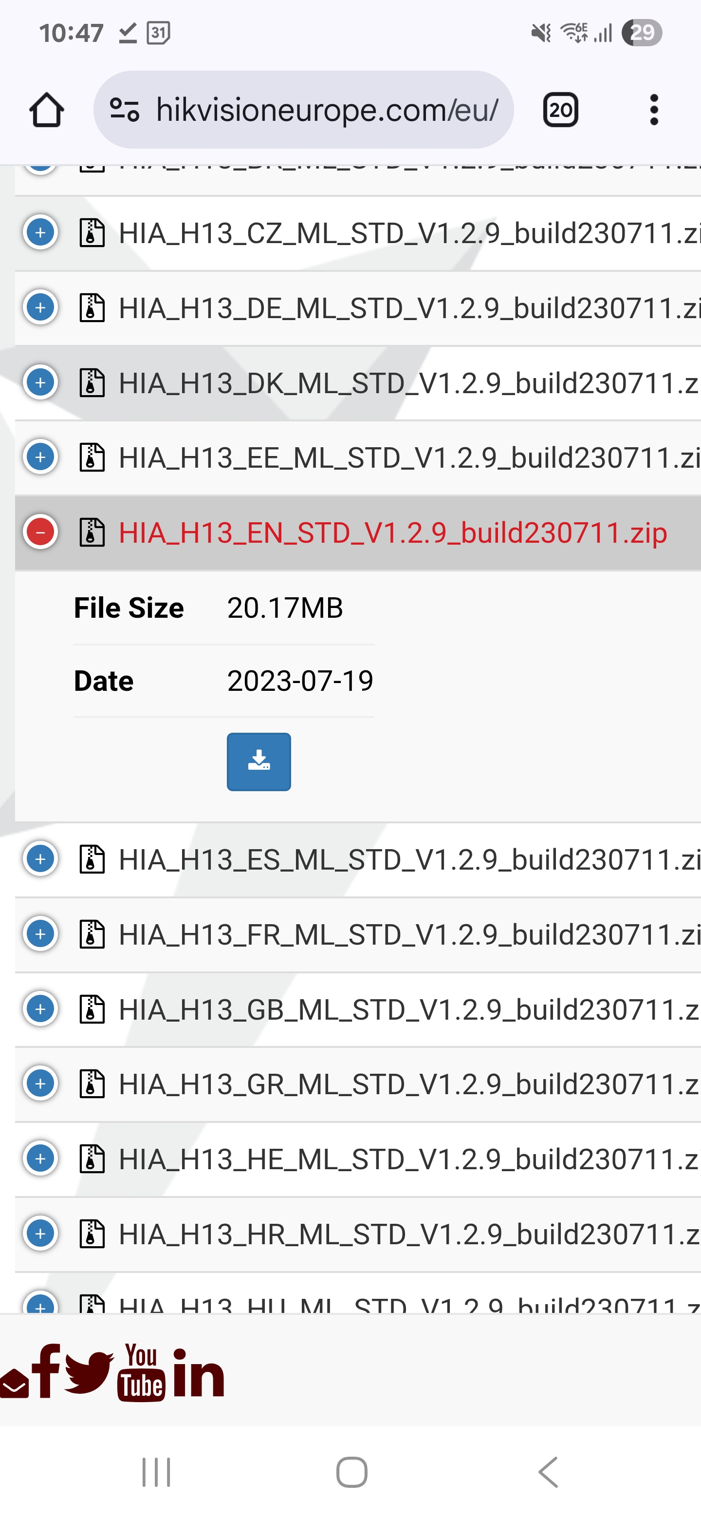

After contacting customet support I was asked to update the main panel to latest v1.3 build (250318), but I'm still having the same issues. What I have noticed.
