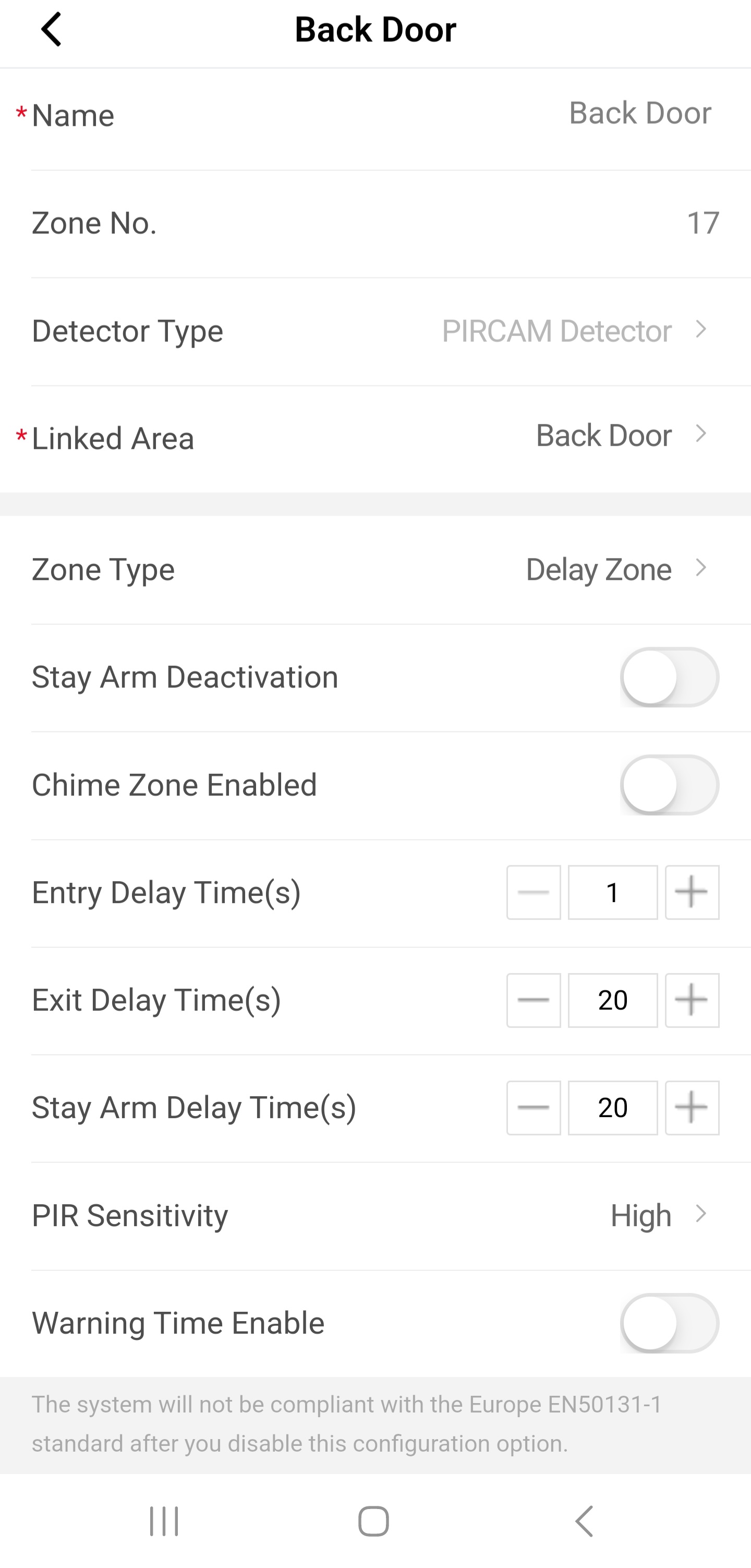

I've tried running the PIR Camera on delay, with a 1 sec entry delay and silent alarm (see setup below).
It's logging the photo which is great. But still also looks a fault that you need to clear (prob similar issues if camera was set as instant).
As you initially disarm, it's easy to forget having to disarm twice to remove the fault. You then remember when you try and set it ain the alarm code.
