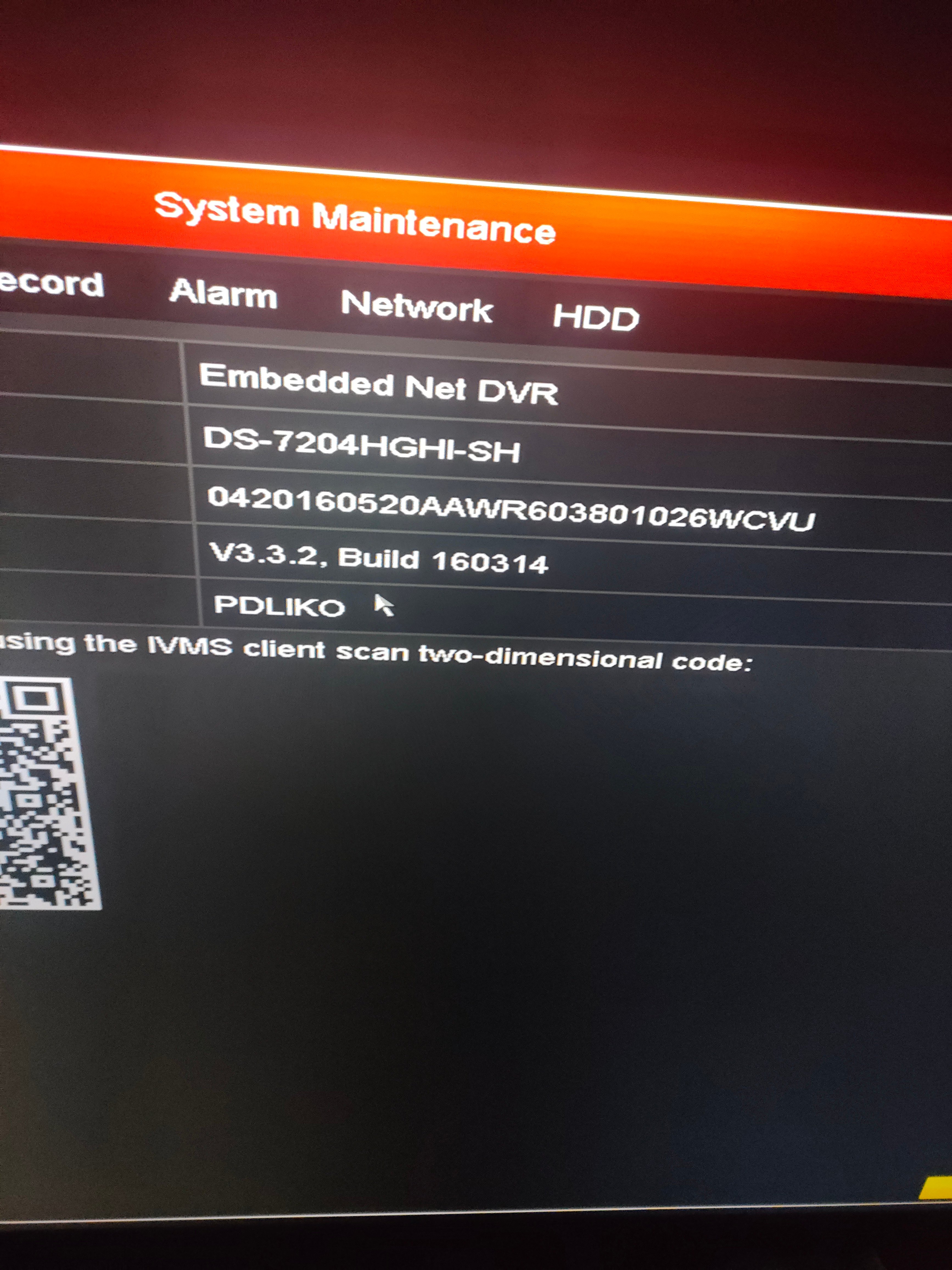

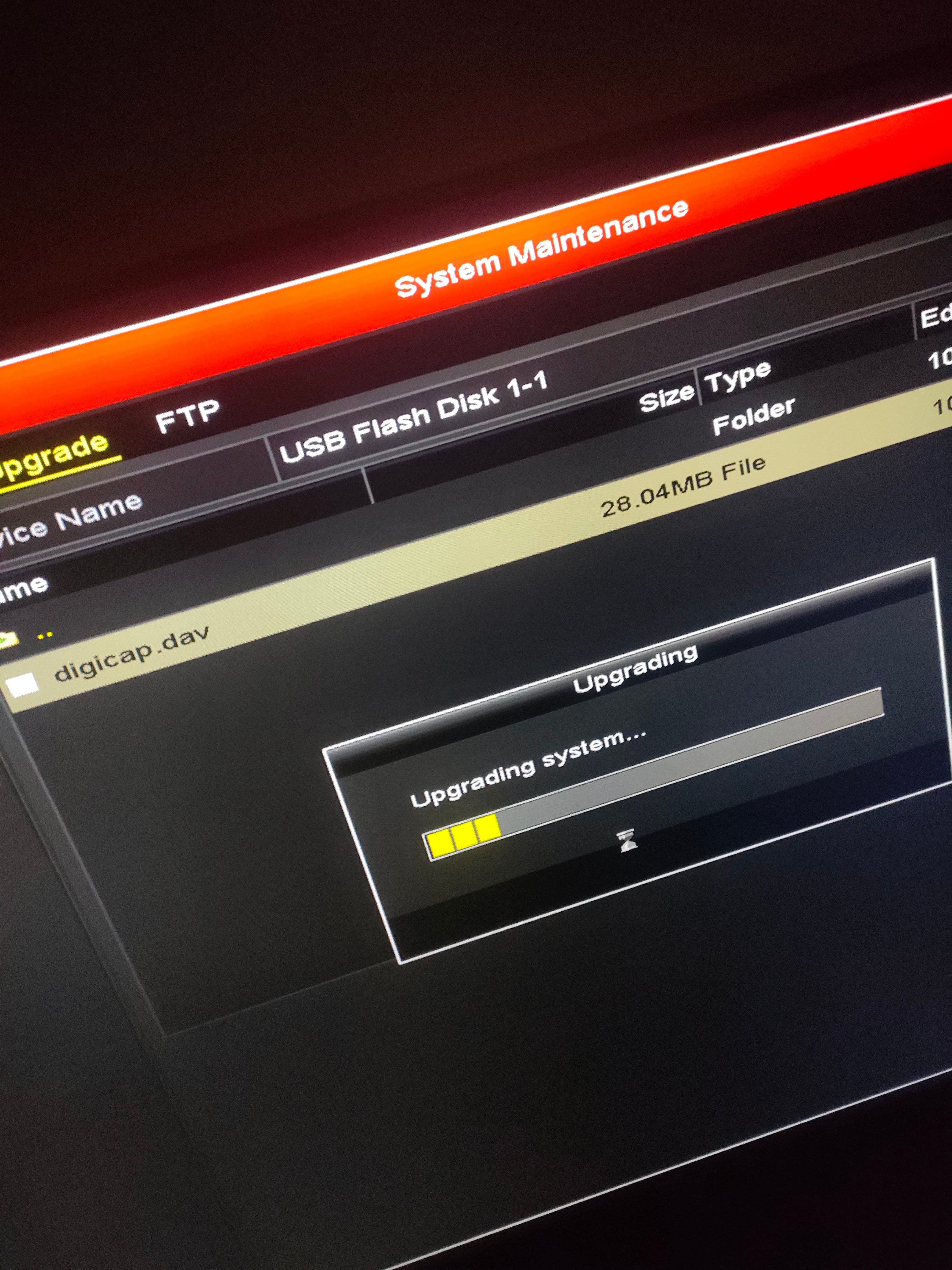

Is there any upgrade to my firmware which I'm currently using
Model : DS-7204HGHI-SG
Firmware version : v3.3.2 Build 160314
I have attached a picture of it helps

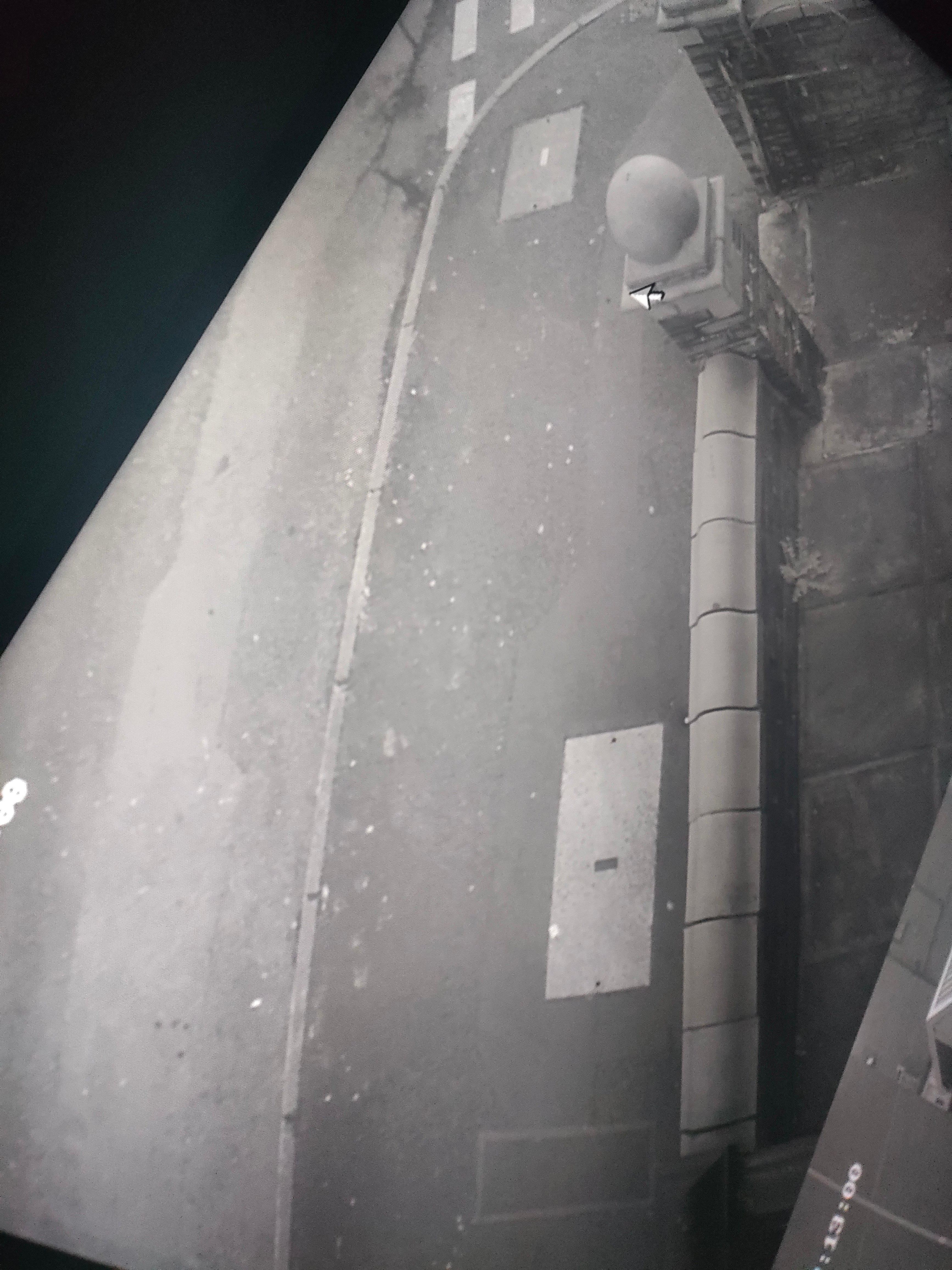

And also ever since I have used it it is black and white ..I could never get the colour picture on I don't know what is wrong
Thanks for reading

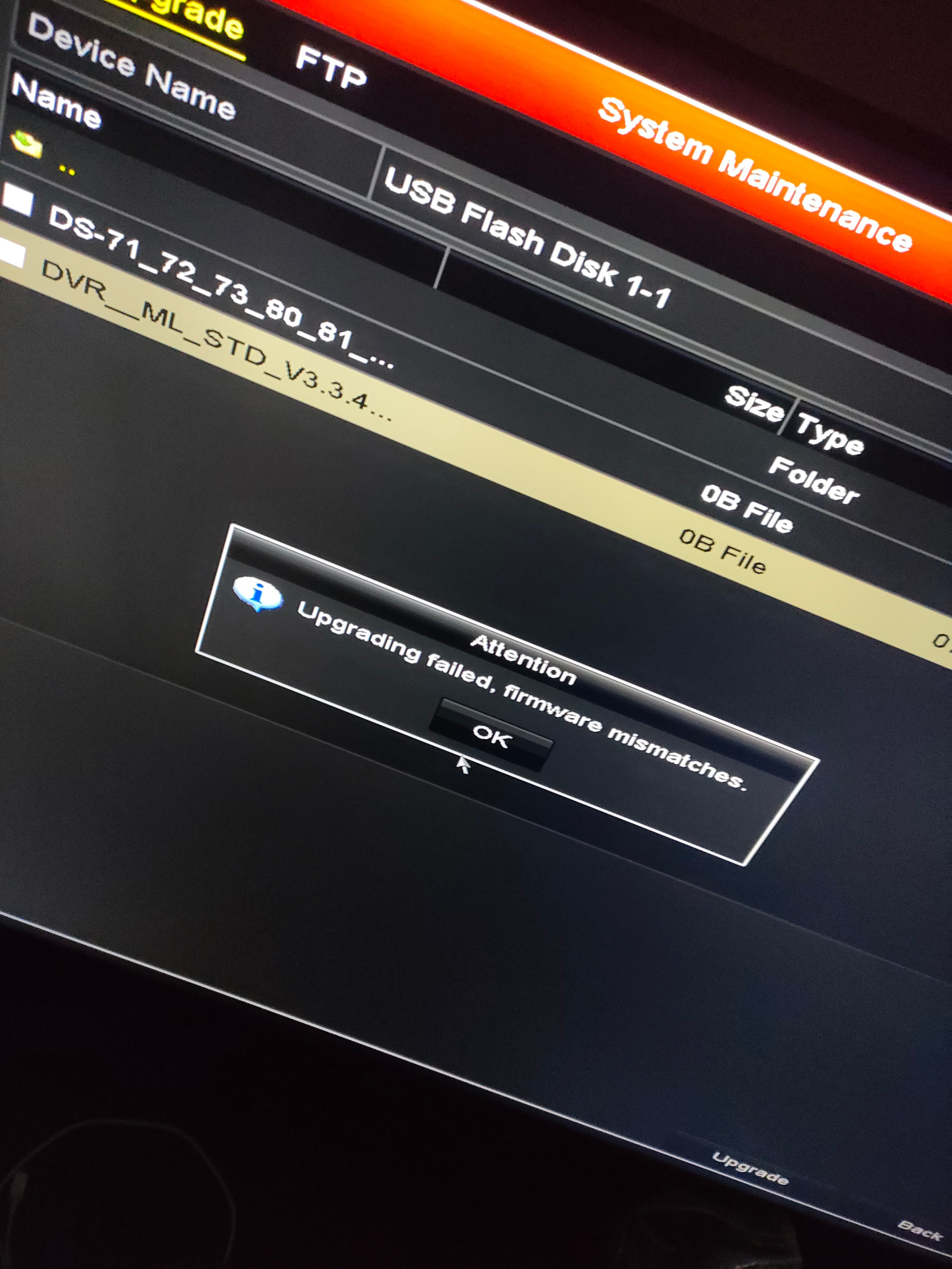

Hi
I've tried it and says upgrade failed, firmware mismatches
I've tried different versions on that link you sent me each one says same message

Hi @kammy
Are you unzipping the firmware files before trying to load them on the NVR?
When you unzip the file download from the portal you should get a digicap.dav firmware file.

Hi Dan
I'm so embarrassed can't believe I wasn't unzipping the files, school boy error from me
I managed to update to the latest firmware
Picture still showing black and white but atleast I have the latest firmware
Thank you so so much

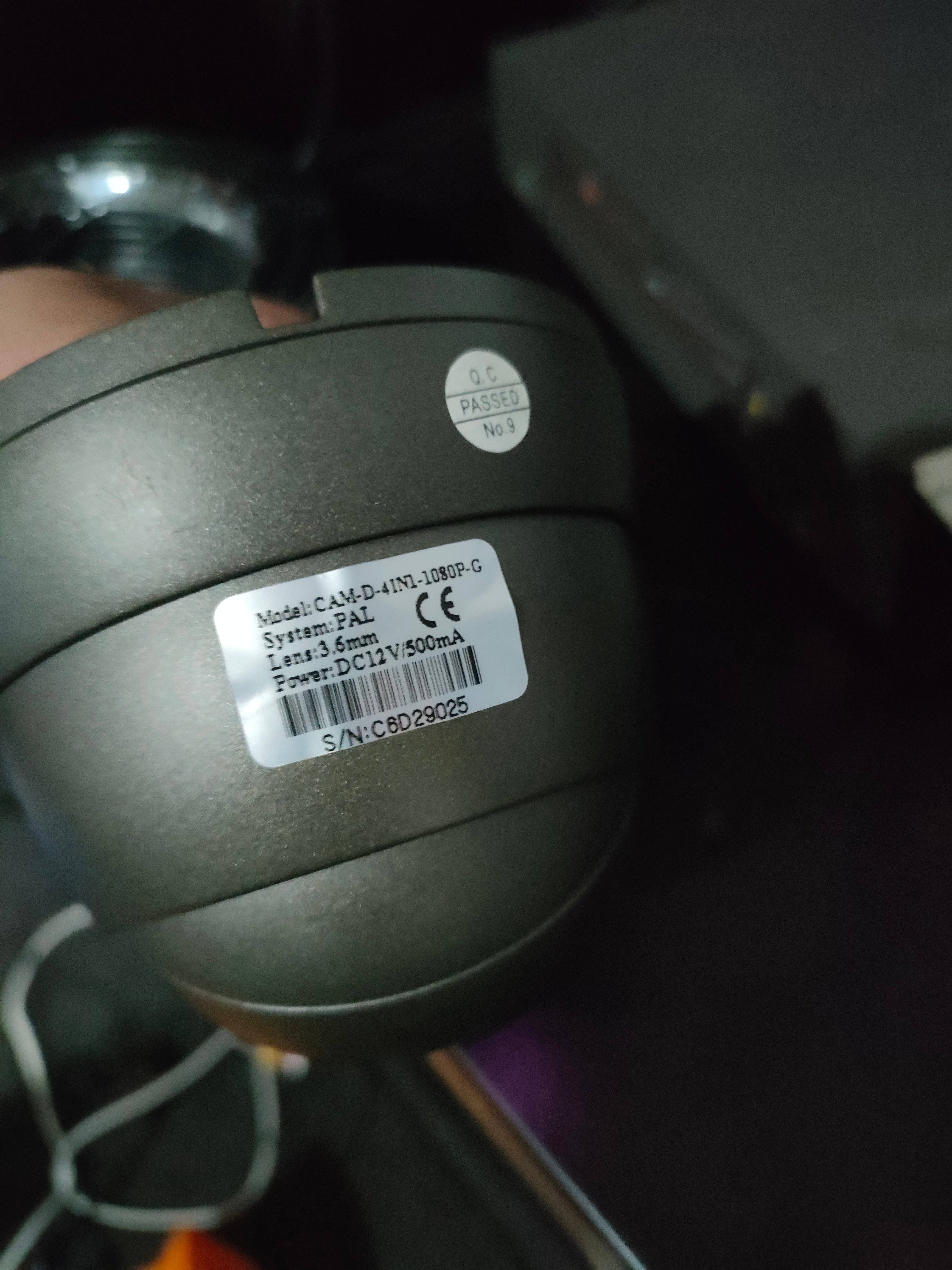

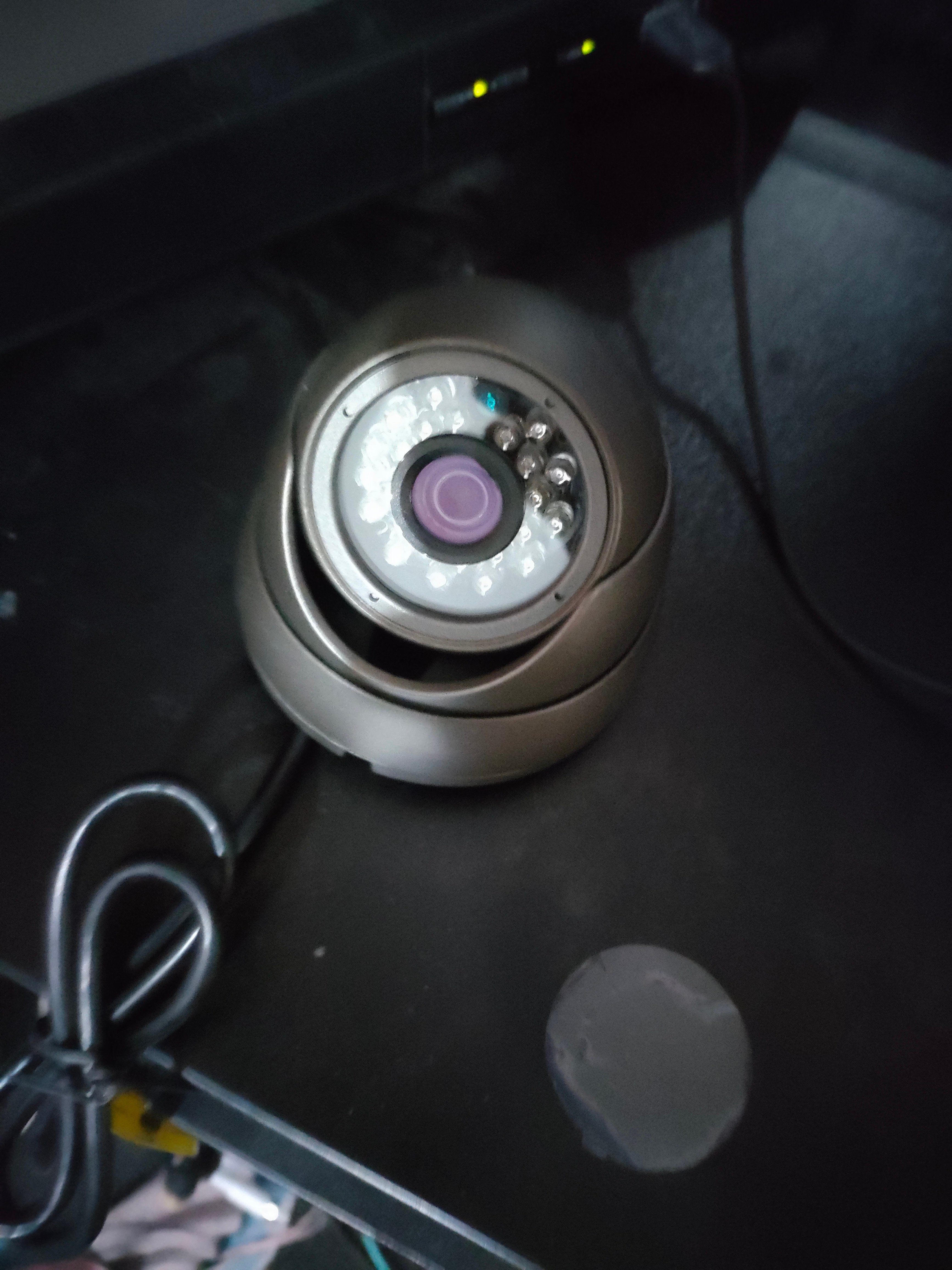

Hi @kammy
Good to hear the firmware has worked.

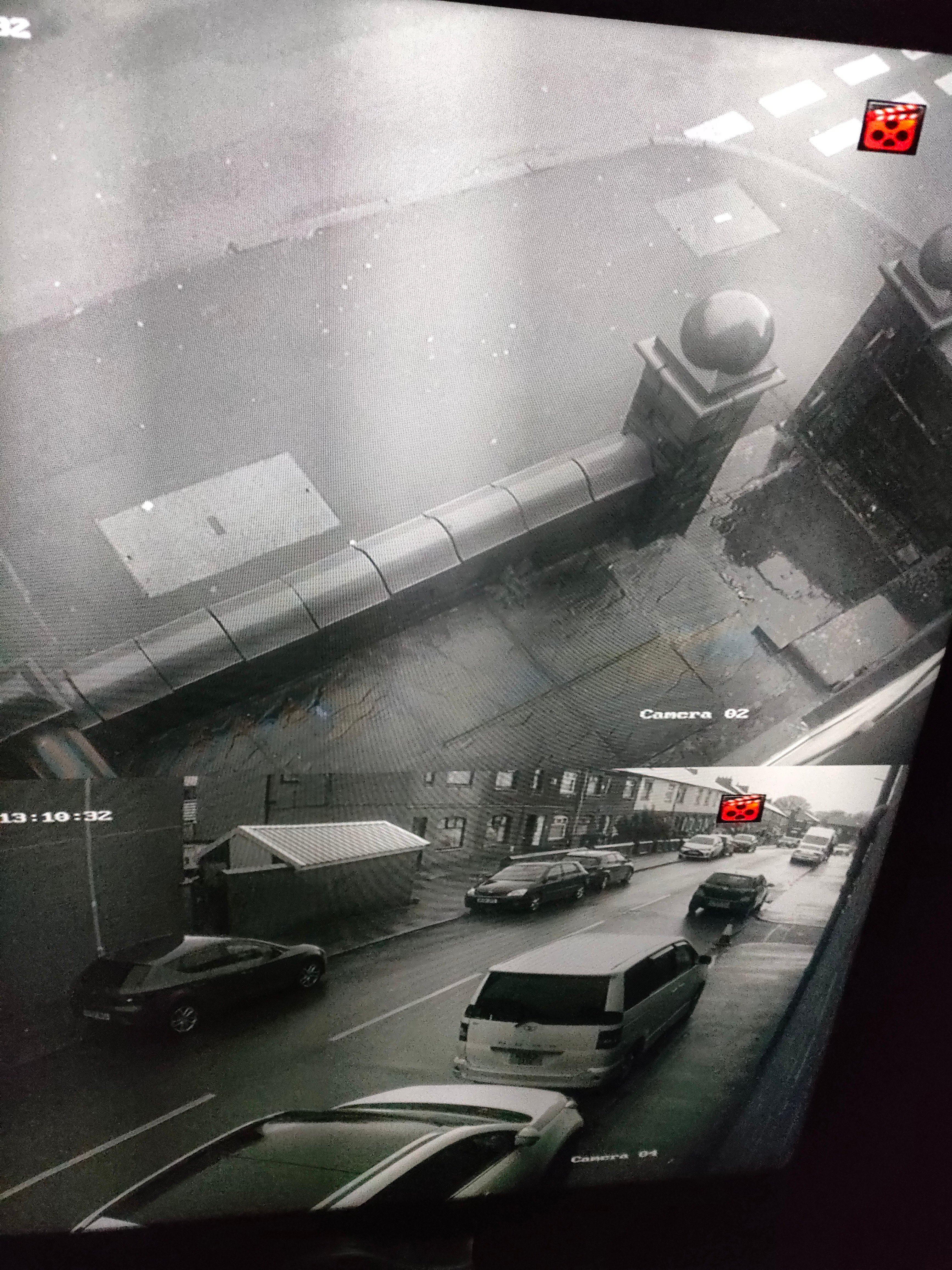

Can you please confirm the model number of the B&W camera?

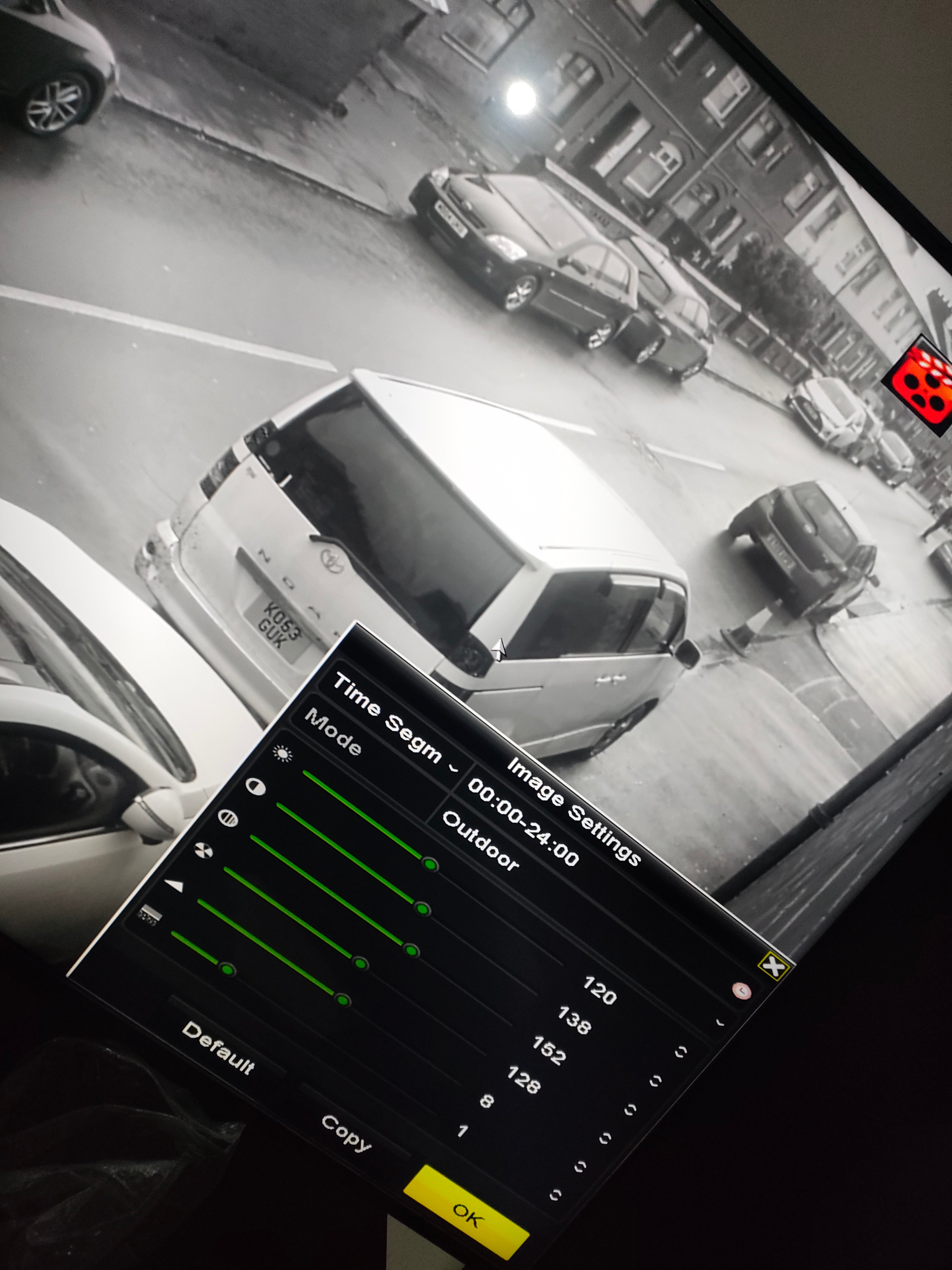

Can you share screenshots from the DVR menus of the video/image settings for the B&W camera?

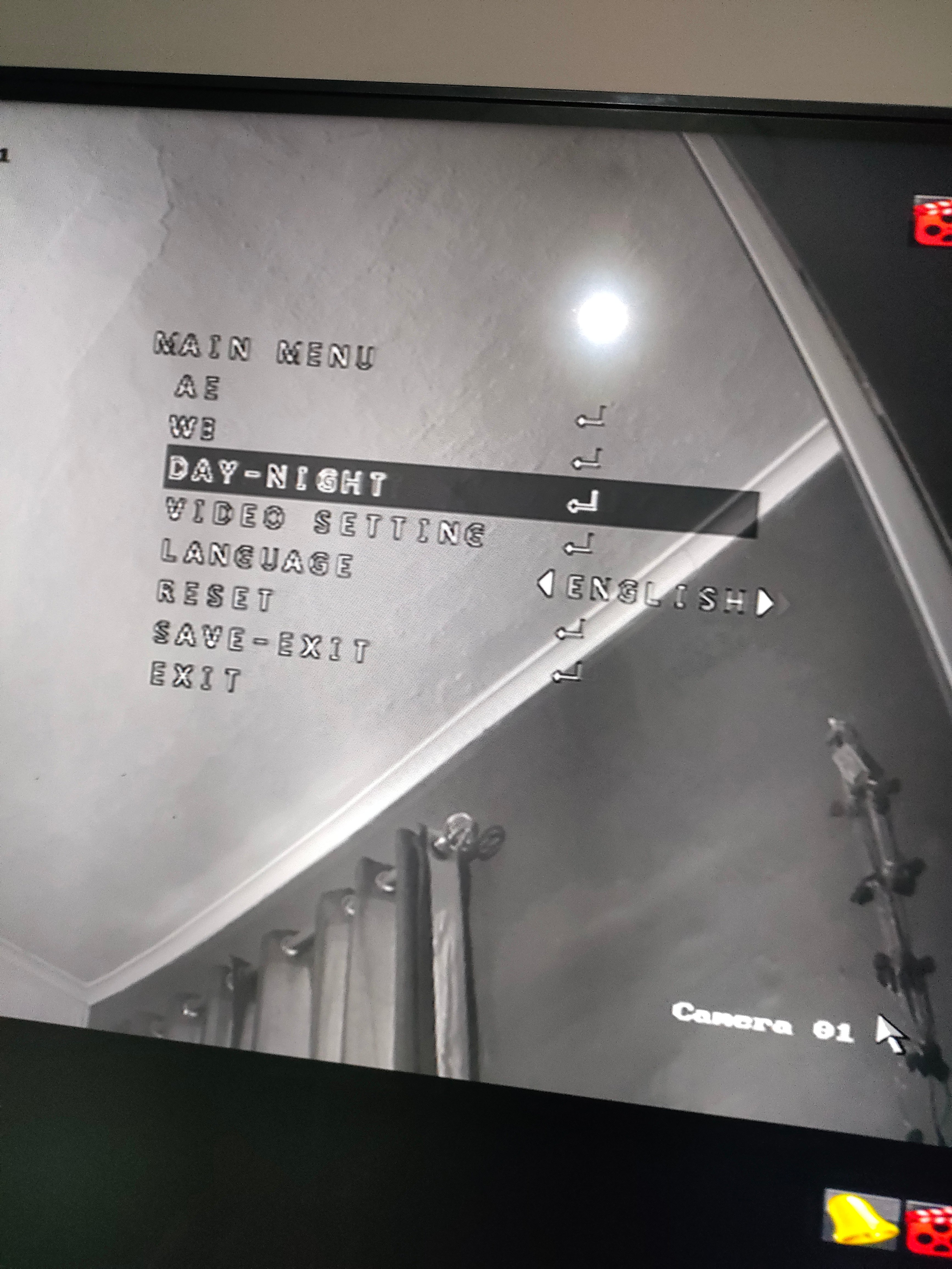

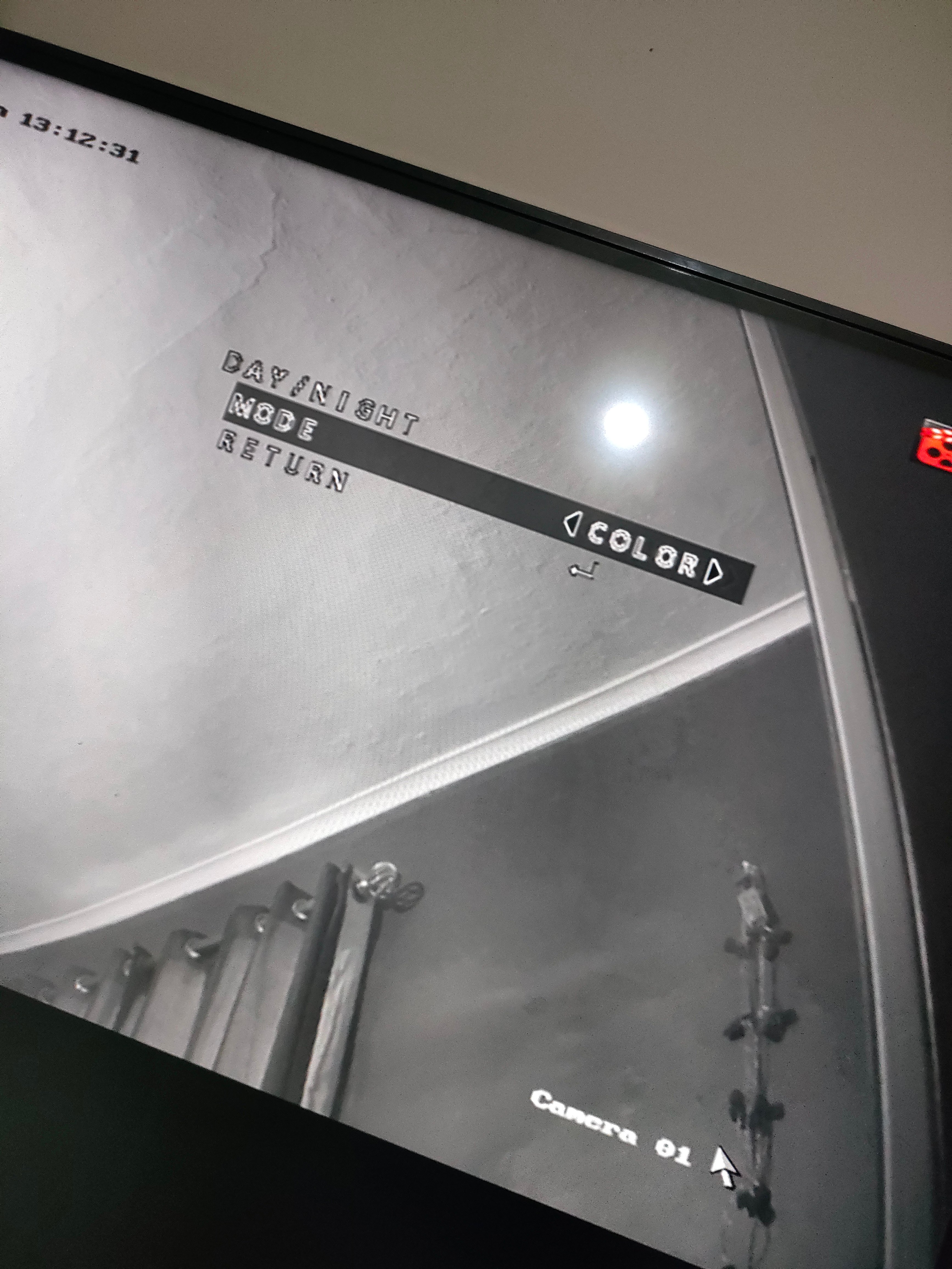

Hi I've sent you photos of the cameras..including camera 1 I've just connected with the switch..when I press the switch/control the menu comes up as shown in the image provided...

Thanks @kammy
Under that 'Day/Night Mode' setting, what options does it give you? Is there an 'AUTO' option and have you tried it?
Thanks @kammy
Hi
Yes there is an auto option, I've tried it and I can here the camera click when it thinks it's dark and the red led lights come on and when I put the camera near the window clicks against with the red lights go off but both times still black and white

Just a quick update

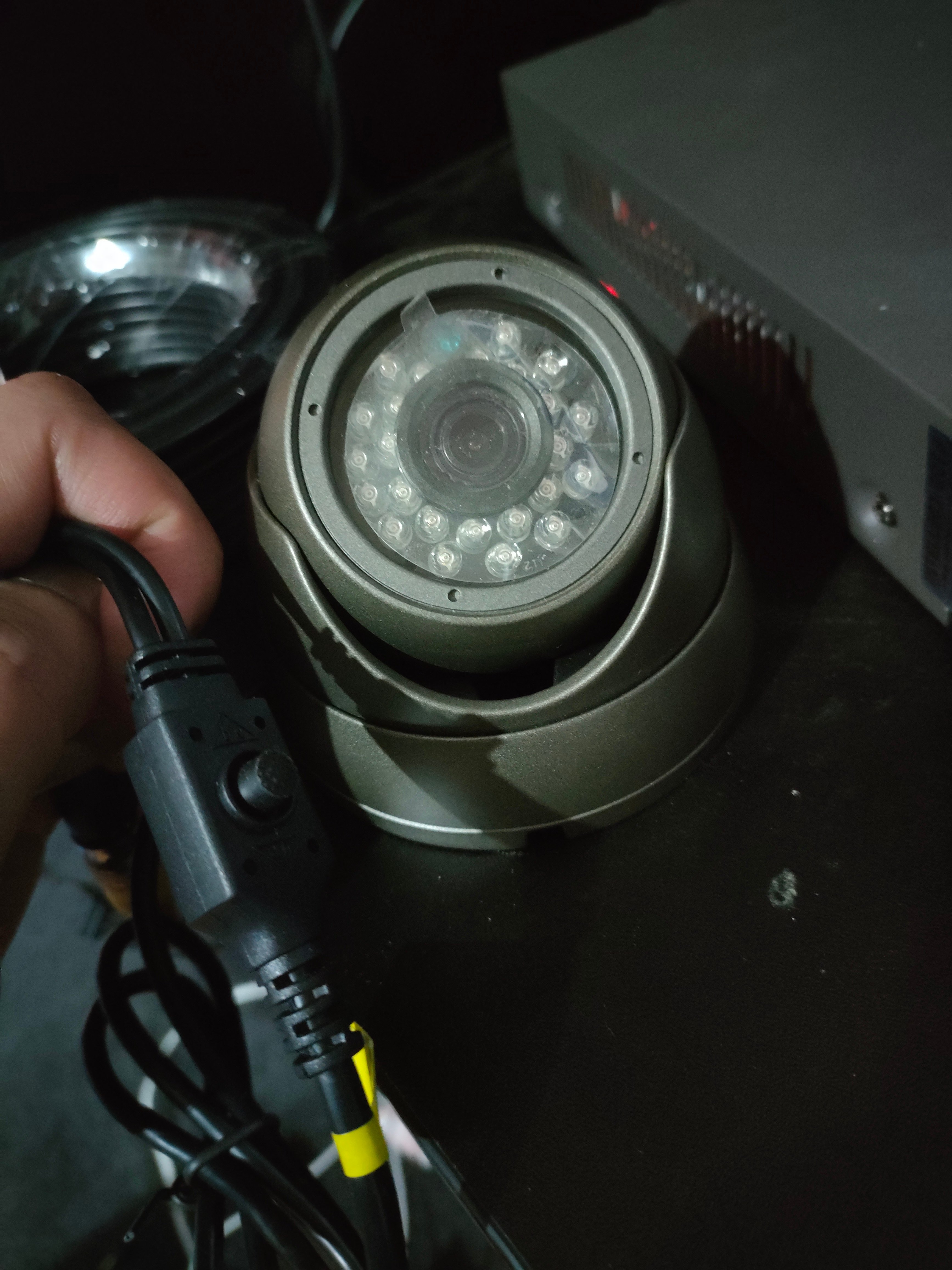

I didn't hear from you for few days but since then after long two days of meddling managed to get my colour back on through the camera I unpacked
I found a manual or a instructions paper and followed some instructions.
It worked when I pressed the OSD button up or down for 5 seconds now I will try to find out which from AHD or CVI is best
I also managed to link the cameras to my smartphone through the hik connect app.
I didn't give up but Hard work pays off
