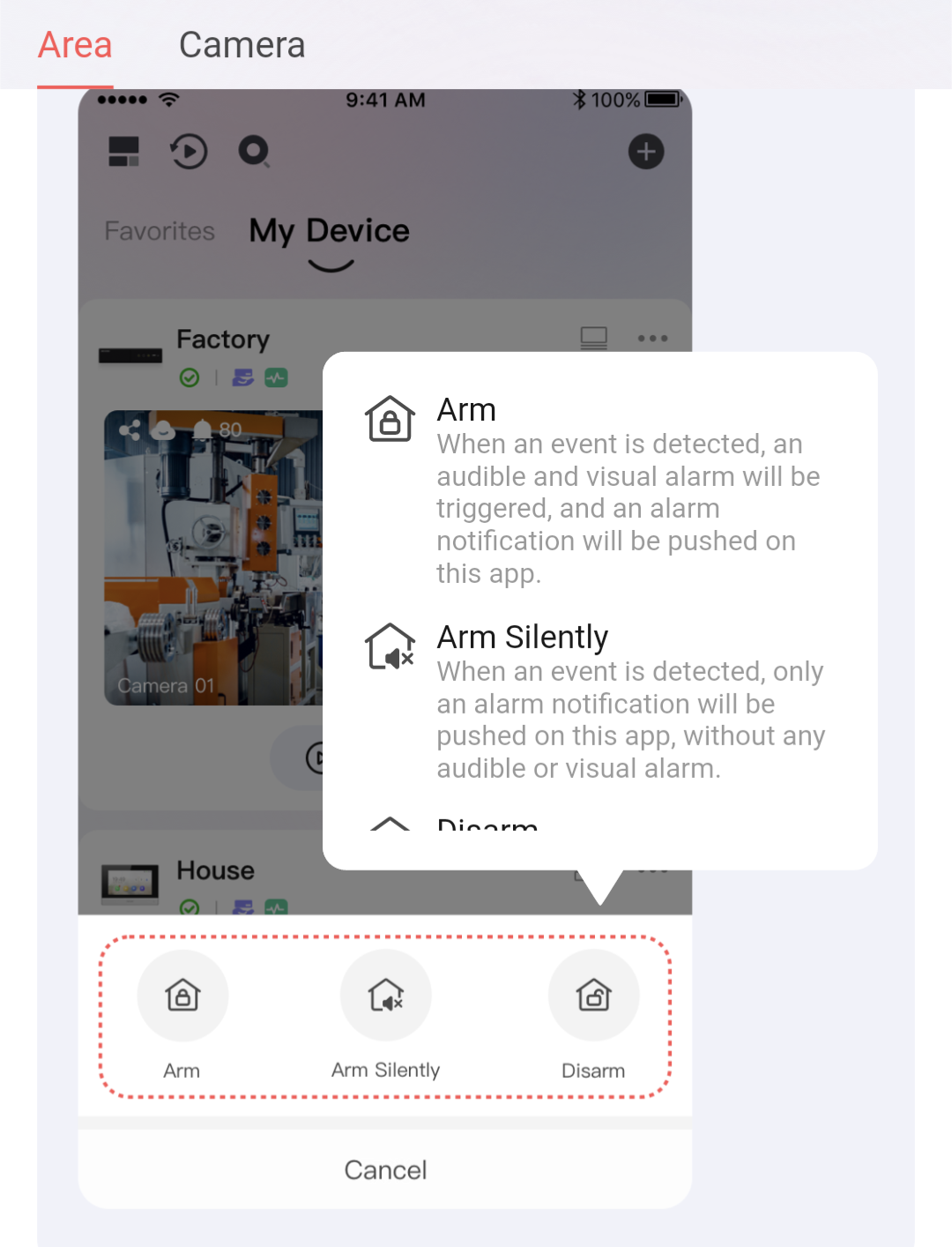

Okay - from the description in the app it suggests an alarm notification should be pushed to the app (as below).
Yes that is what never worked. However I’ve not seen that description previously and it is some time since I tested each mode (I gave up in the end and Hikvision confirmed to me that it wasn’t working). I’ll check on mine today to see if it is/isn’t working as it should. Mine is an M series NVR but it was never that clear whether it was NVR firmware or Hik-Connect itself at fault.
I've just checked it again and it definitely isn't resolved on the latest M series NVR firmware combined with the latest version of Hik-Connect for iOS. It's important as to how you define 'push notifications'. The push notification is the banner and audible alert that appears on the device Home Screen regardless of whether the app is open or not (rather than the notification within the app)

Referring back to my original post - when my app is set to 'Arm Silently' I do not get audible push notifications and event clips are not available.
The only way I could find events is by going to 'playback' and looking for colours in the timeline.
I'm currently away but will check double check this later in the week.
Had the app set to Arm Silently over a couple of days and can confirm no push notifications or event clips in the app.
