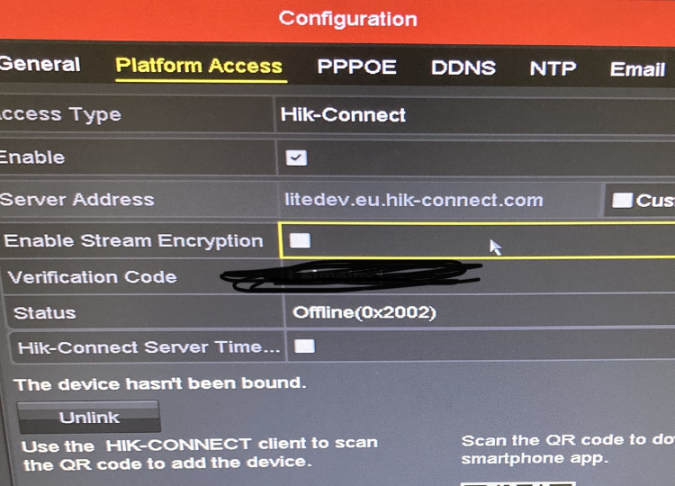

wondering if anyone can help me : my Hik Connect app is showing all 4 cameras as Offline 24 hours now. Had no issues since installation over 12 months ago up to this point. Both myself and housemate logged on to live view at same time yesterday as house alarm was activated. Hasn’t worked since. Any ideas ? Greatly appreciated as not very tech savvy thanks
See platform access screen attached

Hi klimkke,
Can you provide the hik-connect platform configuration it may be the Server address was not set correctly
