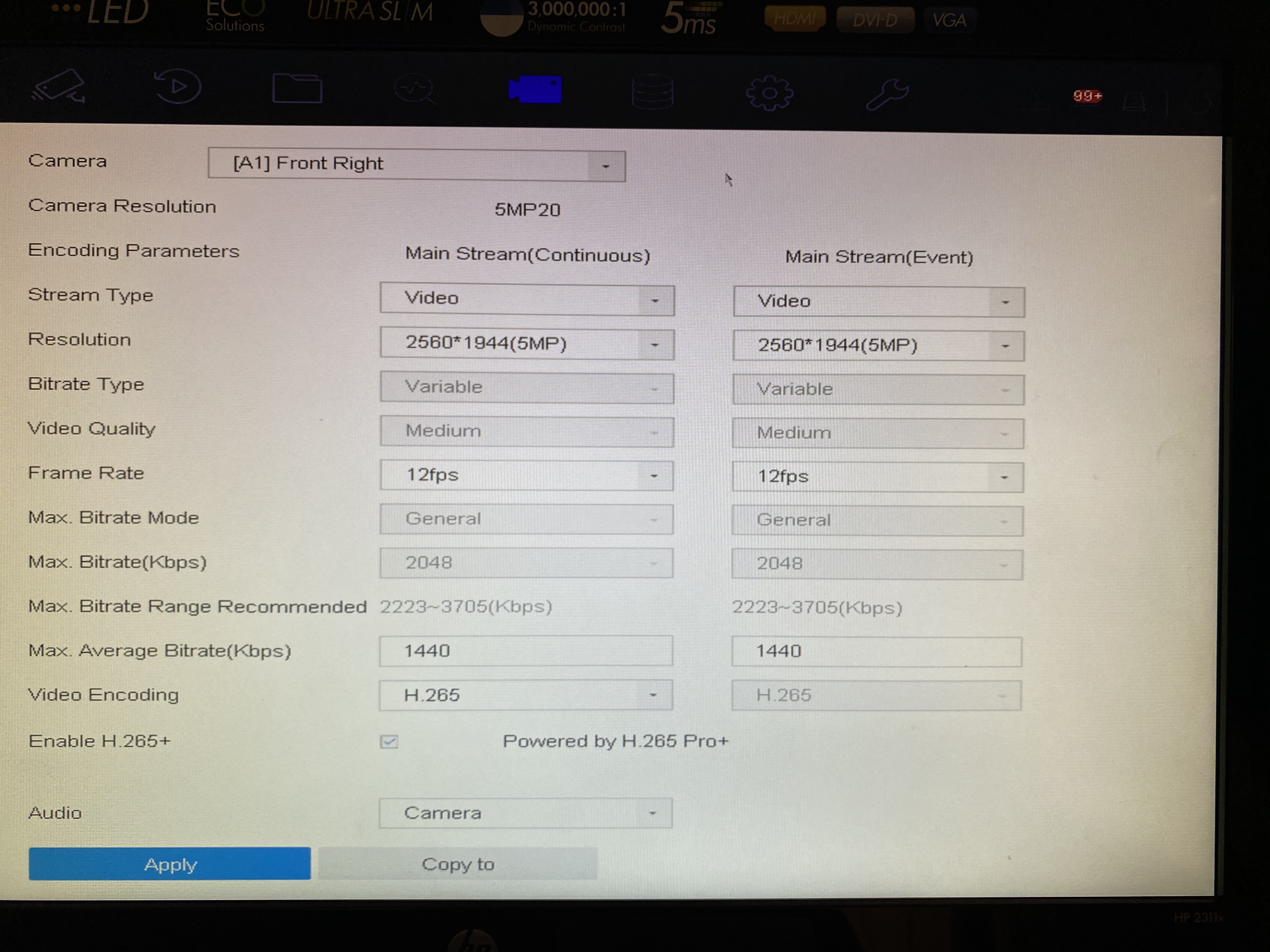

Can someone give some advice as to how I fix an issue with my hik-connect playback? Any motion detection alerts get stored in the event tab. When playing back some can range from 30 seconds to two minutes. When watching the footage it appears that it records prior to and after the motion detection but at the point of motion detection on the playback it freezes sometimes for a period of up to 20 seconds and jumps the frame. I’ve not been able to get back to the exact point the video is lost. Only happens on the hik-connect app playback, not on playback on the DVR.

I have also attached the settings my camera on it
There is a lot of wizardry happening in the background when you use HEVC (H265) encoding. More so when you use H265+. Multiple frames are referenced for encoding and this can create playback anomalies when reassembling the timeline with many software based apps. The DVR/NVR has the hardware capability to accomplish this with smooth playback but may struggle delivering footage based off the timeline if the app is not properly setup.

Knowing your DVR and camera models will help narrow the issue down. I suspect the issue lies with the H265+ codec you are using.
